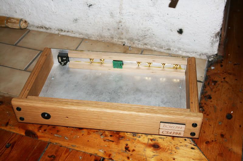

I´ll try to describe it in short words.
CS4398 Rock n´roll PCM1794 HiFi.
CS 4398 is, at the moment more fun to listen to,I wish I could use both in my case with it´s own RCA output..
I´ll listen some more...
Edit:Anyone else that have some listening impressions between the two?

that goes through the fuse .......see the ground symbol the yellow wire in middle the of the plug ,that is the bonding to the chassis or pan you are using the other two lugs with wires say on them 10A at 250 don't TOUCH them when it's plugged in or let them touch anything those will shock you,do yourself a favor and cover them with black electrical tape,GOOD Luck,,,,you may have to set some jumpers then it will work!!!!!
The L on the back of this thing, is the line inlet ground? And i Just put a metal screw into the chassis with a covered wire leading to this L and I should be okay?
NO!
That is the LIVE AC input that goes to the fuse terminal. If you connect that to the chassis ground you will be in for a world of hurt.
The AC ground is the bottom green/yellow wire.
(edit: noSmoking beat me to it)
I'm going to use a picture here so I maybe get a chance to listen to this dac lol.
The short answer to your question is NO, emphatically NO.
If you really don't know how to connect to a power inlet socket, either get some professional help or take up a safer hobby like juggling with loaded firearms.
