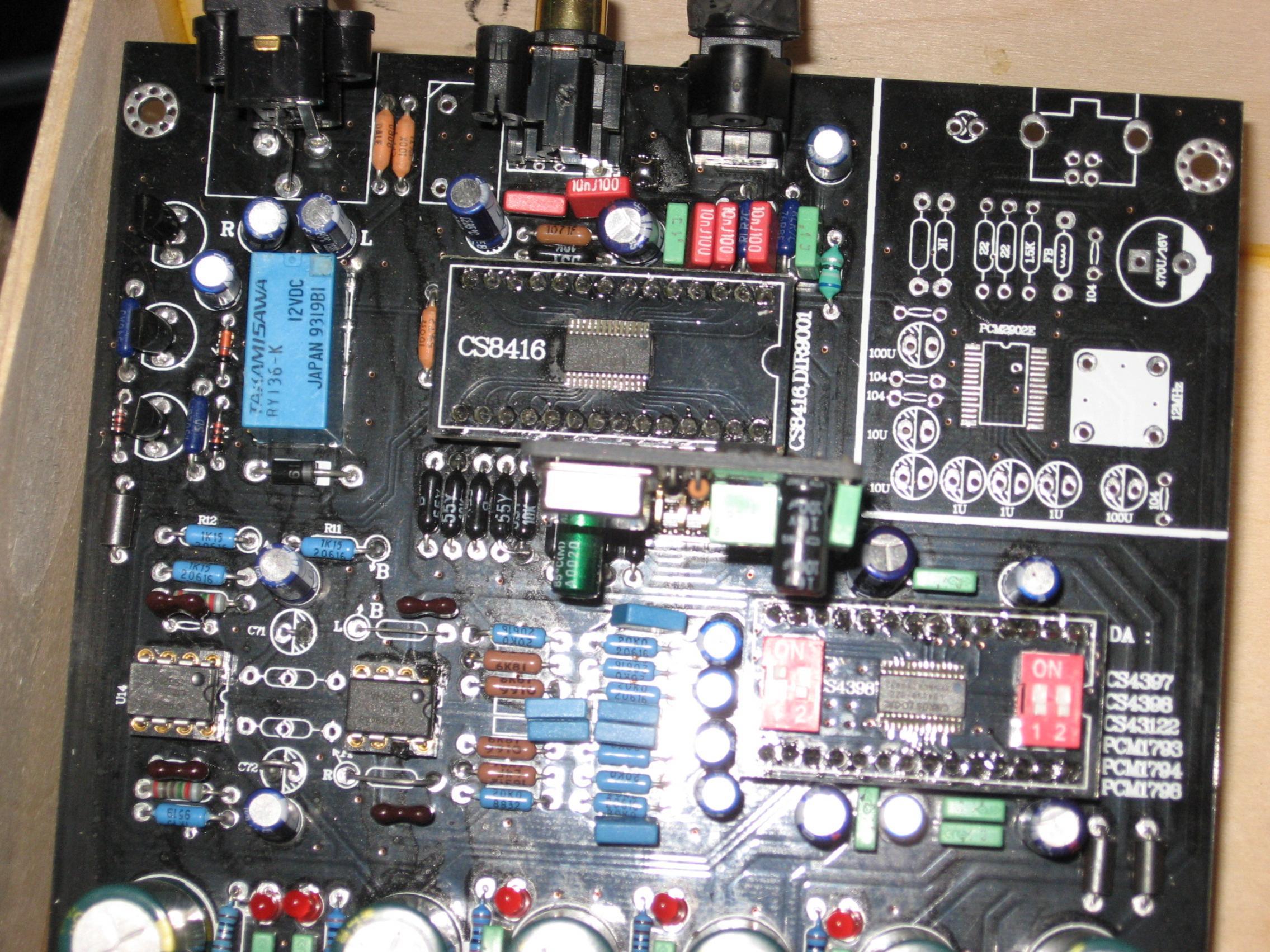

They cost about $4.50 from Digikey or you can get the, supposedly better, "can" version for about $15. The first mod I did with this board(CS4397 version), before jumping on the trafo bandwagon, was to bypass one of the opamps and replace the other with an LM4562. It sounded great. I then tried some "Burson type" discreet opamps but kept coming back to the LM4562 which I found to be at least equal if not better.An externally hosted image should be here but it was not working when we last tested it.
McK, I was hoping to use you pic here as a guide to doing the opamp bypass, but it looks like my layout is slightly different (why are they always changing the components?).
1) In the background you pulled off the 4 caps in front of the cs4398. Did you jumper them? Doesn't appear so in the pic.
2) Is the L/R out w/ the bypass from the 2.2ufs? (see my pic).
3) I can just use those L/R uouts straight to rca jacks, correct? Or do I have to solder them to that resistor like in your pic?

1) Yes they are jumpered underneath the board.
BTW the board was a basic(non-ups) CS4397.
I can't quite remember what else I did under the two twisted resistors as this was quite a while back and I no longer have the DAC. I do remember that I replaced original in/out RCAs but hooked the new ones up in the same spot.
