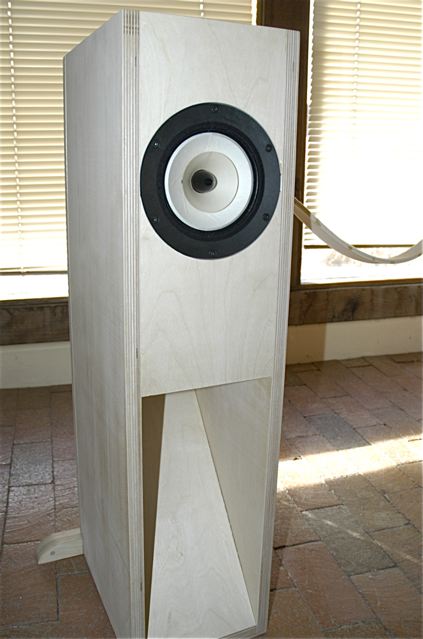

O.K. I've been listening for two days.
The drivers are wonderful.
Now its time to get some stuffing inside. The drivers in the Freddy are sweet but I feel it needs some fluffy stuff...I have no idea as to how much.

The box does need some stuffing but then I guess we all knew that.
So onward...
Photos in the AM...

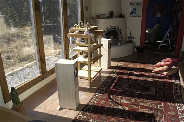

Nice Work Phil!
Love your listening room.

Toe to toe or no?
Right now the drivers are toed out...
They are about 32 inches from the glass and about 5-6 feet apart.
I will toe them in as time marches on and see what shakes out.
Next week we will install our winter curtains to help insulate the glass and reduce night heat loss. We found some white cotton quilted moving and shipping blankets on line. They are thick and heavy. They will certainly help keep the back reflections from wandering abound to the front.
I'm building some stands that will push the center of the drivers up about 12".
Should be done on thursday evening.
Will post photos...
Still have not stuffed the box...any help???

Hi Phil,
Geat looking box you got there... :cool: Wrt stuffing you can experimenting with just using crumpled newspaper to break up standing waves in the box, like what Teramoto did... I am currently using Tozawa paper resonators and newspaper or my newest D5nf+PB9 box. The Tozawa paper resonators are nothing more than a paper bag. I guess you could get your hands on some of those brown paper bags ... blow them up and tape them .. then it becomes a paper resonator in the spk box... I was skeptical of these devices at first but the Tozawas really did help cure the boxiness in the cabinets. Try the newspaper first ... cheap and easy to do.. :)
Borrowing Chris's earlier photo...
The Tonzawa is the crushed white paper box slightly on top of the driver and below you can see some crumpled paper used by Teramoto.
