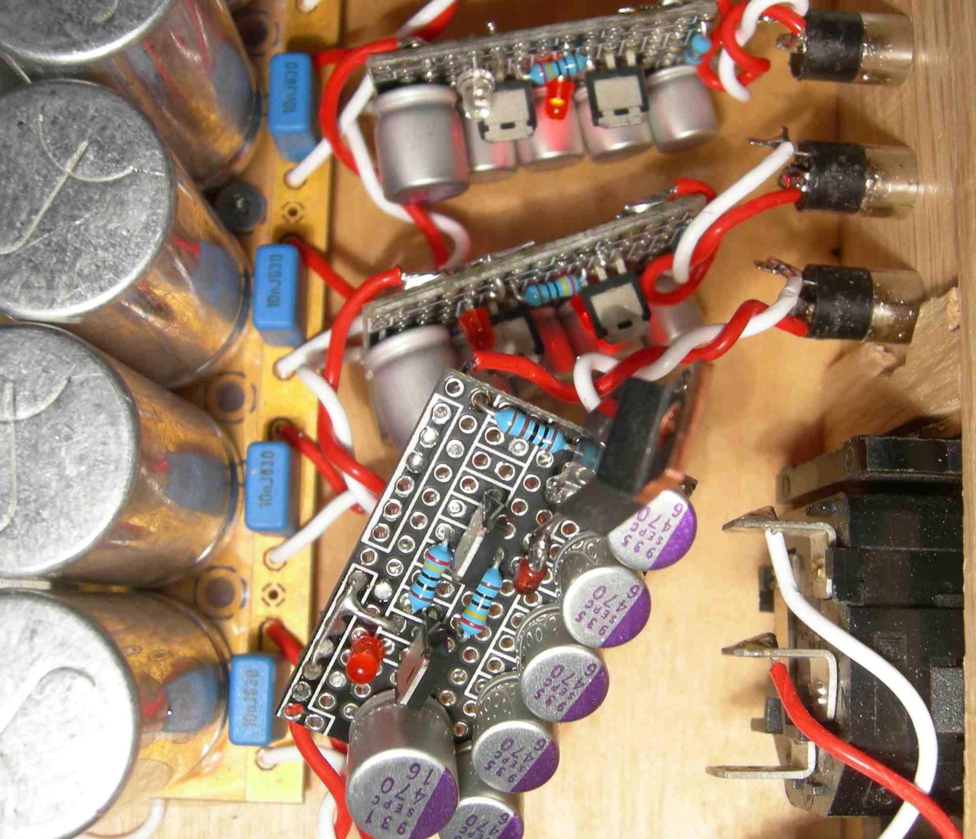

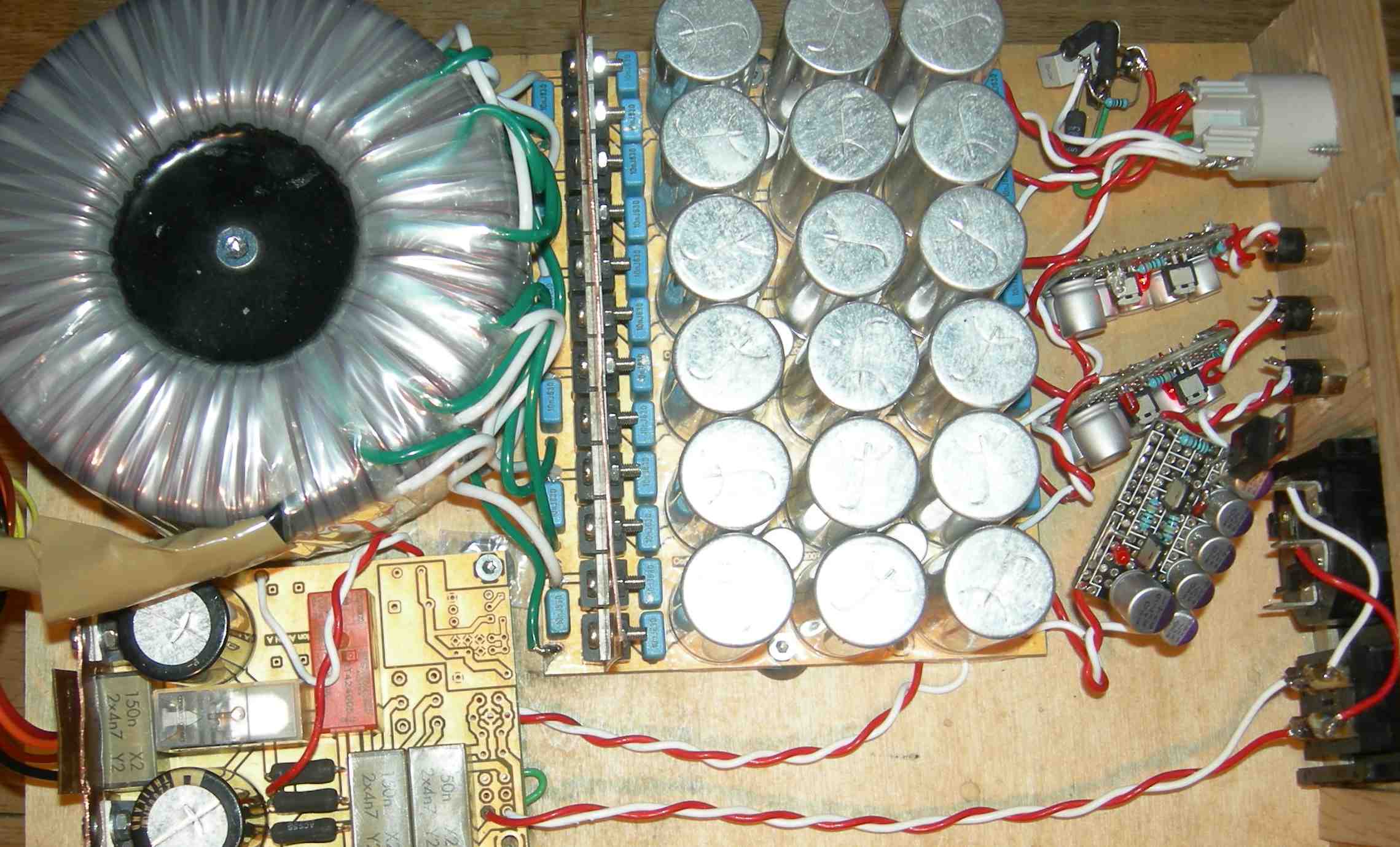

Tweaking of the exaU2I part 2 - pictures part 1..
The attached pictures shows the power supply and the JFET regulators..
In this prototype version I implemented the JFET regulators in the simplest / easiest way possible.
When the exaU2I are mounted inside the DAC cabinet there are already a main LifePO4 battery power and a two stage JFET regulator ready for connection of the exaU2I, and one stage JFET regulators will be soldered directly to the exaU2I PCB to avoid the long wires used in the prototype build.

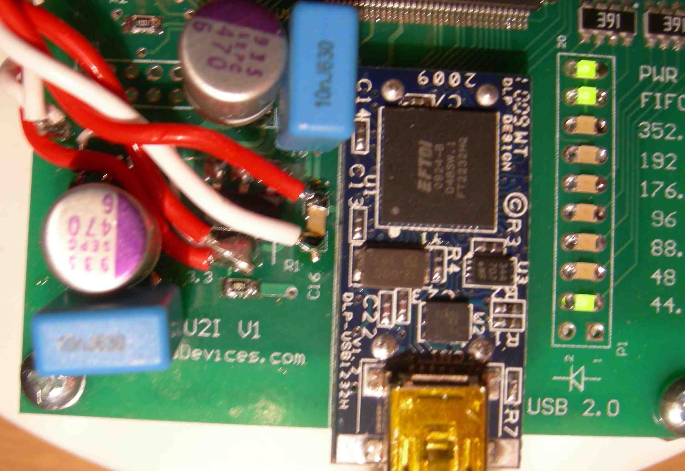

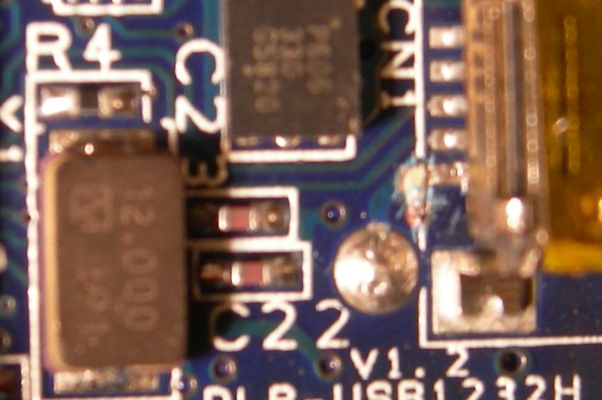

Tweaking of the exaU2I part 2 - pictures part 2..
The pictures shows where the USB power trace from the USB connector are cut, and where the new 5 volt are connected to supply the USB parts.
The quality of the pictures are not the best, but they will have to do.
On the exaU2I there are also two other places I have cut traces.
The PCB trace going from the 5 volt (USB) to the 3.3 and 1.2 volt onboard regulators and the PCB trace close to the 1.2 volt regulator and reconnecting it to be supplied from the 3.3 volt.
