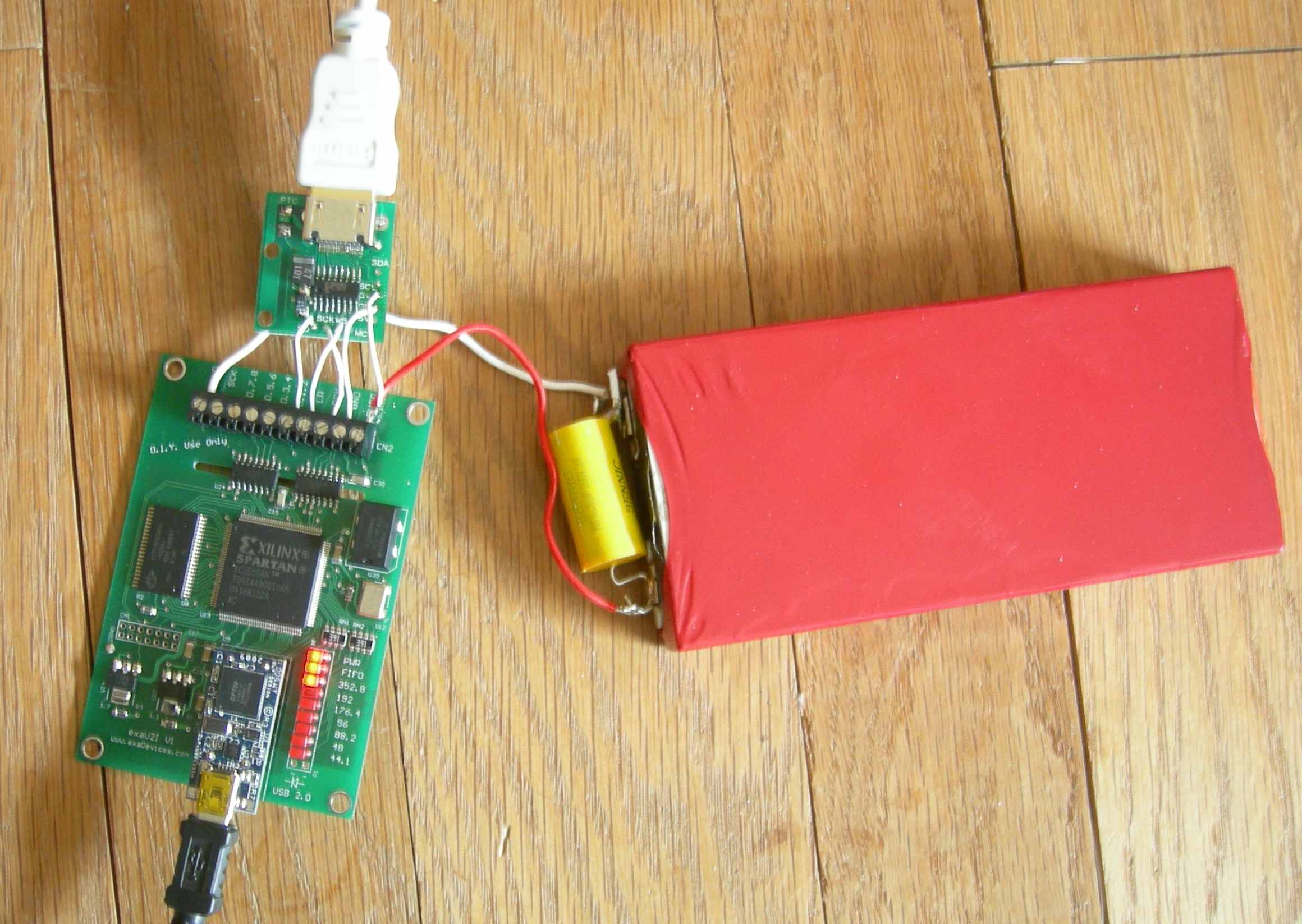

exaU2I basic evaluation
The exaU2I device have been up and running for 24 hours now and I have started the basic evaluations...
The basic evaluation setup are as follows:
Player PC:
Dualboot - 64bit - OSX 10.6.6 and Windows 7 Enterprise.
SSD system disk, 2T local storage, Gigabit ethernet.
With the ASIO driver evaluations I use Foobar2000 and Windows 7.
NAS:
Mac Pro (Hackintosh) running OSX 10.6.6 - 64bit.
SSD system disk, 8T RAID, Gigabit ethernet.

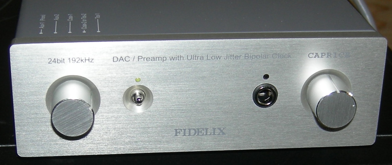

The first evaluated setup are the Japanese Caprice DAC / preamp from FIDELIX Home
Other setup´s and configurations will be evaluated from a technical aspect as I have the time for it....
The exaU2I are connected with a standard USB cable to the PC, and the output side of the GMR isolators and the LVDS transmitters (using HDMI connectors and cable) are powered by a 3.3 volt LIFEPO4 (12Ah) battery.
The HDMI cable connects to the Japanese Caprice DAC / preamp from Fidelix with a integrated HDMI / LVDS receiver with galvanic isolation.
The Caprice DAC uses a ES9018 chip and a 96MHz clock from Fidelix.
This setup might be the second most advanced / sophisticated setup with the exaU2I - disconnecting the USB power and run the exaU2I from two additional LIFEPO4 batteries will possibly be the ultimate solution and will be implemented when I start the listening tests..
The current setup works very well and did so at the very first attempt
44.1k/16bit flac to DXD 352.8k/24bit plays as far as I can evaluate perfectly.
I will test this configuration with 352.8k/32bit and evaluate the various configuration setups of the Caprice DAC before I continues on the next candidates (DAC)..
I will congratulate exa065 with this excellent and very useful product.
EDIT: The used (in picture with the exaU2I) I2S -> LVDS -> HDMI transmitter are also a product from Fidelix.
