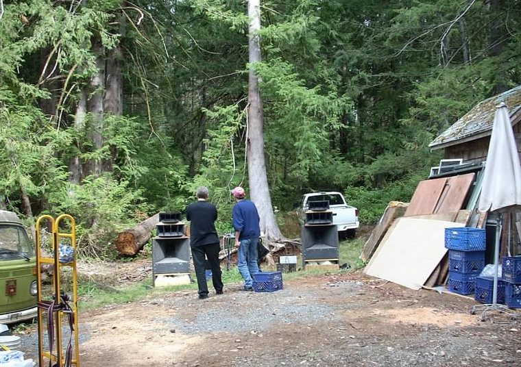

Ever think of building a Cornu Spiral horn? Now you can!
Here's a better perspective of the outdoor listening area.

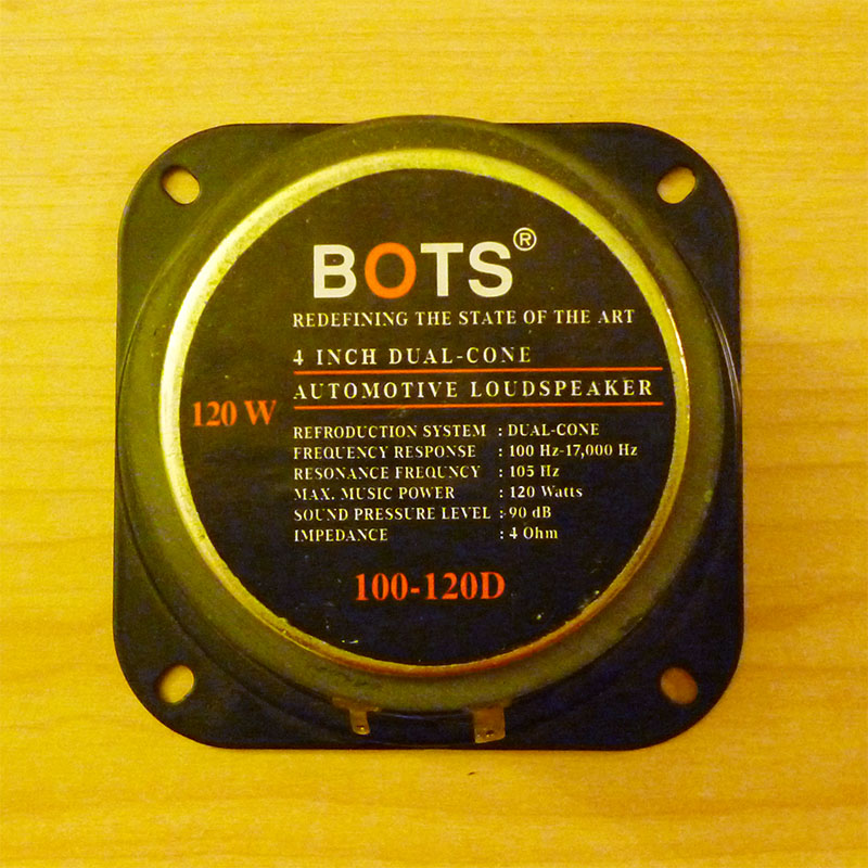

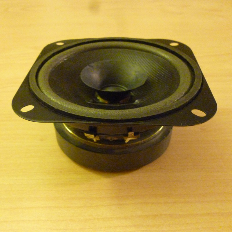

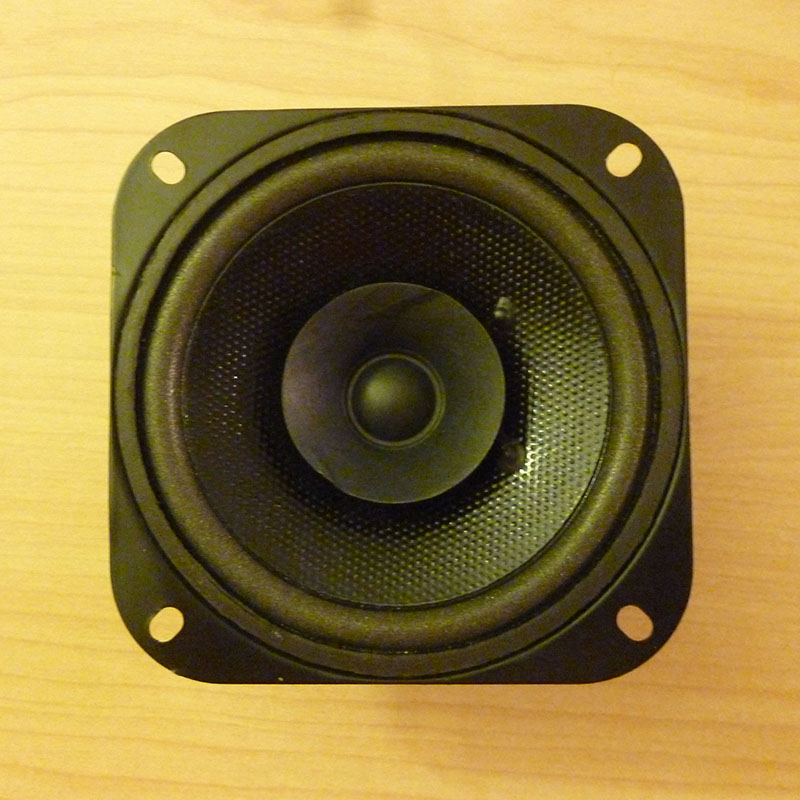

found these 3.5 inch drivers for less than 10 dollars per pair.. it's writing 4 inch but measured the driver and it is 90 mm and depth is 50 mm.. it's a good idea to start with full size 74 cm and then upgrade the driver.. also i want to use more quality drivers if everything goes fine..
i'm attaching updated drawings with measuring scales..
thanks a lot..

Endia, 4" car speakers might be just the thing. Good idea!
