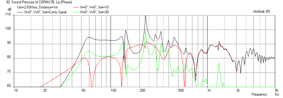

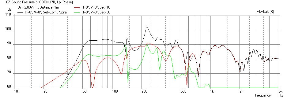

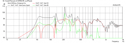

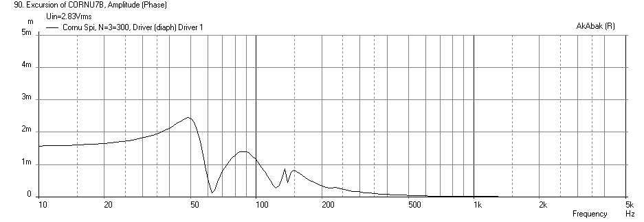

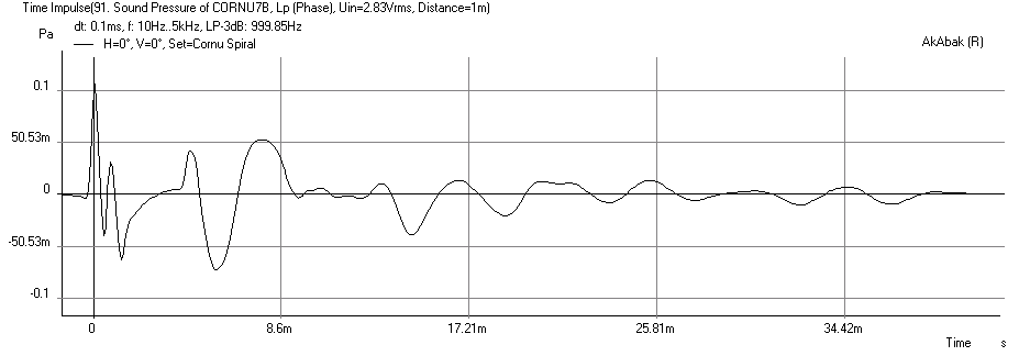

Hi xrk971,

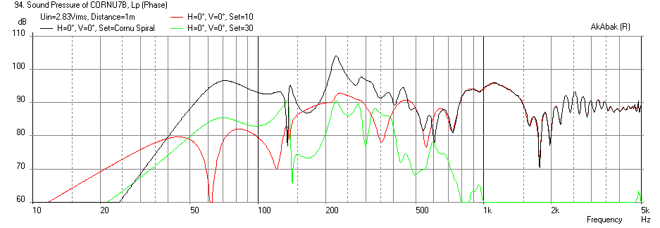

If memory serves me, horn loading has been reported to work best for drivers with Qts ~ .30 or so. However, from what I gather here, this configuration is somewhat forgiving for a wide variety of Qts values.
With that in mind, I found another possibility in my stash. It's a 4" with a phase plug. Haven't had time to measure FR yet, but I do have T/S parameters. Could this driver with Qts = 1.02 still yield a reasonable response?
T/S for nominal 4"
Fs = 89.5 hz
SPL = 83.4 dB
Sd = 52 cm^2
Vas = 2.7 liters
Mms = 4.6 g
DCR = 6.7 ohm
Le = 1.14 mH (@ 1kHz)
BL = 3.62 T-m
Qes = 1.34
Qms = 4.30
Qts = 1.02
Xmax = 3 mm
I don't currently have T/S on the Aura 3" that I have, but the Qts was closer to 2.0, IIRC.
Sim of Cornu with mystery 4 inch high Qts driver

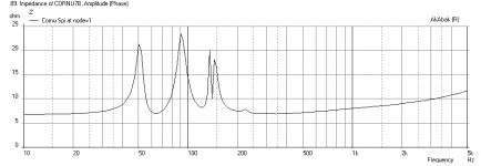

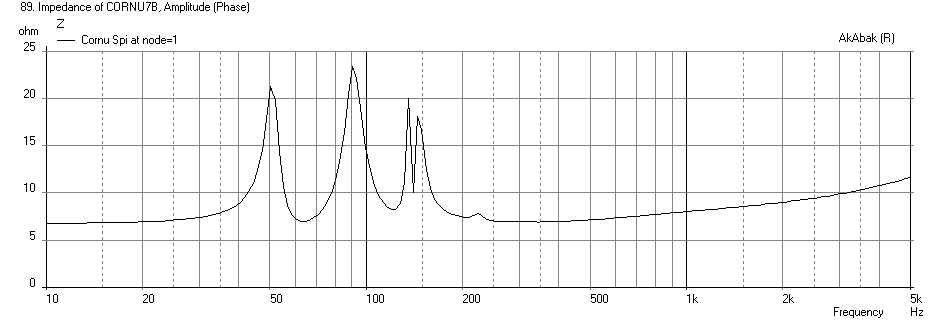

DaveR,
You are lucky - this driver seems to work quite well in a Cornu. Below is a simulation for a 27 inch x 4.5 inch deep Cornu mounted at 45 in above the floor (centerline of driver). Use moderate stuffing in the driver chamber and the first 40% of the channel leading from the chamber to the channel split point. It has a very flat bass shelf with about 10 to12 dB of gain from the nominal 83 dB efficient driver. The bass extends down to 50 Hz which es excellent, and like all Cornu's suffers from a few peaks in the mids, particularly at 230 Hz. Adjusting the stuffing at the mouth to taste can balance the bass out to be more in line with the 80 dB output in the HF's. You really should use a much more efficient driver in order to get a good balance between the bass and highs.
I would go for it and build this! Good luck!

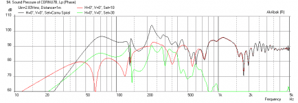

Here is what I think the bass might look like if placed near a wall. 27.5 x 5.5 inch Cornu with FF125WK.
