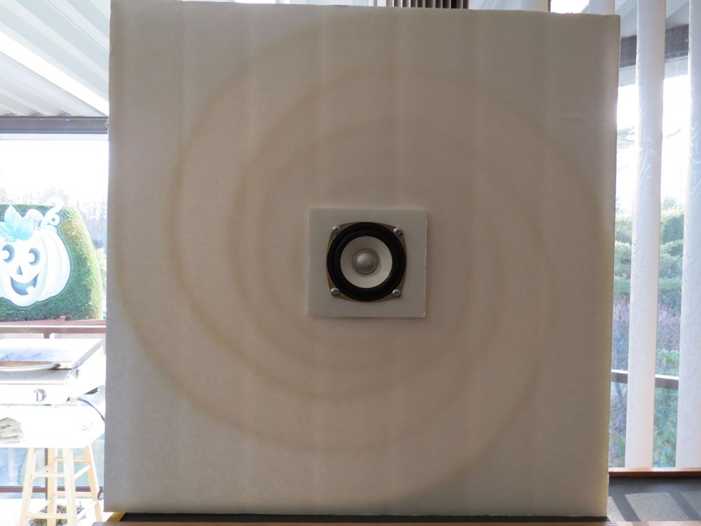

Started with this, hung a coil and a cap on the original set up and put the two to the test.
Big improvement.

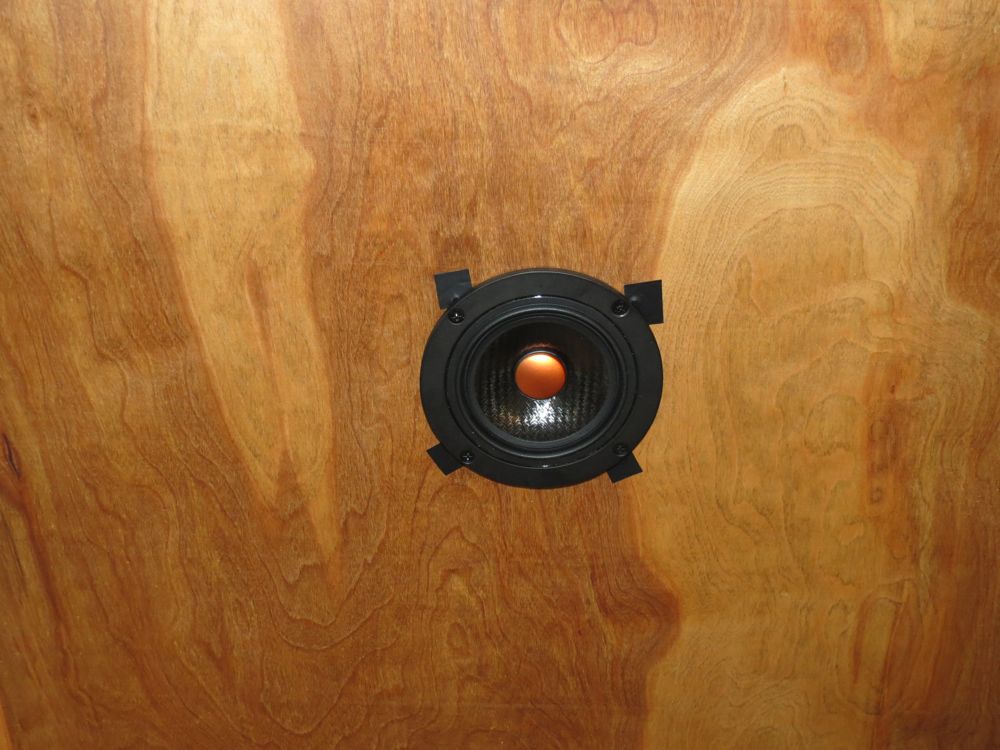

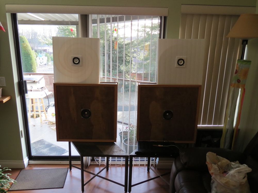

Then I introduced the CSS VWR 126 to the mix to replace the Fostex WR125.
We've now gone from having fun to being serious. This seems to the next step. Again, not the end all but a big 'wow' is in order. I will work on the stuffing but this is something the Fostex was not able to do.
Lots of experimenting with the XO at this point, all 6dB, all by ear.
Wifey says turn it down...
... I love it. :D

Very cool Cal! What do you think the crossover freq is about? The CSS VWR was what you were planning on using in the first place. You have me thinking now.... I have my wife's old JVC receiver with active crossover and built in bi-amp. Maybe connect my 20 in to the sub woofer and 14 in to the full range amp outs?
The large size makes me think this is like an OB with edge output. :)
Awesome experiment. Tell us more about the listening impression.
The last photo still shows the FF125wk?

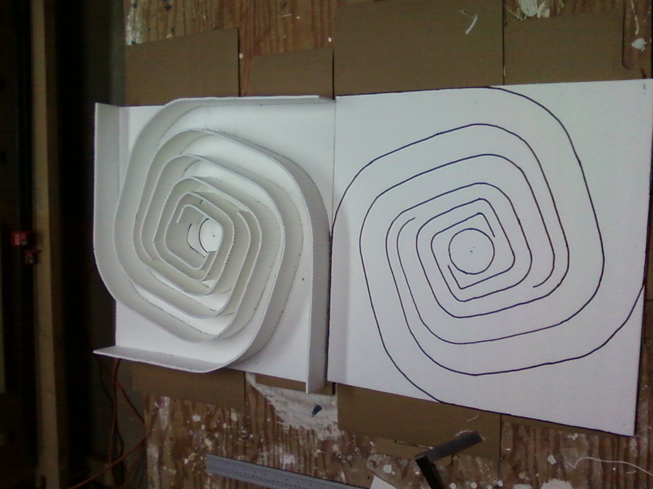

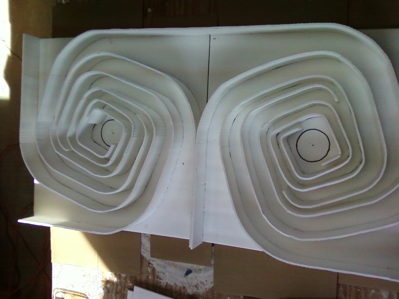

First Build
Here's my efforts for the weekend (and it's not over)! Throad area is about 2.5" sq., Sd for my speakers is about 5" sq. (Tang 3" Buyout). Speakers will arrive on Wednesday. I'll stuff the behind and channels out to about the division with pillow stuffing.
Does anyone see any glaring problems? I agree with Cal that these are a blast to build!

Nice work j. The only caution I offer is the stuffing. You can use a fork [almost perfectly shaped] to add stuffing to the channels but it's a sonofagun to remove it if you have too much. I would recommend using something a little hardier like rockwool insulation and heavily damp the chamber and the opening of the throats. You can add more if you think it's necessary.

Jsouder,
Looks great! :) Awesome job on the spirals. Make sure that the channel depth is uniform so that a good seal is made when you cap it. I sometimes use hot melt to build up layers on the channel edges that are too low. What is your channel depth, and I assume you are making the 20 incher? If doing a 20 incher, a 3.5 in depth should work well.
Jsouder,
Planning on using a caulk/glue for the top. I'll smooth down any of the edges where the pieces lined up. I think any changes will be < 1/16" which the cault should close.
The channel depth is 2.5", so the open area sum of both throuats is about 1/2 the Sd of the speakers.
I'm about to embark on a true spiral set. I'll try the 3.5" channel depth.

I've started working on a 20 incher this weekend. Will also use the Vifa 3.5. So, xrk, would you change anything based on the what you've learned? Is the 2-3/8" depth still ideal for the Vifa?
Has anyone tried a 2 sided spiral? like the original Cornu?
FYI, Michael's has the white Elmers 20" x 30" foam board on sale, 2 for $3.00 until 1/19/13. I picked up 4 to use for the outside pieces - insides will be the Dollar Tree stuff.

The 2-3/8 in size worked for me because I modified the channels to have a 1.1 in wide throat at the chamber. If you were to use the standard plan that everyone prints out, at a 20 inch scale, the throat is only about 0.6 in wide. So you will need a channel depth of about 3.5 to 4 inches to get enough Sd. But that increases the volume which will drop your upper frequency cutoff. To compensate, make a block of foam stacks inside and fill it up to reduce volume while leaving throats clear. Make a stepped cone like a zigurrat.
No, no one has done a 2 sided one yet. I have thought about it - basically apply spirals to both sides of the back and cut a hole in it. It can be done serially so basically it would be like making one at a time. This would simplify the messy step of gluing the face on.
