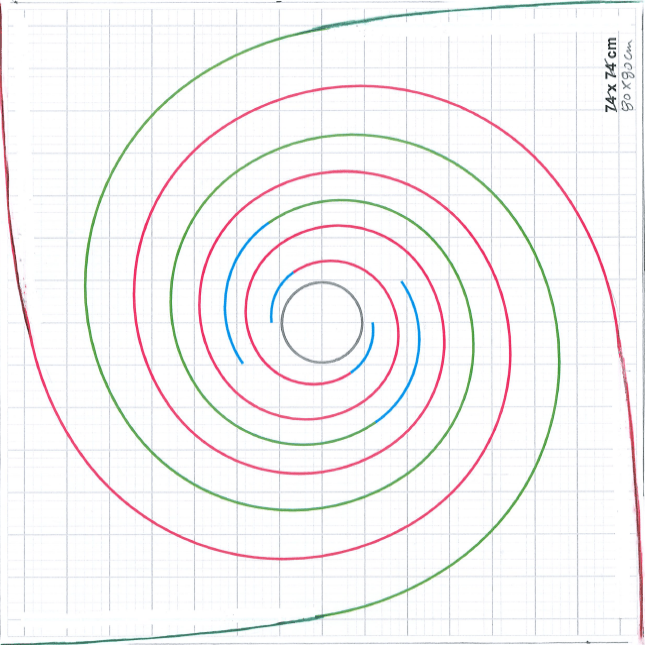

I'm making progress on the choice of parameters for my Cornu.
I read on page 2 that the groove surface had to be equal to Sd, ie for a Cornu with two grooves at the start Sd/2.
I made a table of the Sd characteristics of the loudspeakers and I calculated the throat surface and therefore the height of the snail strips.
with the spiral plane I measure a throat width of almost 1 inch (2.7cm) so depending on the speaker the height would be between 2.2 inch and 3.5 inch.
does that seem like a reasonable calculation to you?

While I am far from an authority, I think the non-uniform / variable rate of curve may provide some function beyond the ease of bending plywood. I worked on the math to calculate a perfectly uniform rate spiral (Cornu, spiro, clothoid, or Euler spiral, variously) only to see in other places that rounding over square/sharp corners in transmission lines was counter-productive. So, while adding damping material would attenuate the higher frequency waves, taking those bends out seemed like going double speed in the wrong direction to me (cutting out one thing to have to compensate with another).
Sd will have near nothing to do with the alignment. An artifact of “Classic Design”.
The primary parameters interact to give an alignment (in a horn, or TL a cross-section x a length) are Qts, Fs, and Vas. The parameter that most close aligns with how Sdis used would be the last.
In a horn the enclosure dominates. If you put a driver with “too much” in the horn you usually get too much bass, add some stuffing to pull that back. How low the horn goes is dependent on its geometry, and in the case of the cornucopia do not forget that the wall they mount on is an extention of the horn.

I understand that Sd is not the most important parameter to determine the groove surface. I re-read this thread and it was already explained.
But what are the links between Qts, Fs, Vas and throat calculus?
I can't find the formula that indicates this relationship.
the speakers that are quoted in this thread are very different on these parameters, almost double for some parameters.

I would be surprised if the throat surface is identical with such differences.
With many degrees of freedom things get complex. One has to use a good piece of software to simulate. HornResp is the current standard (MJK NLA).
This is a quick summary of the math, it has lots of holes. http://p10hifi.net/TLS/downloads/Dinsdale-Horns-3parts.pdf
This is more comprehensive. A 1200 page textbook: https://audioxpress.com/article/book-review-exploring-high-quality-horn-loudspeaker-systems
But you still need the software.

hello
after some research in the pavilion literature I calculated the groove necessary for finally a fostex FF105WK.
the speaker enclosure will be 60cm (23.6") side.
I try to do a simulation on hornresp but I stumble on the parameters.
the horns are uneven and I don't understand how to synthesize that in hornrep.
Thanks for your help
