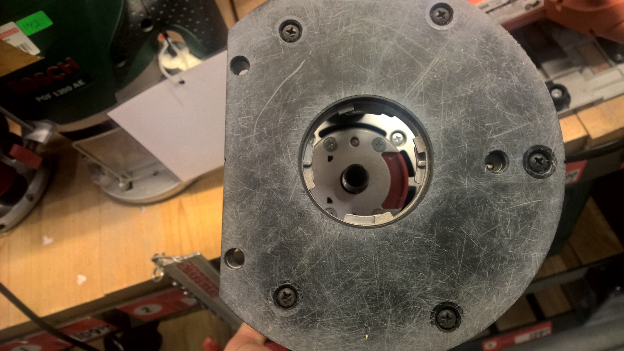

Ok, today after work I tried to scale Nisbeth`s file but it didn`t seem right. This will innevitably lead to mistakes which may render the unit unusable.

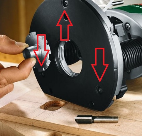

So, I went to the local Bauhaus and copied the base of one of these. This base is different from mine and the jig will have to mount using the screws that hold the plastic plate lid. I copied three of these (the POF1200 I found locally had 5 screws in total, the one on the pic appears to have 3 only) and the center ring so will add them to the file.

Only the published one, I checked it and it doesn`t fit one of the screws on my DW625 by less than 1mm (fixed now) but I am pleased that the radius holes are absolutely accurate. The POF1200 is different of mine. It had three holes that looked like mine but are not - not even a single one match and they have no threads, I don`t think they`re for table/jig mount. Problem is they`re not intended for table use as most can`t spin larger diameter bits anyways, like large roundeover bits of 25.4mm radius or more and are thus not pre-threaded. My old router was a Skil 1830 and had a different base layout to any other router...Thats why I ask for a 1:1 real size scan on A4 of the base of what people here have. Otherwise, I may produce it in a POF1200/DW625/MOF177/T11 variant and then everyone, using a piece of rice paper - you can copy your base and drill the jig the way you want it.

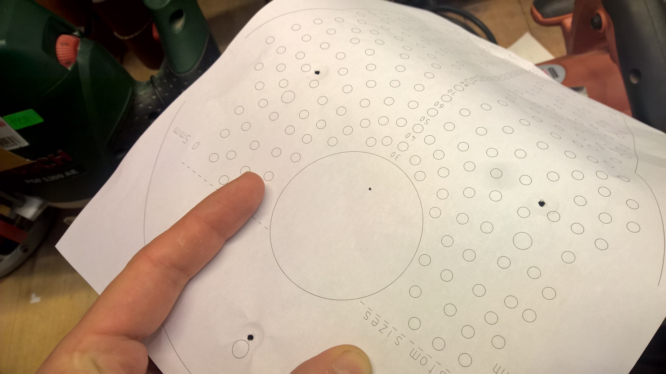

No problem. I have added the POF1200 base, taken from the copy I made locally. I will print it tomorrow to check if it fits the copy and have requested pricing. If anyone is curious to check on your own router - I have attached a real size PDF. There is a dot in the center of the opening circle which denotes the center of the router bit.The Bosch attaches to the three small holes, these are 2mm each in diameter. I do not know the diameter of the screws it uses (probably 4mm) so these may need to be drilled to expand or better - threaded. Drilling them should be an easy job for any diy-er but if someone wants to measure the diameter of one - I can extend the holes from now on.

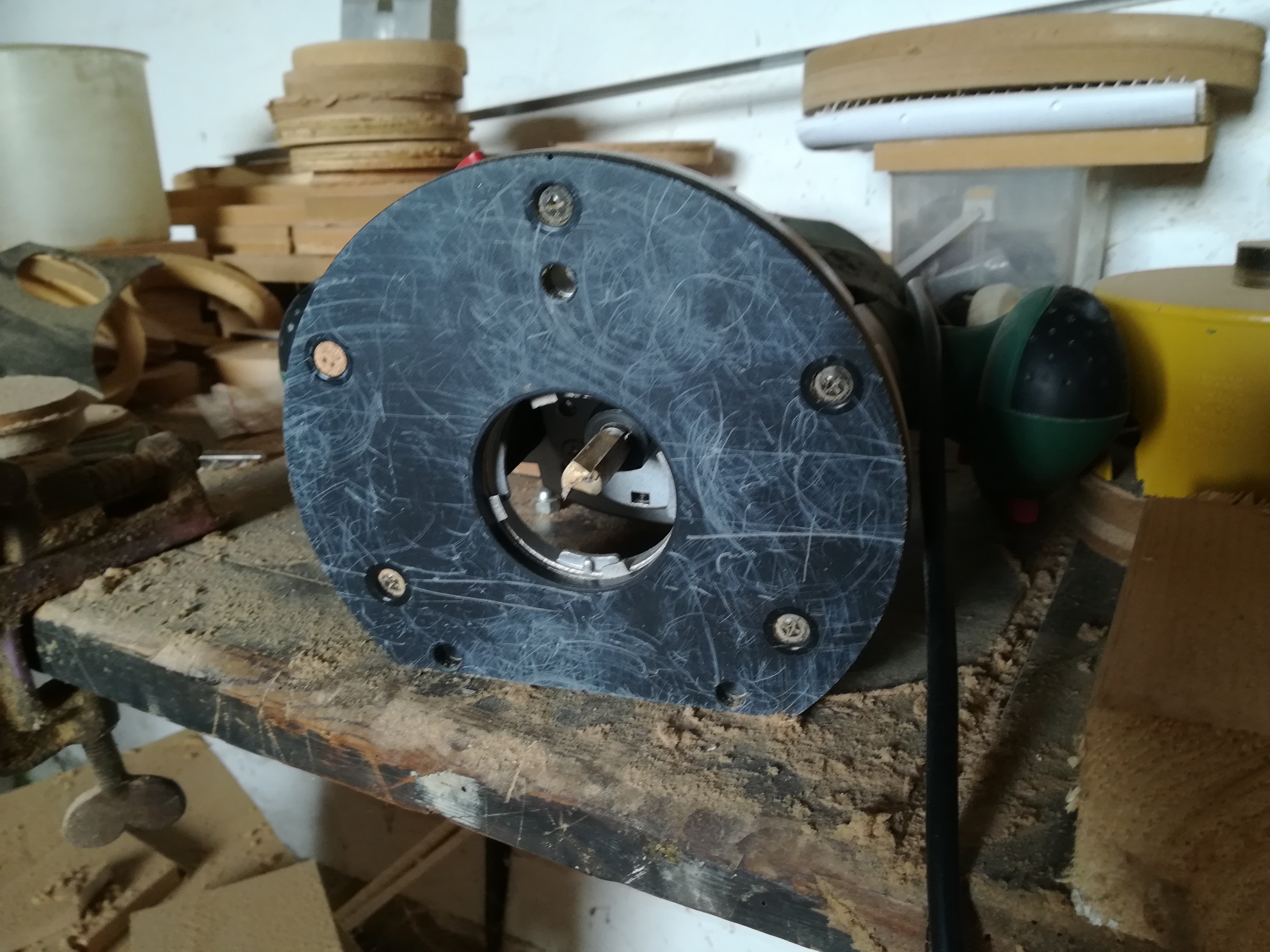

Hi Mario
The base of my Bosch POF 1400 ACE does not look like the base of the 1200
here is a picture of mine.
best regards
uwe
Thats the one I copied at bauhaus, with 5 screws. I have published a real size copy of the base, you can print it and try it on your router. The POF 1200 and 1400 share the same base, Bosch spare part is identical. I got this photo from somewhere but the ones at Bauhaus were all 5 screw base ones like yours. Printing a piece and trying it will help me a lot make sure it fits perfectly.

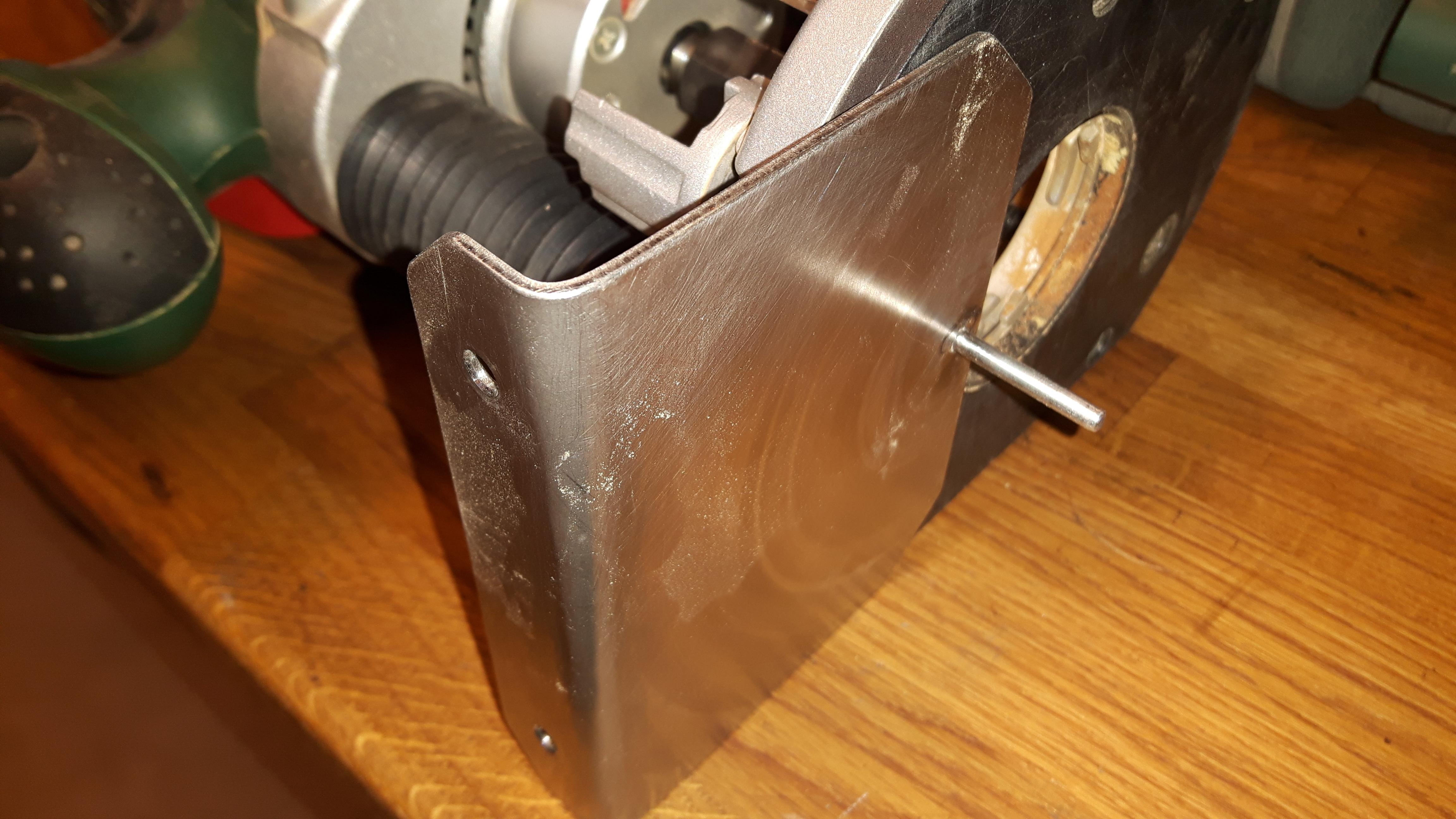

Here's the picture of my circle guide.
In version 2 I will make it longer and like a "U" so the plate will support better.
The only thing is that without pressure it will have the wrong angle because the plate doesn't support all the way.
Simple and cheap. M4x50 hex screw cutted and TIG welded to the plate. 2 holes for the guides.

I can point one drawback immediately - this jig will require you to keep the router with pressure on its side to make sure cutter head is at 90 degrees. Such jig will have a tendency to make the router flip slightly. Also, the rods on about any router out there bend. I used something similar and switched to a planar jig, a very crude diy version of the one in the thread, much better. Besides that, Bosch seem to have become behemots in the diy audio community, seems every other router is a POF :)
Nisbeth, I went to the store with a real size print - it fits perfectly. There were a 1200 and 1400 next to each other, I can confirm bases are the same. I took the 1400 and tried the print on it. See for yourself (I pressed the paper a bit so the mounting holes of the router become visible) :)
