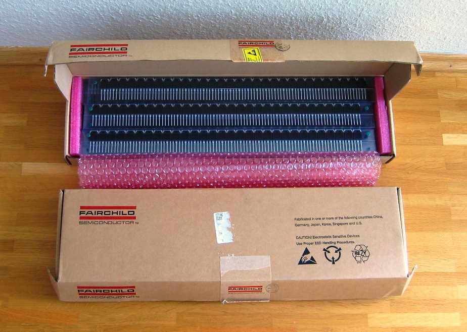

FETs arrived today.
I managed to measure 5 tubes of 30x N-devices.
Takes about 45 minutes for a tube, due to thermal connections to an alu block and screwed terminals for current. So the whole lot will take a while.
At 1.6A, Vgs (=Vds) varies from 3.72 to 3.83 V, so far.
Within a tube, the largest variation is 0.09V, the smallest 0.07V.
So your would have been lucky getting say 2 sets of 4 from a tube.
Shall try to post some photos tomorrow.
