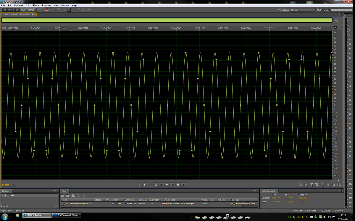

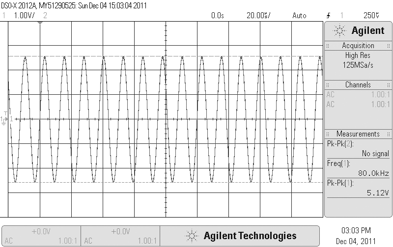

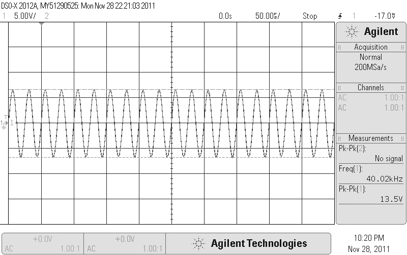

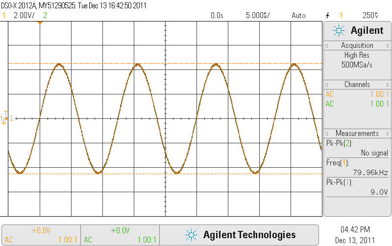

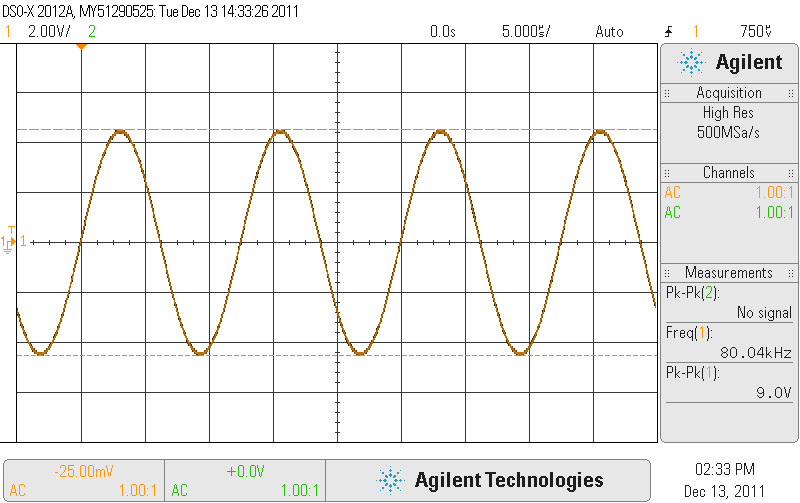

I think to show you something interesting. Maybe somebody else is already known with those things. For me was just a surprise.
I`ve created an 80kHz wav file with Auditon - Tone generator. You can see here the print screen of this file. I really do not know how it can looks like in real the created signal. I take as true what Audition shows about that signal in the file...
80Khz is of course no any "tone", but the software it works fine to generate like this (up to 95kHz as tested). The file is mono, 192Khz sampling and 24bit (created 32 bit and wav finally coded as 24 bit, -3dB)
I`ve copied this file on an USB stick and stack it in to my Oppo95 (which I use for moment as platform for my ESS9018 experiments).

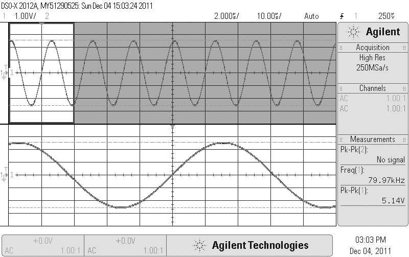

On the RCA output I have this what is to see it here...
Just exactly wave I`ve software generated! Just 2-4 times the audio frequency spectre! No any distortion! Just fine, clean sinus!
My scope is a digital one, so the captured picture looks like it looks (digital steps/stair). Anyway, the sinus is just very clean...

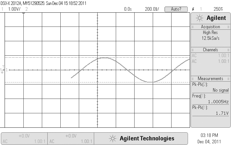

For comparation I show her too, a captured screen from one channel of stereo playing a normal audio file (very dynamic orchestra, 44,1 Khz).
I`ve tested too with 40kHz "tone" signal (actually this was the first test...), and then with 1Hz one (the same samplings and the rest...). As you can notice, is the output pp level which is diffrent on those tests. The level decrease, but the sinus is just perfect.
I have the option for creating also square waves, but this sotware does not succed to create something like this very well. Is a kind of square wave, and looks very bead at such frequencies (it looks fine in audio normal spectre). Anyway, those square created files I`ve plaied out on ESS9018 stage looks exactly like the original generated "sound".
My ESS9018 is running now on 122,88Mhz clock, and I have no any filter between I/V and final stage. Final stage is supplyied with +/-15v, I/V stage with +/-13v
I think that is just amazing that ESS98018 can convert ("play") such frequencies without any problem. I think that is also amazing that such siganls can goes through all the before stages and after all conversions it come out without any distortion...
I`ve tested with FLAC coded files in the same conditions. The same results...
Waiting for your comments...

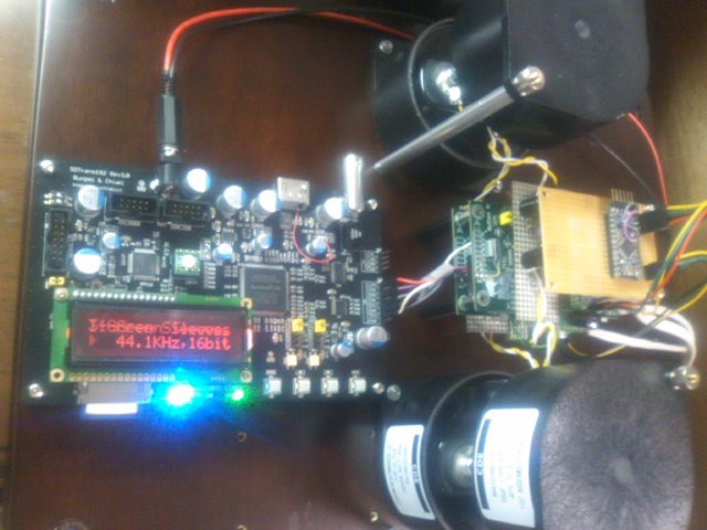

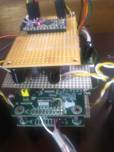

By the way, my final configuration tested for my co-worker is like this;
1. Doubly stacked Buffalo III
(Not dual mono. Paralleled stereo mode)
2. Synchronous master clock feed of 22.5792 or 24.576 MHz from SDTrans384
(By using a non-oversampling filter mode, sources with sampling frequencies up to 384 kHz can be played without noises.)
3. Linear regulator sub boards for AVCC(+3.3V), VCC(+1.2V), DVCC(+3.3V)
At each input side of a linear regulator for AVCC, a film capacitor of CDE 100 microF/800V and OS-CON of Sanyo 10 microF/15V are attached.
At each output side for AVCC, Copper foil PPS(Poly-phenylene-sulfide) film capacitor of Sunring 0.022 microF/250V
(No big capacitors are attached.)
