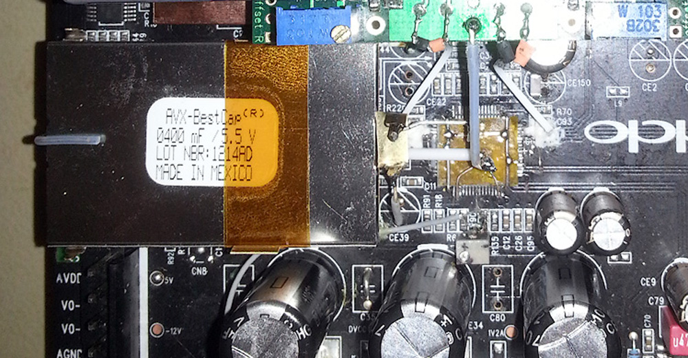

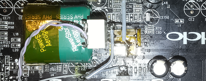

Well, what about heaving an AVCC almost as from a battery?
Because an 2,5F cap it can very well simulate a battery...

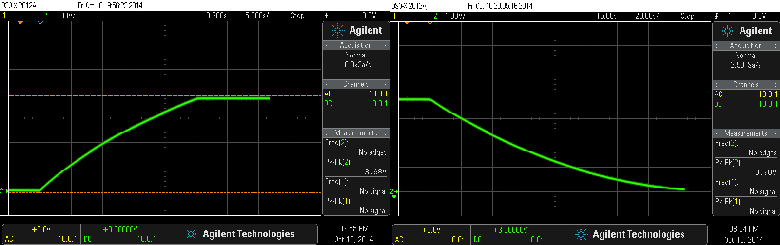

I have found a smaller dimensioned double layer cap, but 6 times higher capacity than the previous cap I used. Its ESR is higher than another one cap: 0,08ohm. but I think this detail is not so important here...
It is the same regulator, which it charge this huge capacity, in 25s, as you may see in the pictures here. By the way, the regulator it is a LT1763, but it have a transistor on its output...
I chosen to add a discharge device for this cap, as at its capacity, it may take teens of minutes to be completely discharged. So a relay connect a load to the cap terminals at the power off. The discharge time is to be seen in the picture here.
I think I will stop here with increasing the filtering capacity for AVCC. Further increasing of this capacity it may not bring much more improvements for the audio outputted, and the charge/discharge time it goes over a reasonable level.
But what about the sound out of a such configuration? The obvious (perceptual) improvement is in the lower end of spectre (of course...). It increase a lot the precision of the bass sound elements in the sound scene, with a very much increasing of the dynamics in low end spectre. Such low frequency sound components are very well defined in space, and can be easily located. The improved reproduction of harmonics in the low spectre, and the plentiful of these it complete in a very special way the another sound elements in the rest of the audio spectre. It bring like more colours nuances and gradients to the sounds... It improve a lot the fidelity of reproduced sounds, it give to it weight and power (for the same decibels of course).
I think it may be a clue to improve in this way all the ES9018 power rails, but to manage so many such high capacities at power up/down it may be a challenge...

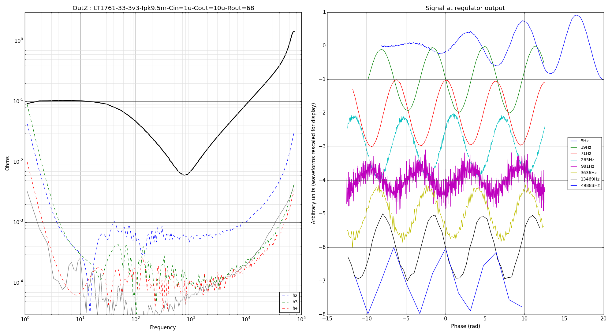

It is a well known fact (and my measurements confirm it) that AVCC supply is critical for ES9018. Especially in Voltage mode... does it work in Voltage mode or current mode on your board ?
Anyway, see attachment, this is LT1761 regulator's output impedance... I don't get why audiophiles seem to fall in love with it, it is by far the most expensive of the bunch and doesn't show particularly interesting performance. For the test it had a BYP cap, I don't remember the value. This is what causes the drop in output impedance (good), and its rise at LF (bad).
Perhaps the fact that it has a rising output impedance at LF explains why when you add more caps to compensate, it sounds better !.....

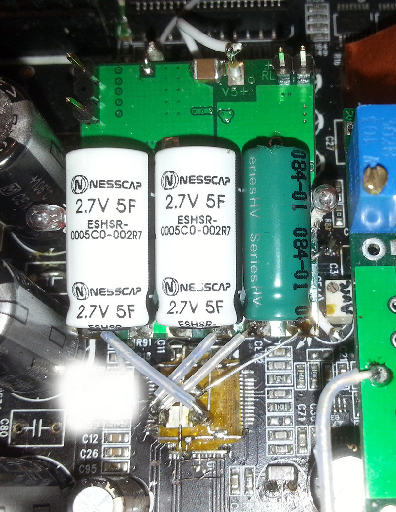

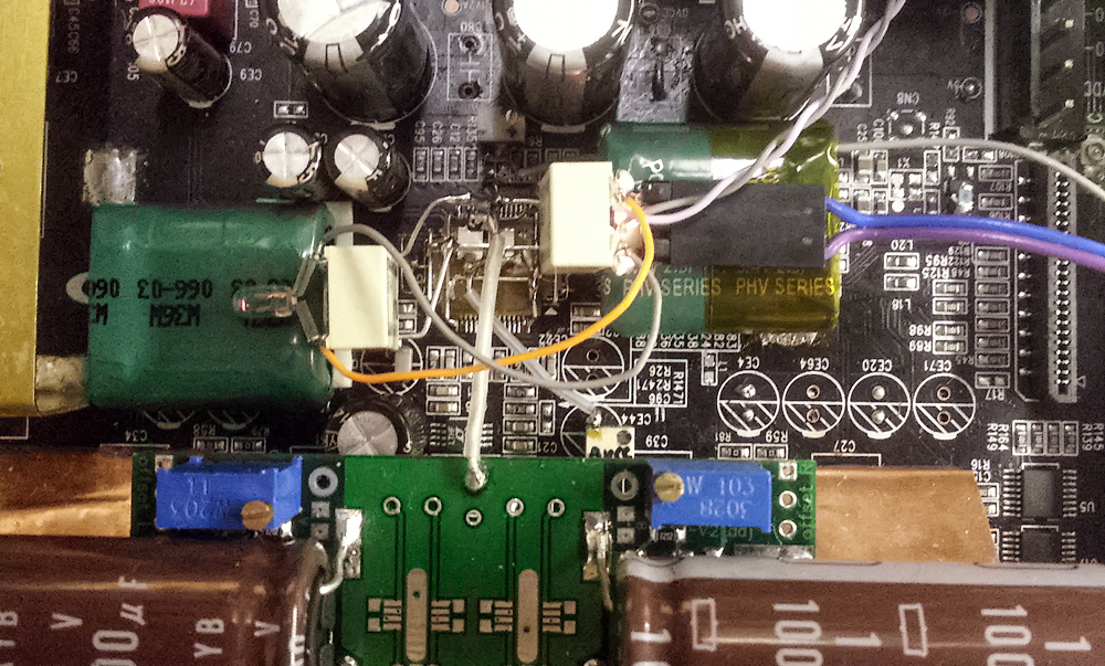

After using a very large capacity on AVCC, and getting the improvements described above, I thought it is not quite right to ignore the another power rail for the analogue stage (core - VDD L/R) of ES9018...
Well, I have used the same capacity (2,5F) for 1,2v VDD L/R of the chip, while keeping the existing (not just high quality) regulator.
The result is just impressive. Especially for the soundstage quality. The even more increasing in precision for the sound elements in space is just unbelievable (at least for me...). The dynamic is increasing so, that become quite obvious that the band, orchestra, or whatever is just in the room. The very low spectre sounds are extremely well defined as location. No any sound is coming from everywhere, but from a very precise location, as it was recorded. Such precision for low end spectre sounds is fully remarkable. It only miss from these "scene" to see the musicians, instrumentalists, vocalists... The sound and the dynamics of the soundscene are just as experienced in front of a life event. All this at relative low volume...
To experiment with these very large decoupling capacities, I have disconnected (lift it up) the analogue stage power pins from initial layout. A grounded shield was placed in between the chip and the new power connections. There is of course an experimental configuration... Which it works amazing!

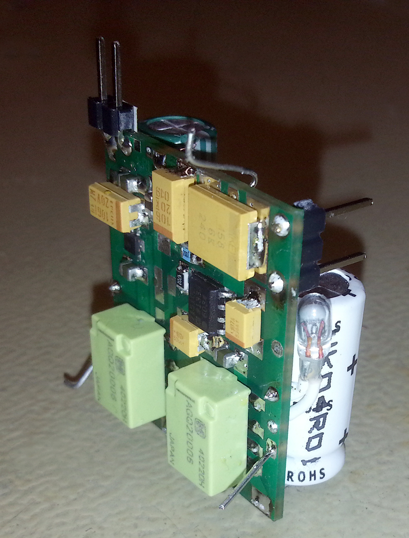

This is the final version of my AVCC/VddL/R PSU.
It use 2x5F (serial connected) caps for AVCC, with a total ESR of 60mOhm, and 3F cap of 80mOhm for VDD L/R.
1,2v VDD is delivered by a LDLN015 regulator. For AVCC it is used the ADM7151 as adjustable regulator. Both tensions come up to the normal level quite simultaneous in approx. 15s.
The both rails are independent with separate grounds. These grounds are to be connected together at the common GND point (ES9018 ground pins). Of course, the shortest possible connections with the DAC chip is a must.
I have tested it so far for 80mA load, and the chips temperature do not exceed 35dg.C. The relays it discharge the caps at power off. Resettable fuses protect and cut the currents, in case of any failure in discharging circuits.
Two such modules it can power the ES9018 for all rails.

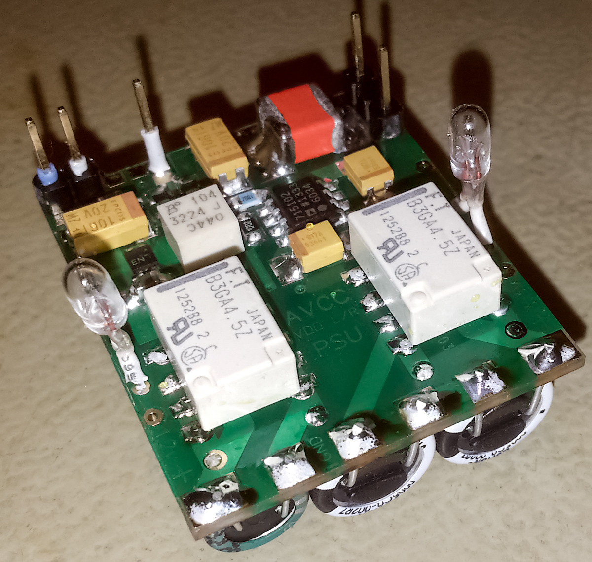

There may be an option to use resistors to discharge the caps. But I think is not just the right option in this case.
I use the very simple, old, and good bulbs (as the pictures reveal), which are more suitable for this function. The miniature bulbs may fit to the discharge currents. A more advantage to use bulbs is also the visual indication of the process.
A resistor for discharging circuits it should be quite high power rated to sustain the discharging currents. It may be a big component. The resistor it show a constant resistivity to the cap, the discharge process it happen in a linear way, and it may be longer. A old classic bulb it function in a different way, and it lower its internal resistivity as it get cooler.
Have Edison ever dreamed that its invention it may be very actual, and useful in a high tech world?

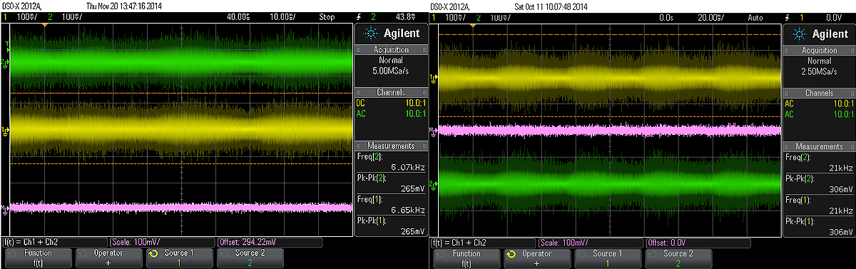

A slightly lower HF noise at the DAC chip output, when using this PSU.
There is here about balanced outputs, measured in similar conditions, before and after connecting this large capacities PSU.
Please notice that in my post DAC processing are not involved filters.

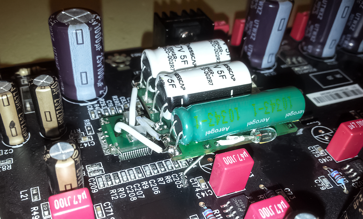

Here is the implementation of my PSU (final version)...
I think it will be only for the analogue power rails of ES9018, which it will benefit of this special way of powering it. At least in my vision...
