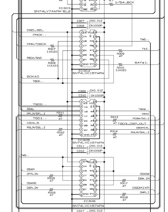

Since I have received a few emails asking how its done here is how you get DSD from any SACD player which uses the PCM1791 like the Denon DVD-2910.
Pin 1 is DATA R
Pin 3 is DATA L
Pin 5 is the bit clock.
Then you just need GND.
Cheers!
Russ
I found this old description of how to get the DSD from a Denon DVD-2910. I just wonder if any one knows if all tone controles, incluing volume, are bypassed when selecting "source direct" in the player so the pure DSD stream is captured when picking it from the DAC.
--Per
--Per
Denon says that in Source Direct (50kHz or 100kHz filter), the DSD stream goes unaffected into the DAC inputs. The filters are actually analog filters inside the DAC, so they won't affect the DSD stream. Selection is done with some 74LVC157 - easy to check (DSD_SEL). Same system is inside DVD-2930 too.
