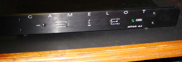

Telstar said:
Which Camelot DAC do you have?
The Camelot that I have is the Arthur 3.0 MK3.

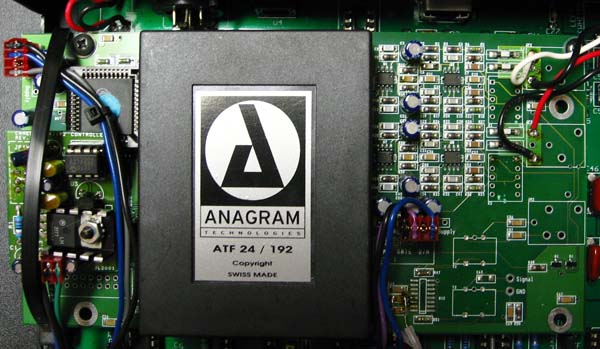

Telstar said:
Also, which revision of the anagram module was in it? My guess would be the mk4, as used in the excellent Audiomeca Enkianthus DAC that i had the pleasure to listen.
If that's the case the Sabre is looking really great.
I don't know the version of the Anagram module. The DAC is about 5 years old. I will put it up for sale soon because I need to raise money to build some more circuit boards.
