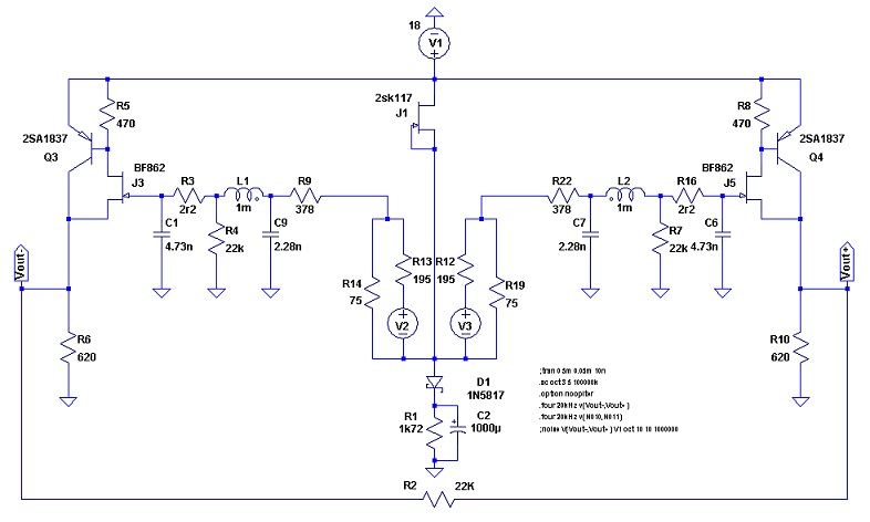

It is voltage mode, single ended (only one output), no probe, very short coax from pin direct to scope. Here the coax is unterminated... with scope 50R termination active, levels have to be corrected, but it doesn't change that much. I've been wondering why, and I think the answer is that the output impedance of 9018 at HF isn't really 800 ohms...
When using an opamp as an IV, its input impedance will be very high at HF anyway... so nothing reduces the amount of HF blasting the input stage.

The only way completely eliminate the quantization noise - is a brick wall. Even a fully symmetrical opamp will run out of GBW at which point it's inputs become high impedance.
This is why I have often wondered about putting some sort of inductive filter in front of I/V stages for DACs like the ES9018.
The other option is to use an I/V stage that does not employ global NFB. My Legato (as does Pass D1) output stage is one such stage. It basically has a built in brick wall (or at least the transfer function continues more closely toward infinity)
Of course one can always use a transformer too.

You can always try to add 2.2nF C0G (or film) across the 750R IV resistors and see if it changes anything...
