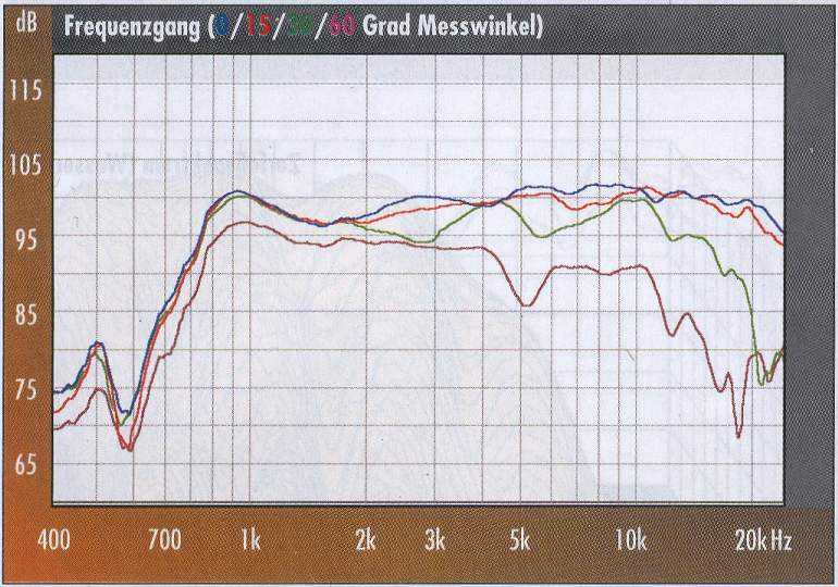

Hi Promitheus,
You know where I got this graph from
There are always some differences between the measurements of Klang&Ton and HobbyHifi, but i think they give a very good indication of what the units do. (usually the T/S parameters differ, but the measurement-graphs are pretty much the same).
To calculate the filter you should measure the output of the unit(s) yourself (to get the best out of the units).
I use those graphs for selection of units, but measure it myself when I have it.
Grtz, Joris

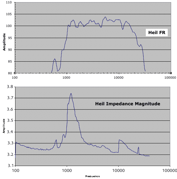

Is that impedence graph accurate???planet10 said:Here is the measured response from the 1st set we used:
dave
I have an old pair of the Great Heil's (or so ESS tells me they call them), and had no idea that the impedence was so low. A bit over 3 ohms is, well, suprising...
EchoWars said:Is that impedence graph accurate???
Made with LMS... i have no doubt it is accurate
dave
