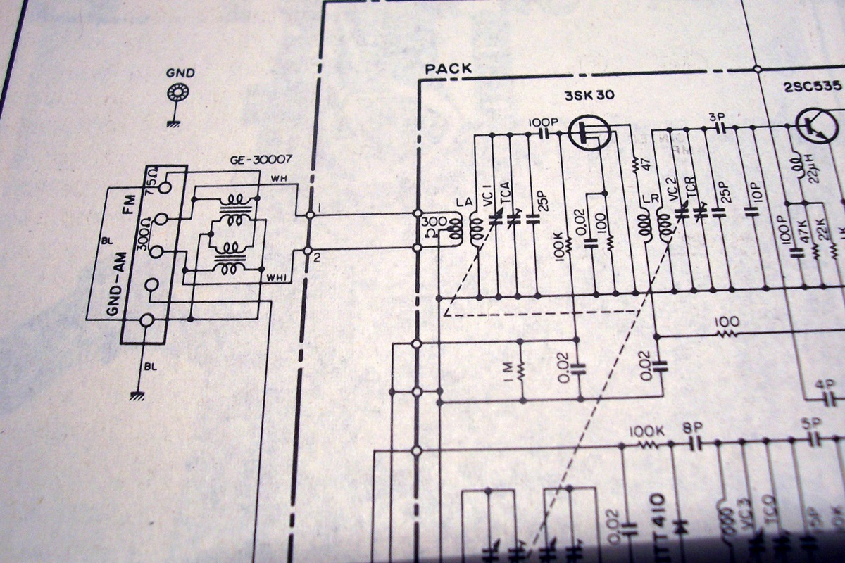

I recently probed a tuner input with a vector impedance meter and was surprised to see about 75 ohms, but with +90 degrees phase, so it was essentially a 122 nH inductor.
Not being an RF guy, can anybody explain how antenna coupling actually works?
The antenna (Aerial) input normally is a single coil called "a Link". I´ll try to explain it. The tuned circuit is normally wired to the input of the active device (Tube, MOSFET, IC, etc), directly (called Series feed) or capacitive (parallel feed), at the top of the tuned circuit (TC) if the active device matches the impedances under question, or at a tap in the coil if not.
To obtain the width of band desired, the antenna coil is normally inductively coupled to this TC, and its reactive reactance is normally design to obtain the 75 or 300R to match the antenna load. This low Z coil normally isn´t too much coupled to the TC so variations in antenna conditions don´t affect the TC itself. Say, supose you have a high coupling factor, and the antenna is properly matched. So, a bird puts in the antenna, resulting in a detune of the FM section: a bad idea. In FM front ends rarely is used some "rare circuits" like a Pi coupled.

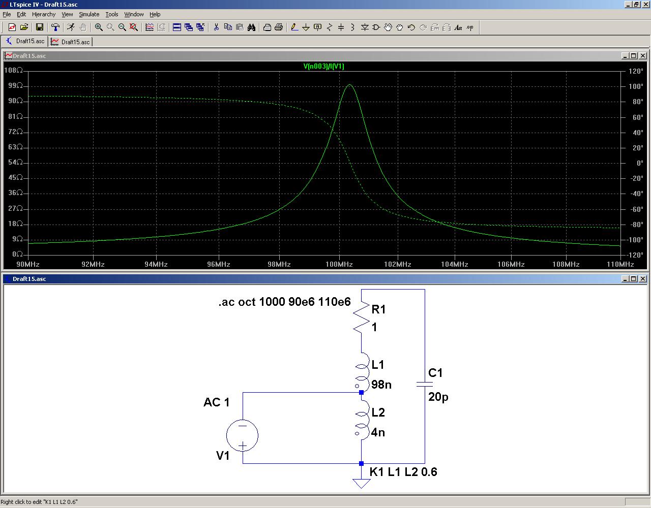

I see two possible reasons:
-In good quality tuners, there is normally a tuned circuit at the input, coupled to the main tuning control (cheaper receivers have a fixed, heavily damped tank circuit).
Such a circuit has the argument of the impedance equal to ~+90° or ~-90°.
Only at the resonant frequency is the impedance resistive, but it is a spot frequency.
If you make a random measurement, you'll see either + or - 90°.
See below
-Many tuners have an inductive matching component, balun or similar between the tuner and the antenna connector, and this inductive component will dominate the impedance
