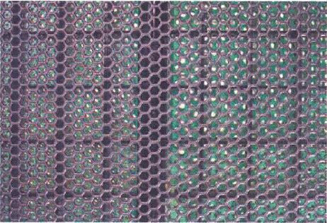

One could also build stator from three metal sheets(1-2-3), two of them(1-2) used for driving the membrane and one placed on the back as a shield.
Front and back sheets are connected together and grounded.This way the system is quite safe to touch from both sides. A step further is to add an additional diaphragm between 2-3 and use two bias supplies with reverse polarities(two-membrane sandwich).

I get your point, and I will definitely be careful when building and experimenting. I am aware of high voltages as I am a SAP (Senior Authorised Person) on our 11KV networks at our larger sites at work. These systems are not to be messed with, 11KV ring main systems with the capability of carrying 200-300 amps!
I like the idea of using extra mesh on the front and back which are grounded, very good idea. I suppose mesh could be used with a much larger open area so as not to disturb the response too much.
This is an excellent solution.
Attached pic shows high % open area mesh used as grounded safety shields on some models of King Sound ESLs.

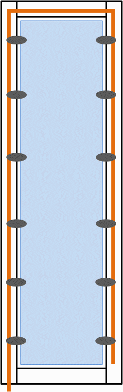

Concerning HV bias contact corrsion:
Back when I was building stacks of test panels and Licron didn't exist, I come up with the following solution. I applied coating to the diaphragm leaving a 1/8" border inside the spacers. Copper tape was run around the panel in the middle of the spacers. Patches of Dag graphite were painted on to join the copper contact strip and coating.
This minimized leakage currents across spacers in humid conditions and avoided any possibility of corrosion. One of my favorite coatings at the time was Ivory dishwashing liquid soap thinned 1:3 with water and air-brushed on. Even that has shown no corrosion tendencies with the graphite after 15+ years.
