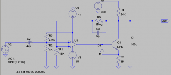

I am trying to design a simple transistor headphone direct drive amp.
Would this schematic work ?
Thanks in advance ,
Lukas.

ESLs generally require balanced drive (i.e. push-pull) on two stators. How do you intend to connect this to an ESL driver?
You also need a HV bias source for the diaphragm...
Try something like this:
http://www.headwize.com/projects/showfile.php?file=gilmore2_prj.htm
Download a copy of SwitcherCAD and learn how to use it. You can simulate the circuit and get a pretty good idea what it will do.

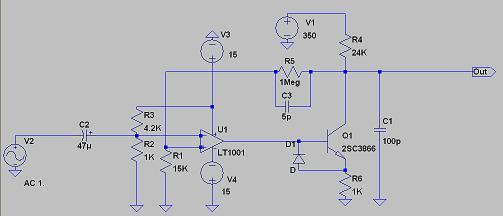

I tried to simulate the following circuit.I built a prototype and tested it , but the distortion levels are around 0.2% from 50Hz to 20Khz.
What is the problem ? Circuit design flaws , or wrong type of transistor ?
Regards ,
Lukas

in LtSpice the default setting is to compress the waveform data - this causes distortion in the analysis of the sim
add the spice directive:
.option plotwinsize=0
to the schematic with the ".op " button at the right of the toolbar
my sim of your circuit using the (inadequate V) mje340 which I think came with LtSpice and a higher gain, high speed Lt1115 op amp gives ~ -110 dB 2nd harmonic 140Vrms @10KHz
I couldn't find a 2sc3865/6 model with google - to share you can put the added models on the schematic with the .op button and post the .asc circuit file by changing the file extension to .txt and attaching to your post
please use .png or .gif for schematics, jpeg renders part # unreadable

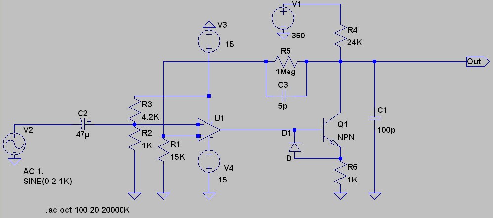

The problem is not LTSpice related , because i really built it.

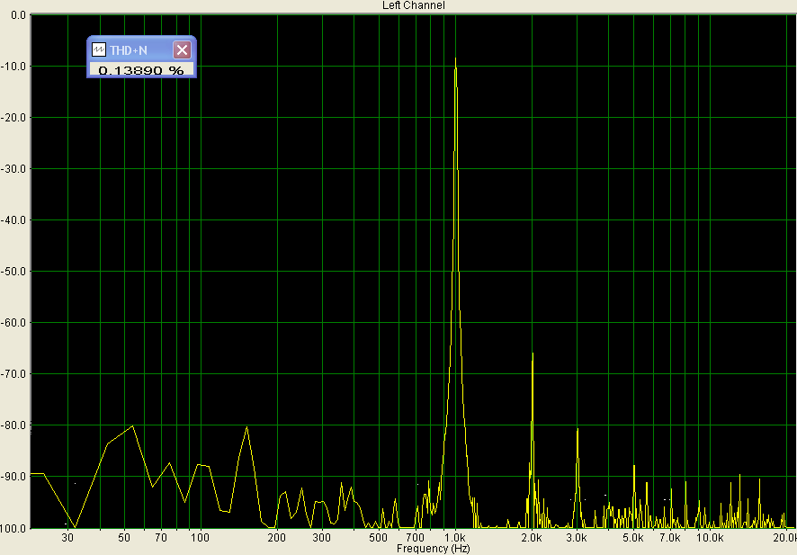

I used NE5532 for a driver IC with 2SC3866 transistor.Sound card was used as both oscilloscope and signal generator(it produces ~0.03% THD from output to input).
For measuring i used SpectraPLUS program.
THD+N was around 0.06% at 1 khz but ~0.2% at 5 khz and higher.
I have also tried generating square wave , but it wasn't even close to it at any frequency.Probably sound card is not capable of generating square too.
The little amp produced ~85Vrms until distortion started to rise quickly.

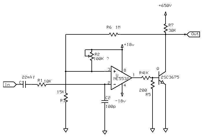

I have also found one interesting direct drive schematic at www.shackman.de .Unfortunately , its description is in german :(.
I could share it if you are interested.

it's hard to say what the 2sc3866 is is capable of distortion-wise,
op amp open loop gain is falling with increasing frequency and output Q Zcb nonliear current is rising too, the distortion rise isn't too suprizing
Resistor bias causes the Q to work harder, maybe a ccs would help
often higher bias current reduces distortion, may speed up output Q too
