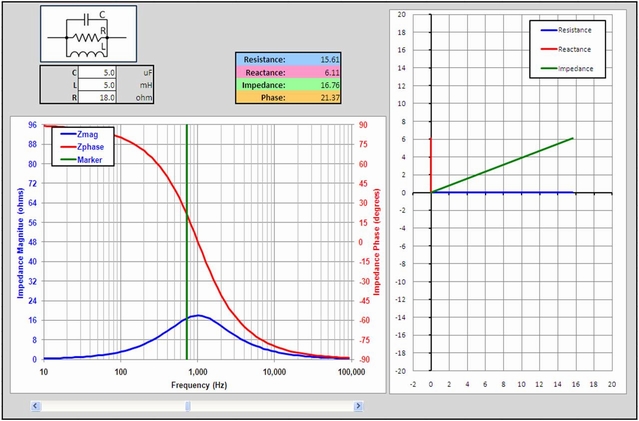

Attached is a *.zip file containing an Excel 2004 compatible and Excel 2007+ compatible impedance visualization spreadsheet for helping understand 4 simple circuit combinations.

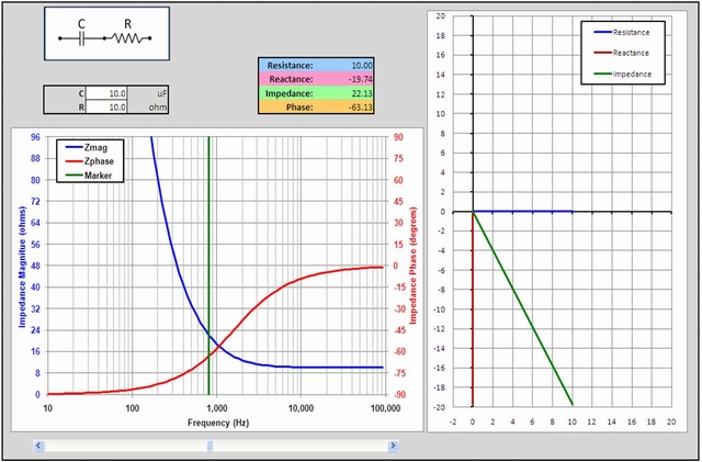

1) R and C in series: See pic#1
The spread sheet lets you enter values for R and C and plots the impedance magnitude and phase. There is also a slider bar at the bottom of the main plot that lets you move the green marker to select a particular frequency of interest. The values for resistance, reactance, impedance magnitude and phase are displayed in the colored table above the plot. Also, the vector diagram is plotted off to the right, showing resistance in blue along the X-axis, reactance in red along the Y-axis, and the resulting impedance in green. The phase is the angle between the blue and green lines.
It is quite interesting to scroll the marker along and watch the vector diagram change with frequency.
Note that for R and C in series, R dominates and sets the minimum impedance at high frequency; the phase approaches zero. At lower frequencies the reactance of C dominates and the phase angle approaches -90 degrees.
See pic#2 for the vector diagram at a lower frequency(set by moving the marker)

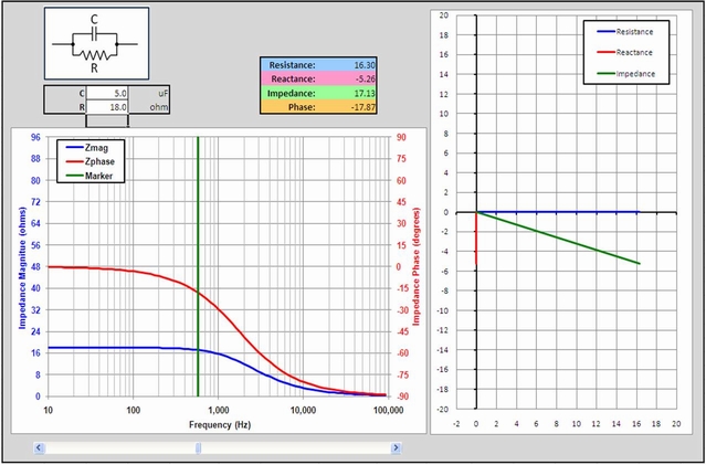

2) R and C in parallel: See pic#3
With this type of circuit, impedance at lower frequency is dominated by R which sets a maximum value for the impedance; phase approaches zero. At high frequencies, C dominates and the impedance approaches zero; phase approaches -90.
Combinations of resistance in series and parallel with a capacitor can be used to make the impedance more resistive(low phase angle) over the whole audio range.

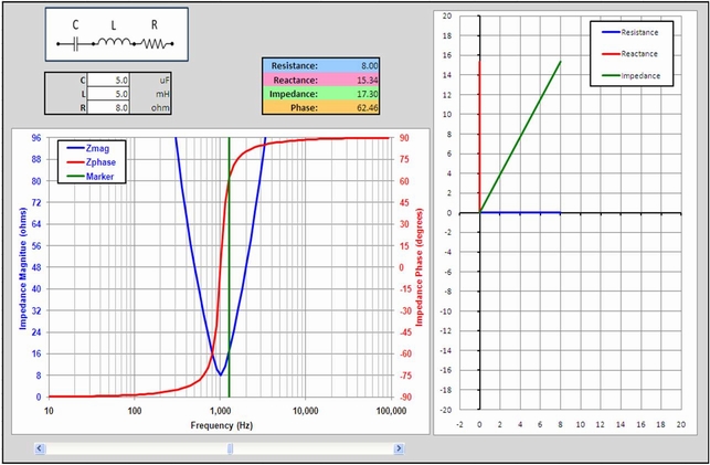

3) R, L, and C in series: See pic#4
This is a series resonant circuit. L and C determine the frequency of resonance. R determines the minimum value of impedance at resonance and the sharpness of the resonance. Impedance is capacitive below resonance(phase ~ -90deg), and inductive above resonance(phase ~ +90 deg).
4) R, L, and C in parallel: See pic#5
This is a parallel resonant circuit. L and C determine the frequency of resonance. R determines the maximum value of impedance at resonance and the sharpness of the resonance. Impedance is inductive below resonance(phase ~ +90deg), and capacitive above resonance(phase ~ -90 deg).
If people find this type of spreadsheet of interest, I also have one for a complete model of a transformer driven ESL taking into account transformer parasitics.
I almost forgot to mention that the spreadsheet does use complex variable functions, so you will need to load the Analysis Toolpak Addin before it will work properly.

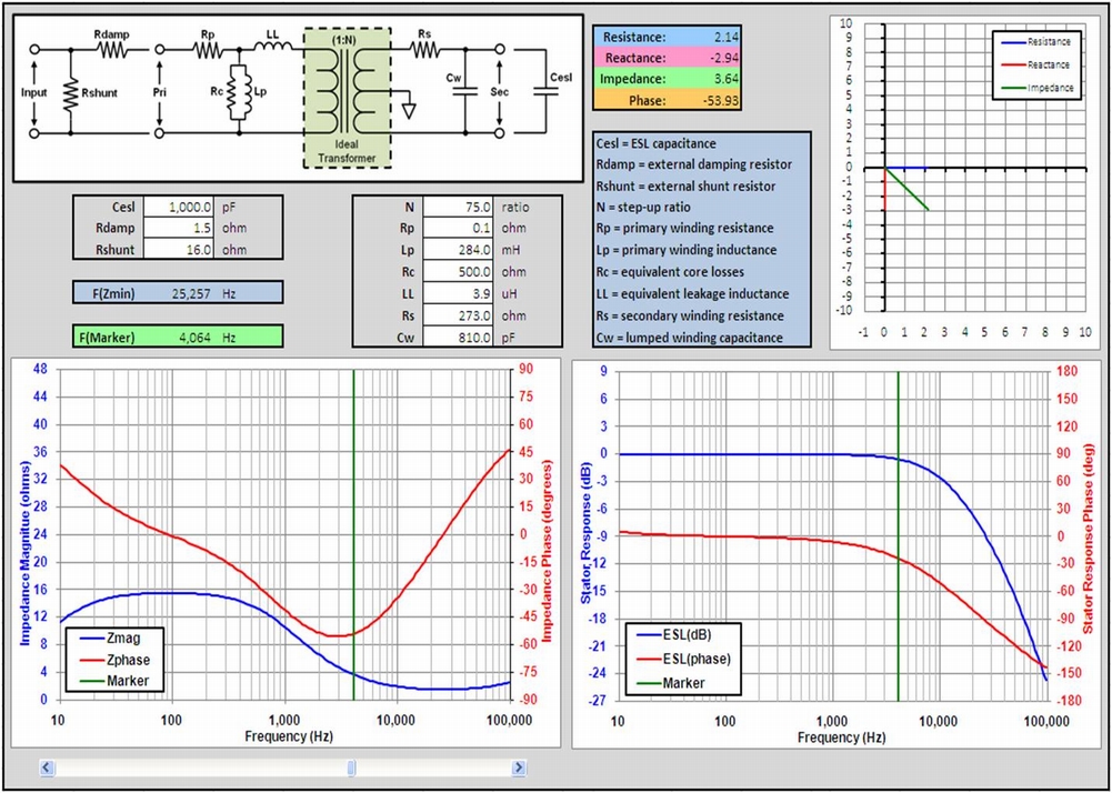

Attached is a *.zip file containing an Excel 2004 compatible and Excel 2007+ compatible spreadsheet for modeling impedance and response of an ESL connected to a step-up transformer. Also attached is the specification sheet for the Plitron 4314 transformer which I will post a couple sample calculations for.
Lower left plot shows impedance magnitude and phase.
Lower right plot shows normalized output response of voltage applied to ESL stators.
Upper right plot shows the impedance vector diagram for marker frequency.
Note that Rc(core losses) and Lp(primary inductance) are in reality a function of input voltage magnitude and frequency. In this spreadsheet they are constants. So not perfect modeling, but pretty good. Rc is not specified in the Plitron data. I estimated it at 500 ohm. This sets the peak magnitude of the impedance peak for the parallel resonance between Lp and (Cw + Cesl)*N^2.
Pic #1: Plitron 4314 with 1000pF ESL and recommended Rdamp = 0.8 ohm
You can see that the impedance and response match well with page 2 of the Plitron data sheet.
Pic #2: Plitron 4314 with 1000pF ESL and Rdamp = 0.2 ohm
The recommend value of 0.8 ohm gives you a maximally flat HF electrical response(stator voltages). If a lower value is chosen for Rdamp, the under-damped series resonance between LL and (Cw + Cesl)*N^2 causes a peak in the HF response. Also note that HF impedance drops and the phase angle gets even more negative (ie capacitive) in the top two octaves.
Pic #3: Plitron 4314 with 1000pF ESL and Rdamp = 1.5 ohm
If a higher value is chosen (Rdamp = 1.5 ohm) the HF electrical response droops a bit. But, since the native response of an ESL is a rising response (+3dB/oct for line source, +6dB/oct for point source) this is actually closer to the value needed for a flat acoustic response. Not that the minimum impedance has risen and the phase angle is reduced.
Pic #4: Plitron 4314 with 1000pF ESL and Rdamp = 1.5 ohm, Rshunt = 16 ohm
Adding a shunt resistance before Rdamp does not change the response. But, it does make the impedance load the amplifier sees more resistive. If used, this resistor would need to be able to dissipate considerable power/heat.
Like before, the spreadsheet does use complex variable functions, so you will need to load the Analysis Toolpak Addin before it will work properly.
