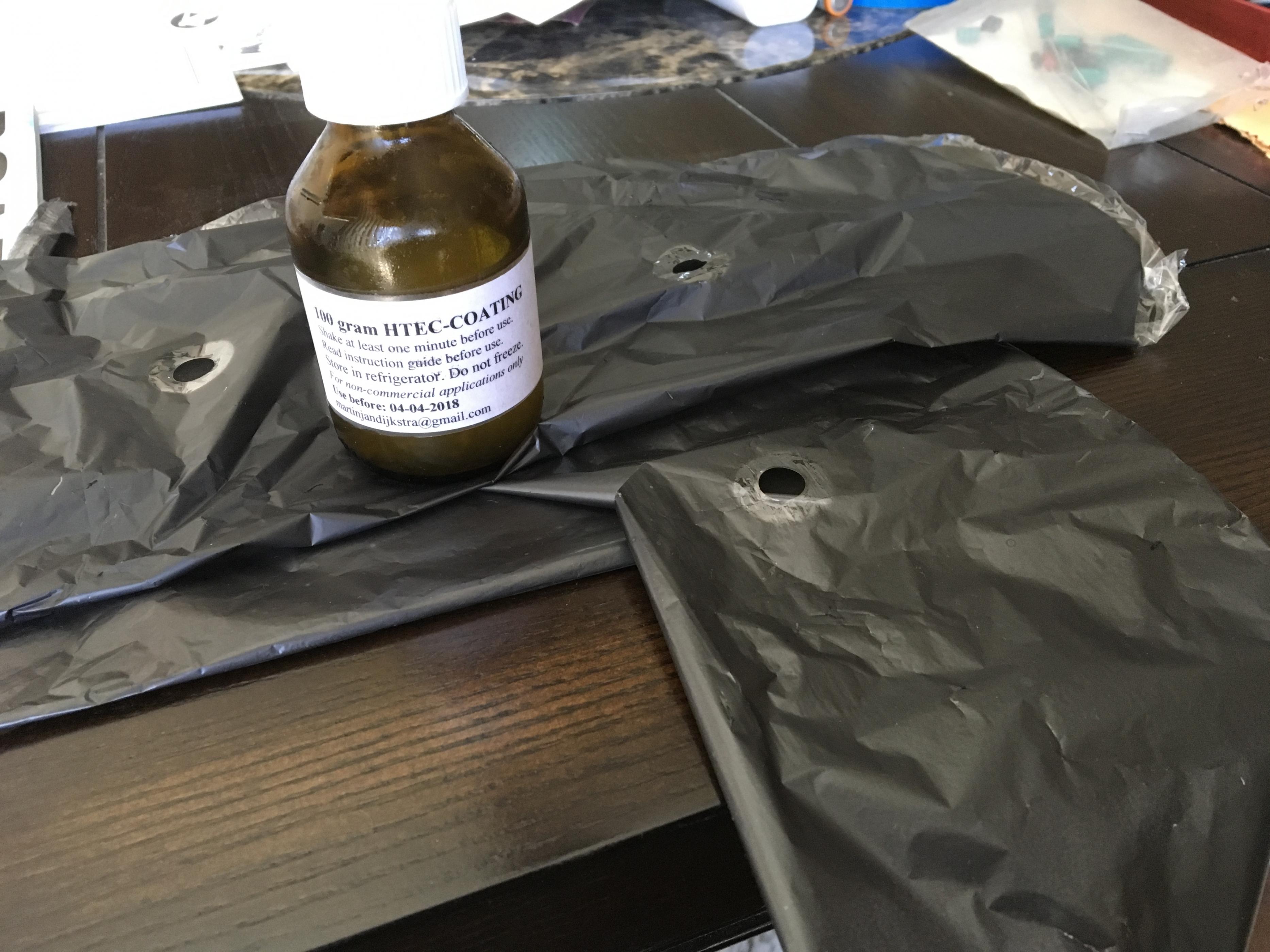

Hello Emmanuel,
I got coating right on stock. Due to a different formula it is called HTEC-coating instead of EC-coating.
The coating must be used within aprox. 5 months (storage in refrigerator) and the exact exp. date is printed on the bottle.
I dont know about the shelf-life of the ER-coating so you should contact them.
Martins coating worked perfectly on the 988 panels.

As written, coating is currently not available.
I have to make the coating from the individual components which makes it very time laborous. Due to the limited stability of the fluid system I have to make small batches as well which doesnt help.

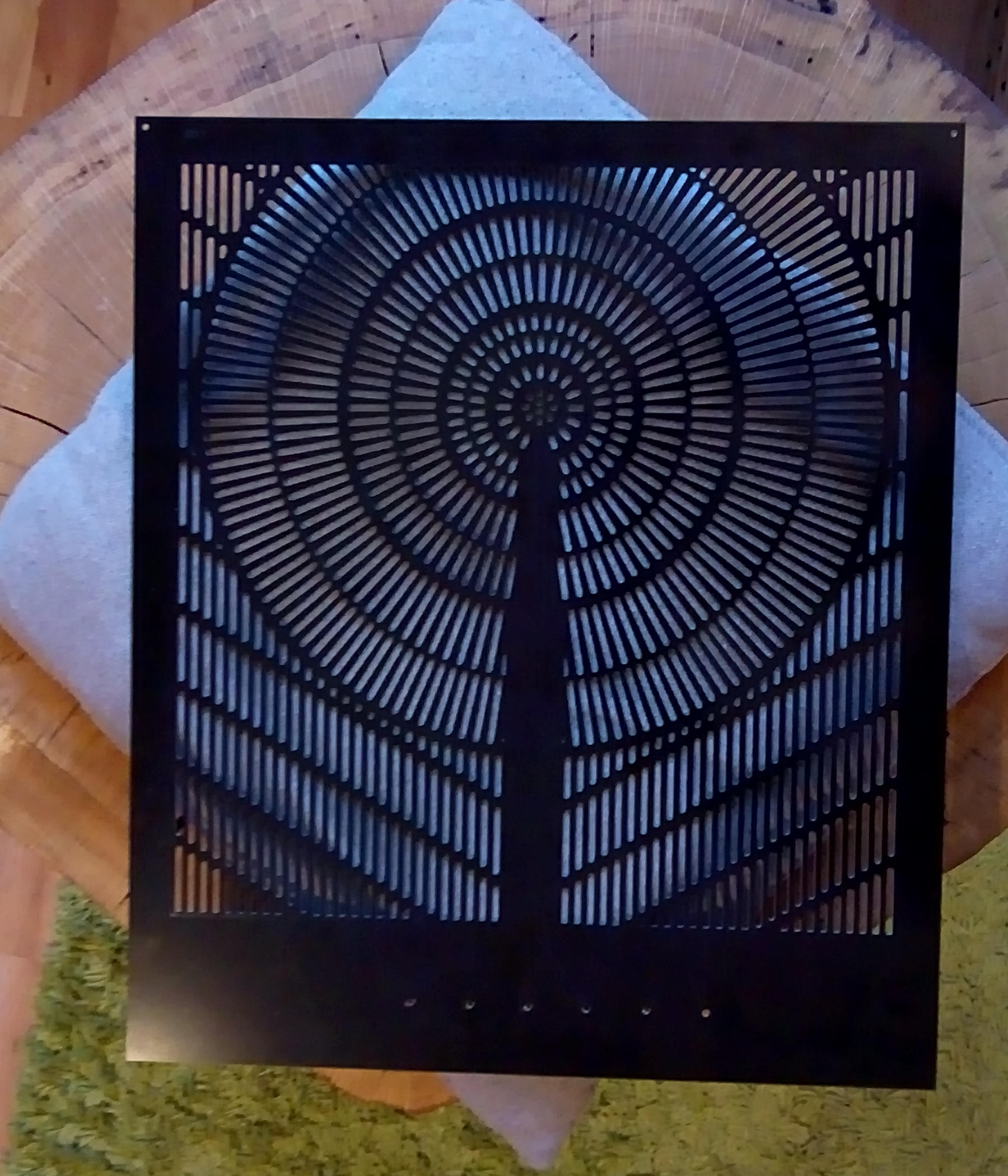

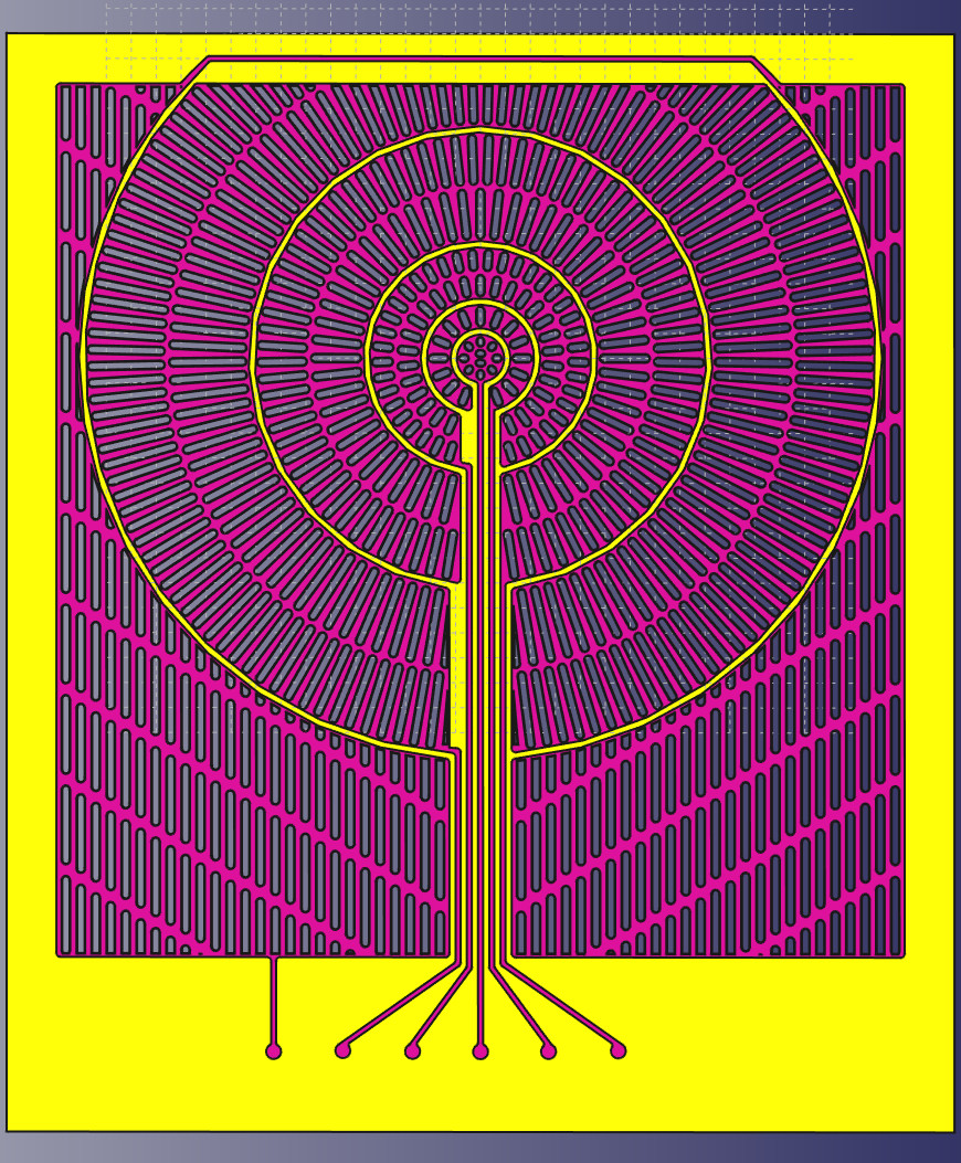

Dear diyAudio forum,
at the High-End Munich in 2016 I heard the electrostatic loudspeakers at the Helixir audio stand and was thoroughly impressed. I found CharlieM’s web-page that same evening and decided to attempt to build hybrid panels myself. At the time I had Markaudio Alpair 12p back loaded horn-reflex speakers. Knowing, that the electrostatic loudspeakers would be dipoles, I combined the Alpairs with some Peerless woofers (picture attached). Those speakers already sound pretty good and dispersed my last skepticism towards dipoles.
I’m now following up on the electrostatic top panels. My overarching design goal is constant dipolar directivity. I’ve designed the following pcb stators and had them fabricated. Most of the design is already planned out, but I’m still missing 6um mylar foil and the diaphragm coating to proceed with the prototype. From what I’ve gathered, MJ Dijkstras coating would be the preferred solution. He hasn’t yet responded to my PMs, therefore I’m trying to get his attention here. Also, does anyone have a better source for the mylar than the following ebay seller from taiwan? Electrostatic Speaker Membrane Dupont Mylar C 6um 40m for sale online | eBay
If someone wants to discuss the design or is interested in a build update in due time, then let me know.
Best regards,
Karl
