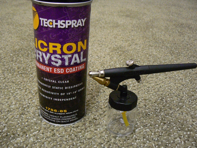

...I also just received a can of the newer version of the Licron spray from Techspray to try.
It is called Licron Crystal 1756. The original Licron spray was designated 1755. The specifications sheet says it is crystal clear with surface resistance in the 1e7-1e9 range.
The tech rep I spoke to on the phone said that this was a much improved formulation that adheres much better to plastics than the original. I mentioned the trouble I had with the orginal Licron coating flaking off of mylar after it was flexed and was told I shouldn't have any problems with the 1756. We shall see.
My plan is to use an air brush to apply it to improve uniformity and thinness of the application.
I am quite pleased with the results of applying Licron 1756 with an airbrush. It was quick and easy to get a thin, uniform, clear coating. It wet the Mylar perfectly; no bubbles or tendency to bead up. The instructions did say that the coating would only dry clear if the humidity was under 50% when applied.
The surface resistivity was quite consistent at 2E9 ohm/sq. on all of the test panels I coated. I tried applying the coating to one panel using the spray nozzle on the can and didn’t have any better luck getting a uniform coating than I did with the Licron 1755. Even though it was not uniform, the resistivity was about 10x higher with the 1756 compared to the 1755.
Durability is much improved with the 1756. The Licron 1755 had a tendency to flake off when the diaphragm was flexed/stretched. Also, just a gentle rubbing with a finger nail would remove the coating. The 1756 had none of these issues. I tried my best to abuse it with stretching the diaphragm, scraping it repeatedly with a finger nail and rubbing hard with cotton balls soaked in water and alcohol. The coating remained unchanged in appearance and resistivity.
I’ll be running some distortion tests this coming weekend to see if this resistivity will allow me to achieve my goal of <0.1% distortion down to 100 Hz for 90dB/1m.

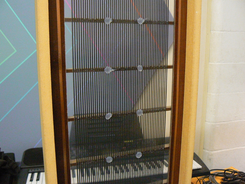

The stator in the pic showing the Licron 1756 coating was made using 18 gauge solid copper wire with 0.016" PVC insulation.
The OD of the PVC averages 0.074". I spaced the wires 7 to the inch resulting in 48% open area.

nice work !
Next time you should be more careful when squezzing in the silicondots. In the pictures some dots have noses. Those noses cause audible sound when running with e.g. 40 to 60 Hz sine test signals.
A design with silicone dots can drive you crazy for undesired noise.

I agree! This old panel has been religated to coating testing duties
The best panels I have made were constructed by applying the dots to the crossbars just before attaching the mylar.
They were much more uniform than when I used a syringe to to squeeze the silicone thru the wires after the diaphragm was attached.
What method do you suggest for applying the dots for least noise?
Is silicone the best material for this purpose?
My lastest panels are made without the dots for this reason.
Instead the panel is divided in to 3 vertical sections by 2 vertical strips of 1/4" wide phenolic. I do lose a small amount of radiating area compared to when I use the dots, but the operation in the low frequencies if very pure sounding with no extraneous noises.
