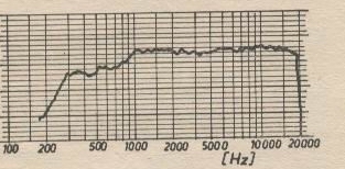

I´ve now here the article with all of the specs that is needed to built this unit, I´m not about to translate it and post it here, but you dont know the thickness, material of the diaphragm and manner of its attachment, and I think thats the key for undestanding this driver fully. As the second fact, the compression chambers are very small and as merhaut wrote the heavy pressure caused by the loading is spread across the chamber almost uniformly because of its very small volume, because of that parts of the diaphragm are moving in piston-like manner.
thats all, believe or not, but from the point of seeing the specs of merhautofon, I must repaeat : that ESL as a compression driver is not a bad idea, but you must know how to make it properly, because you must consider all the parts again, not only make a small panel in the same way like its bigger brothers ;)
Merhaut claims alot and obviously wrote something.
The question for me is simply: "Does it make sense? Or does it work like it is claimed?"
So far we have no proof at all and it seems like we won´t get it.
The patent at least leaves too many Qs open.
Aren´t there any graphs or measurements prooving the (superior?) functionality of the device?

only graph that is at this time avalaible is the frequency response, author says that the curve falls down on 20Khz only because they stop to measure it exactly, because they werent able to measure it on such high frequencies. This claim is confirmed by guys as I told you before that said that i has a good 20us pulse response, which indicates the frequency response of the driver is sufficient.
Merhaut discussed this large range of operating from a point of influences of the acoustical transformation, which is the main cause of that.
Sensitivity and other numbers arent avalaible because of that it is patented and patent was sold, nobody from year 1972 didnt manufacture another piece of this device But I dont know this surely. But as I know it was crossed with a driver aro835, and if i think a little about it, aro835 was very sensitive 15" driver, about 98dB/w/m, and if we consider the maximum avalaible power from an amplifier at that days, its sensitivity couldnt be so low, to couple aro835.
I think that one of good points of this design is that the capacitance of this panel will be much smaller than the free air device, so the resonance of the transformers stray inductance and capacitance of the panel will be at much more higher frequency. But even free air device can be good in this point of view.
I think one point in which will be this design clearly superior, will be a waterfall test. Sadly there arent any devices avalaible.
