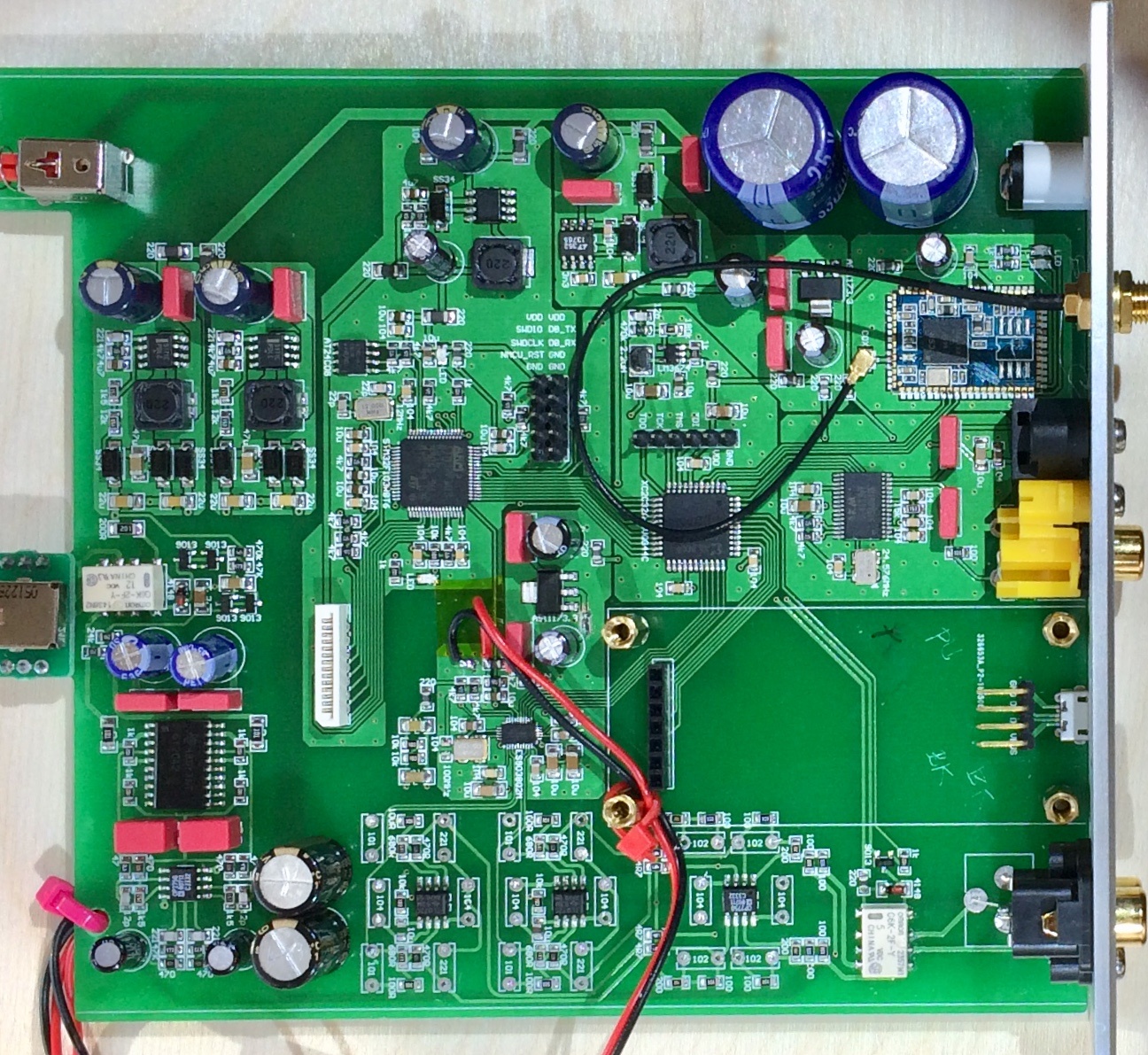

DVDD supply updated
The DVDD of 9038Q2M is supplied by an internal regulator from DVCC. The 4.7 uF XR5 decoupling capacitor (recommended by ES) is in place now. I removed the original cap close to the leg of DVDD pin (the original cap measured about 80 nF) and all the surroundig stuff. This simple tweak is highly recommended....
Regarding the DVDD cap, they say the reason for using 4.7uf is to make sure there is always at least 1uf there (presumably given that X5R capacitance varies a lot with temperature and voltage). Right now my board has a tantalum and a ceramic. Not sure if that is a problem since there is also an external regulator there too. Even without the external regulator, with the tantalum and ceramic together there is probably 1uf there all the time isn't there? Again, presumably the reason for a minimum of 1uf could be to assure stability of the internal regulator. They don't say a tantalum shouldn't be used in parallel with a smaller ceramic, a common approach for bypassing. Normally the reason for using an X5R, 6.3v cap is because of the small size, not because it is an especially good cap otherwise in almost any way.
Also, with an external regulator, the internal one is likely biased off. In that case what the internal regulator needs for stability might not be as important as what the external regulator needs.
In addition, in regard to the internal regulator I wonder if that was done primarily to make it more competitive for cell phone usage? Having to add an extra power supply next to the dac chip in a cell phone might be a deal killer.
Anyway, to cut to the chase may I ask if you noticed any sound difference after removing the tantalum and existing ceramic and installing the new cap?

With the digital decoupling it seems that the lowest esl wins, have used a .1uf cog, and either 4.7, or 10uf x7r, x5r nearby.
That was better than a 22uf tantalum with a .1uf x7r.
The tant isn’t low enough esr at a high enough frequency it seems either.
Also tried the same tant on a cheapo ams1117 regulator, and a standard 100uf nichicon was heaps better.
Not sure how a cog would interact, or not with an onboard/chip capacitor on the ess, however.
If the ESR is too low sometimes it can cause oscillations, say, if used to decouple some fast opamp power pins. If the manufacturer recommends a tantalum and X7R in combination, there may be a very good reason for it. Sometimes they will even say to put a small resistor in series with an X7R.
Putting a film or a C0G cap a little further away might be fine too, if it improves power quality to good effect while maintaining stability, that is what we want.
The tant isn’t low enough esr at a high enough frequency it seems either .
Agree and the replacemant is listenable. The manufacturer recommended X5R to decaoupling the DVDDD and did their measurements with 4.7 uF X5R as well. The tant cap is simply not good enough there.

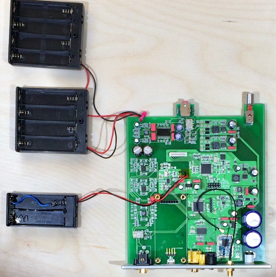

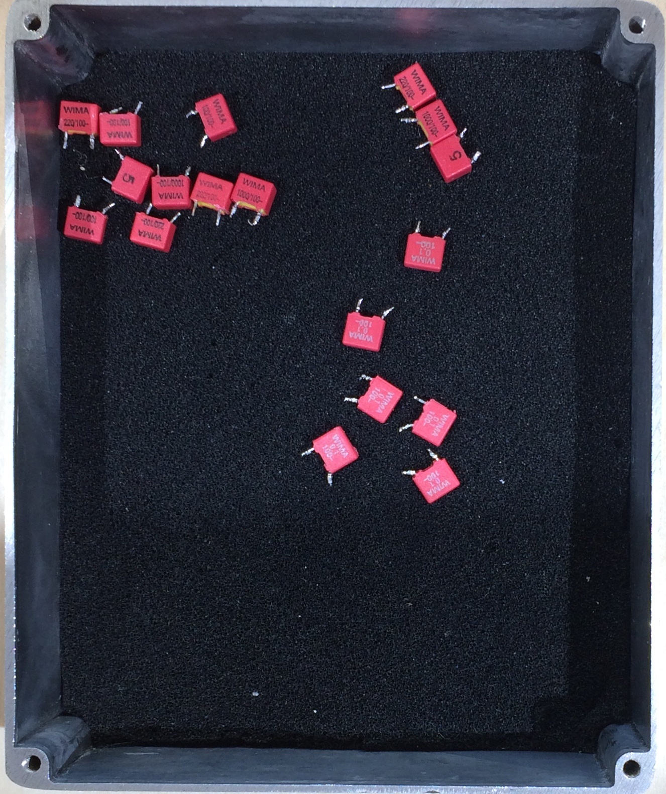

Update on the new ES9038Q2M DAC: Decided to find out if the sound quality problems mostly have to do with the switching power supplies. Tried running IV output stage and AVCC from LiFePO4 batteries. Better, but still not right and not close enough to right either. So... out come the caps and the opamps will be next. Will rebuild IV output to ESS recommendations and try again with batteries. Pics below for viewing enjoyment.
Note: the removed-parts-box is lined with anti-static foam. Keeps parts safe until i figure out what to do with them.

Cheap, easy, best allow for many possibilities. Many people here will tell you that you need to do multiple things for best power results. On the board itself the local power supplies could use some fixing. For external power it depends on how much you want to spend and how far you want to go with making the board sound better. The minimum would probably be a +-15v dual rail supply regulated with LM317 and LM337 3-pin regulators. You would need maybe 150mA for the positive rail and maybe not more than 50mA for the negative rail. More current capacity won't hurt of course, but those might serve as reasonable minimums.
If you want a better supply you might consider using a power supply as I mentioned above as a pre-regulator, maybe adjusted up to +-18v, and then use higher performance post-regulators.
Unfortunately, it turns out that DAC chips that can perform at near state of the art sound quality levels require very careful care and feeding. The DAC chip itself is probably the least of the expense and the least problem to achieving very high quality sound. If you feel some skepticism about that you are surely not alone. People often start out skeptical and only find out once they try a few upgrades and fixes what a difference it can make. I'm sure there are other people here who could tell you about their own journeys.
Certainly, achieving measured results ESS claims are possible for the ES9038Q2M chip can be done (-120dB distortion and -122dB noise), but it is not trivial to do.
