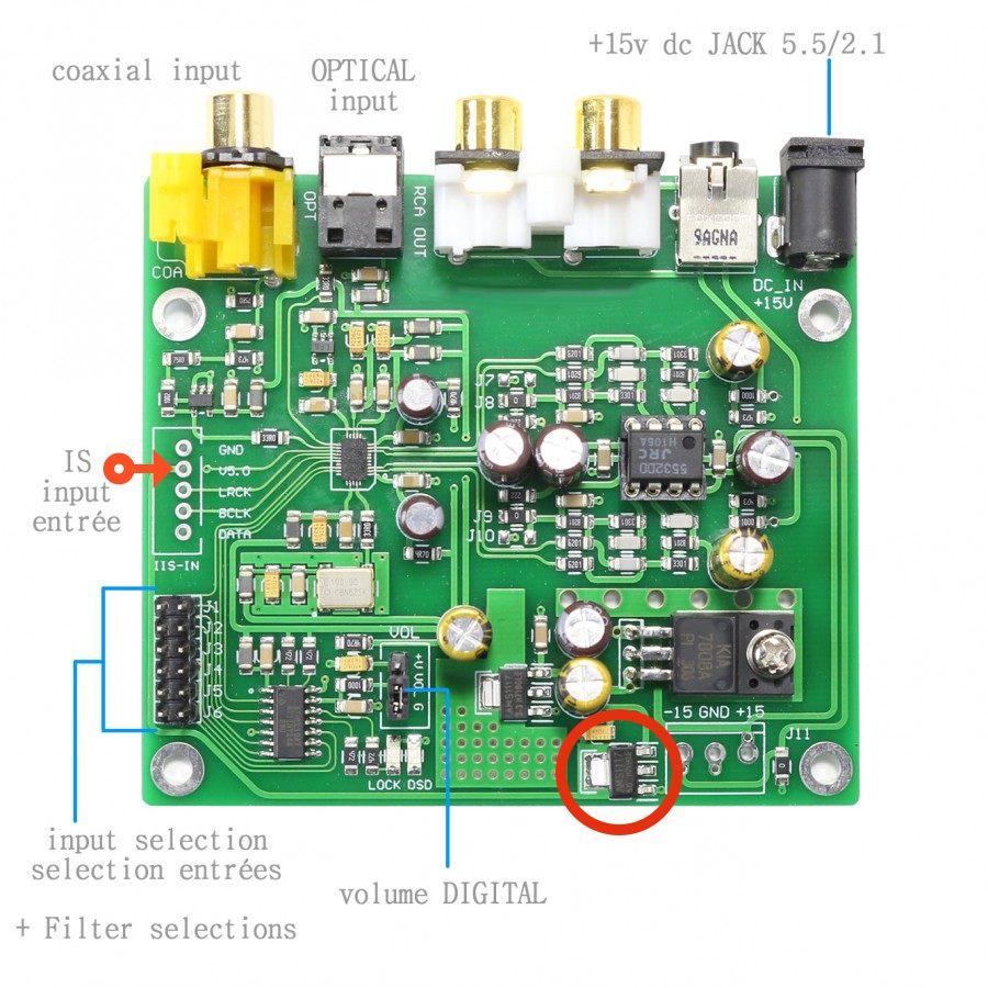

Well I got one of those 1.04 boards.
Powered it with a 317/337 regulator and it sounded pretty good.
Then I took out an old Preregulated Sulzer I had lying around and removed the 7808 and fed the Dual 15 off the Sulzer and 8 V out of the 317. Then the sound improved immensely.
Next I changed the 5532 to the LME4972 and got more detail and refinement but it lost some dynamics but the tradeoff was worth it in the higher frequencies for sure..much more detail.
I was quite surprised at this board. I had been thinking of getting a decent DAC but this might do the trick. Does it get much better than this? I need to know before dropping more money on the better DACs.

On the new 1.06 board i see the i2s input has a pad for V5.0. I dont think i saw that on the 1.04 board. What is that for?
BR Daniel
It may be to power the USB > I2S board, as an option to powering it from the USB port it is being fed from.
I think that pad is unused on this board, but is foreseen for this second board that has another regulator on it.On the new 1.06 board i see the i2s input has a pad for V5.0. I dont think i saw that on the 1.04 board. What is that for?
BR Daniel

I will try to disconnect DAC onboard 7808 regulator and will place (connect) LT3042 regulator board 15V/8V to see if his low noise out voltage will improve SQ...
I think that AMS1117 3.3V regulator are more important to SQ of ES chip......I will try to disconnect DAC onboard 7808 regulator and will place (connect) LT3042 regulator board 15V/8V to see if his low noise out voltage will improve SQ...

Hello, i will try this one onto 8V from 15V instead onboard 7808Hi,
What better regulator are you going to try?
LT3045-S Ultralow-noise (0.8mVrms) LDO linear regulator 0V-15V - 500mA Fixed out | eBay
