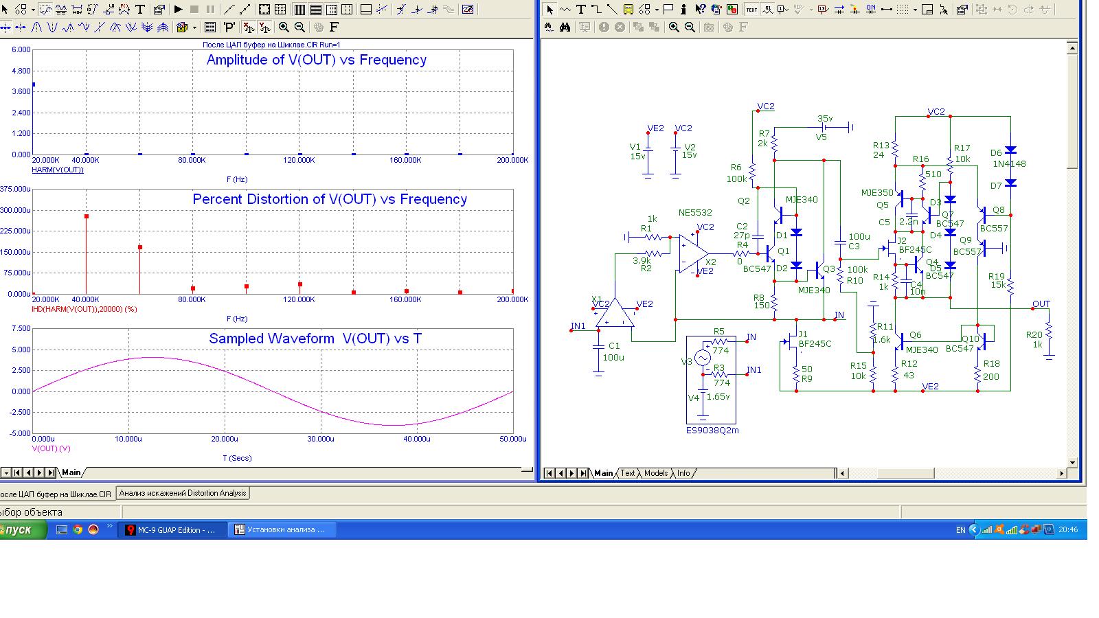

I to V converter without GNFB. Sorry, I do not use LT-spice.
No global feedback maybe, but certainly *lots* of local negative feedback. If it sounds good, probably not because of the reasons attributed to it.

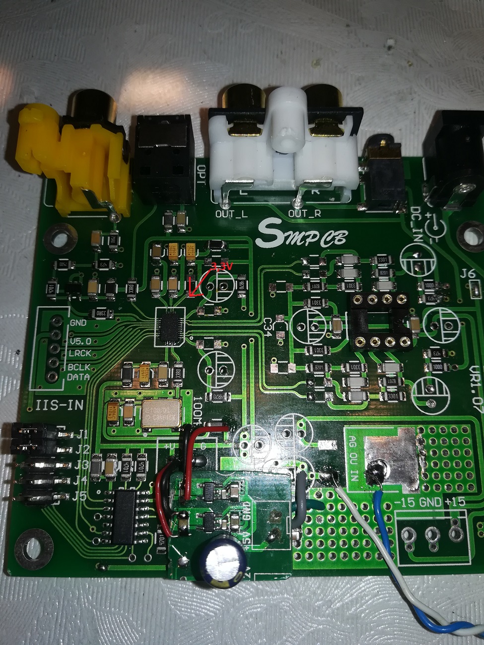

Been doing some more trying and testing here. Currently have the 5v on an external supply and all the power supplies are floating from earth ground, so there is only one earth ground at the moment that comes through one USB connector.
As is happens, there is a wireless phone it the house and it is a DECT system and the base station is about 10ft away from where I am testing the DAC. The DAC sounds better with the phone base station power plug disconnected. I can see some spurs go away in the FFT spectrum too when that happens. Not being in a case, the exposed LME49720's are sensitive to RF. Nothing new there, they are known to be sensitive in that way. It is just that it is more of a problem in terms of audibility than I previously expected.
So far so good. So, decided to try a couple more experiments. At the moment the DAC is sandwiched top and bottom between some thick aluminum plates, with some thinner plates shielding the sides. Sounds better, less distorted. Similar effect to turning off the DECT phone base station. Haven't checked but probably even fewer and lower level FFT spurs.
Also, tried sticking a small heat sink on the differential stage opamp. Cut off one end of a heat sink for 14-pin ICs to make it fit although its still a little longer than the op amp. Stuck it on with some thermally conductive tape. It is okay to the touch now.
Think I will try rigging heat sinks to the IV opamps and see what happens there.
Right now the sound is very clear and detailed. It could not be as detailed if there were any appreciable distortion. I tried playing the first song on the Steely Dan Aja album from CD but upsampled to 24/192, which I happen to be familiar with (production-wise). I can distinctly hear the individual voices of the back up singers, and when the high hat cymbal is struck it sounds distinct and very different from the ride or the crash. Lots of little details are there very similar to what the same song sounds like on the Benchmark DAC-3. Individual sounds are close to as distinct as they are on DAC-3. One doesn't have to expend effort to make them out, they are just there. (Perhaps if someone never heard something like that before they could have no way of knowing just how much information is actually encoded on a CD.)
I am starting to wonder if I just put some heat sinks on the IV op amps, and started hooking the power supplies back up normally, what would happen. In other words, I think it is fine aside from remaining IV op amp heat. It will need a sturdy, probably not-too-thin steel case, maybe similar to DAC-3 and careful attention to making sure it is an effective RF shield.
Then if it passes measurements and listening tests I think I could call it finished and done. If. Otherwise more work to do.

I also started to redesign es9038q2m board.
I will totaly split the supply so 5..6 or 7 regulators will be used.
I found one problem ...or not ...i want to splitt supply lines on both sides of dac and AVCC, but after disconnecting pin 12 VCC 3.3V the voltage is still present on that pin. Can be that it is connected with pin 27? in that case i can not use 2 different regulators for that 2 pins.
Can anybody test if dac plays normally if it is disconnected smd beard that is connected at that pin. I think it is not ok that 2 pins are supplied from both sides of dac with same supply line.
My idea... lt1085-5v for display and 5v pin that will feed i2s isolator. First 3,3v LDO for pin 27, second LDO 3,3V for clock, third regulator 3,3 LDO for DVCCpin 13, forth 3,3v LDO for VCC pin 12...if it is connected than not, fifth and sixth LDO for AVCCleft and AVCC right. All six are connected to TPS7A4700 5v preregulator that has best pulse noise, and low noise and qite ok current 1A. Output stage transformer output maybe with B1buffer at output, because i will connect it direct to power amp. Using digital volume.

looking on androa76 board V1.07 I see some ground traces between the i2s input lines I dont have on my v 1.04 board. would it be a good idea to stick some grounded copper film over the traces to shield them from top side? same might help on all digital (and analog) psu and signal paths?
One has to be careful with shielding and grounding. Adding a shield to something adds some capacitance that was not there before. There are mirror currents that flow in a shield if there is a return path somewhere for the mirror currents to circulate. If circulating in a return path, the currents can couple with other circuitry there.
That doesn't mean we shouldn't ground and shield of course, it just means that such things do not happen in isolation. If one shields when there was no need, it could create a new problem somewhere else.
The above kind of effects can be significant when dealing with sensitive circuitry or when power levels are high and circulating currents are large.
So, my perspective would be that experiments are probably okay, but if there is not a specific problem we are trying to fix or if an experiment does not produce a clearly beneficial result, then maybe better to stick with, or revert to the original circuit. Just could be the original designer had some good reason for doing what they did other than just to be cheap as possible.
There may be some exceptions to my above perspective, say if a designer was clearly trying to save money by skimping on quality components or not following well established practices for things like power bypassing in well understood circuits, etc., then it may not be unreasonable to decide there are problems based on simple inspection. However, if you notice a new problem soon thereafter, one of the first places to look would be at anything you touched or changed. I have seen cases where someone touched something they didn't even know they touched and it ended up being the source of a new problem. Just saying.

9028 Pro current requirements
Yes, I put an ES9028Pro on my Buffalo III | Dimdim's Blog
ES9028Pro power wows | Dimdim's Blog
op amps won't cut it for the 9028pro.

one can alway boost an op amp with a transistor or with an IC buffer. however I agree, it makes more sense to make a decent reg. at the moment for me the question still is monolith or discrete. LDO implementation appears not so simple at all. as discussed elsewhere, surrounding component type and quality may matter even more than their nominal values, and boost the price of such circuit significantly. the discrete reg appears to be more appropriate at the moment, but I think I have to find a better voltage reference than TL431 (which btw internally is a shunt regulator). and more importantly find out the best way how to minimise load transition effects on the reg. for the latest I need first to measure them, what is a task itself.
