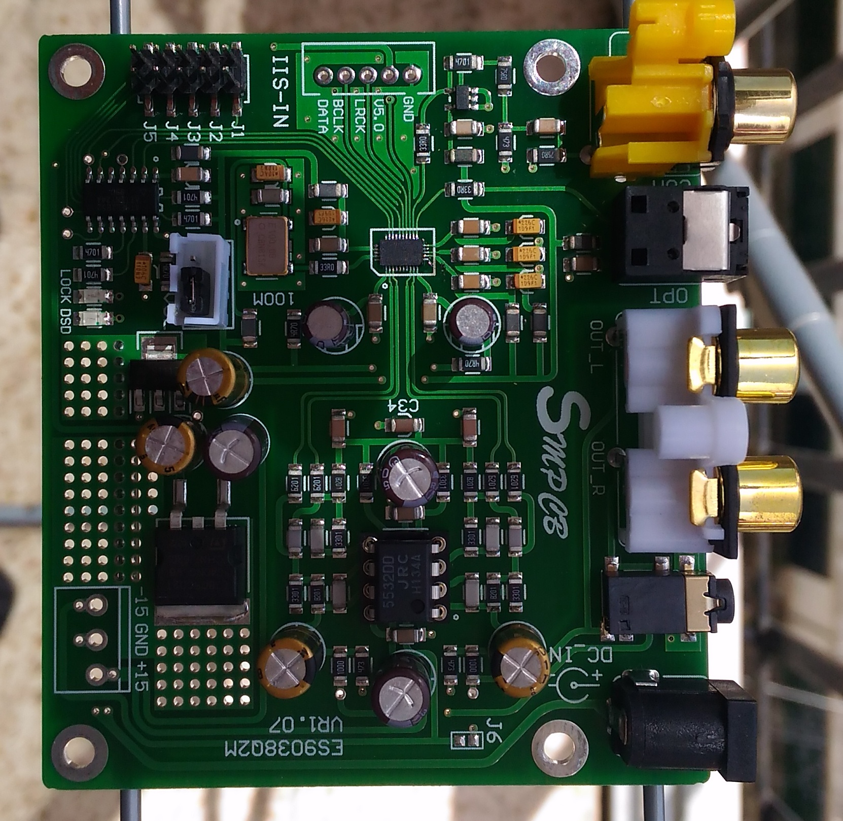

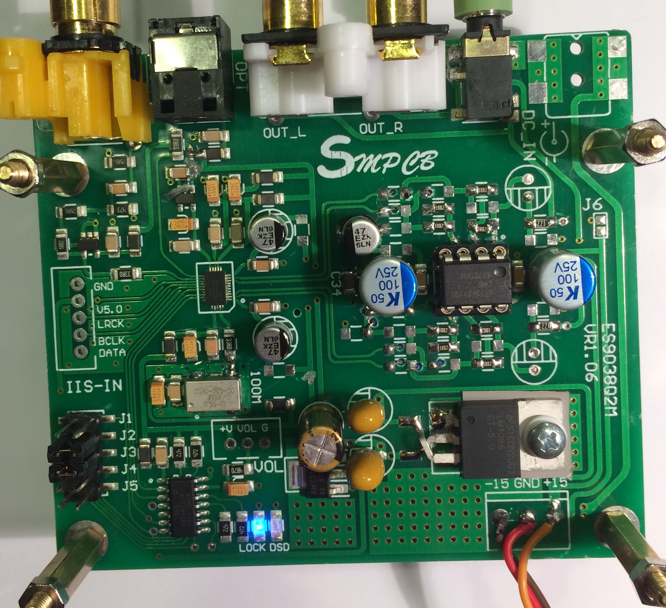

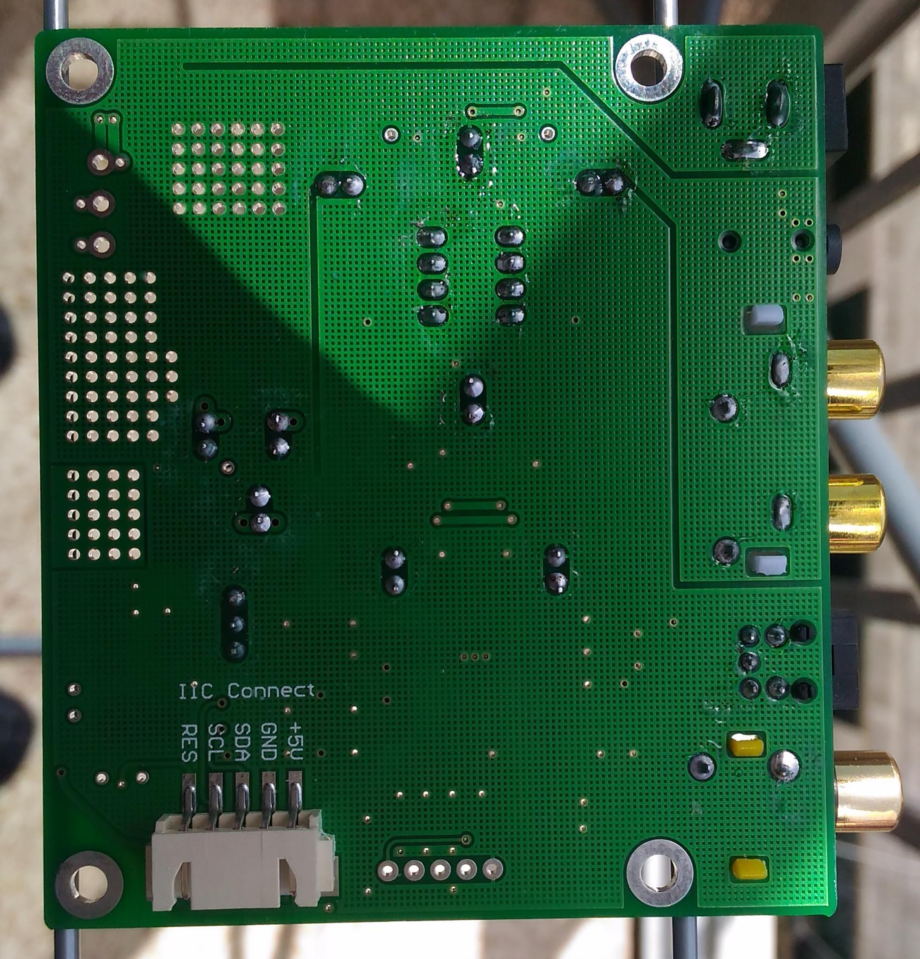

I own a blue pcb version that works, sound flat (as user sbf2 said on post 162), and come without 1.2v regulator from factory, same with a different blue version of a friend, looking to the chinese seller pictures seems that v1.07 is build in the same way, that is why I´ve asked, looks odd...
Just received my board and its Ver1.07. and I can confirm that the 1.2v reg is missing as borlix reports.
Is it an improvement or a cost cutting exercise?
Regarding the regulator, have you measured the voltage there? If it looks right it probably is right, is all I can say. Still don't know why some boards had regulators and some not. Perhaps information or advice from ESS has changed over time, but that is entirely speculation on my part.

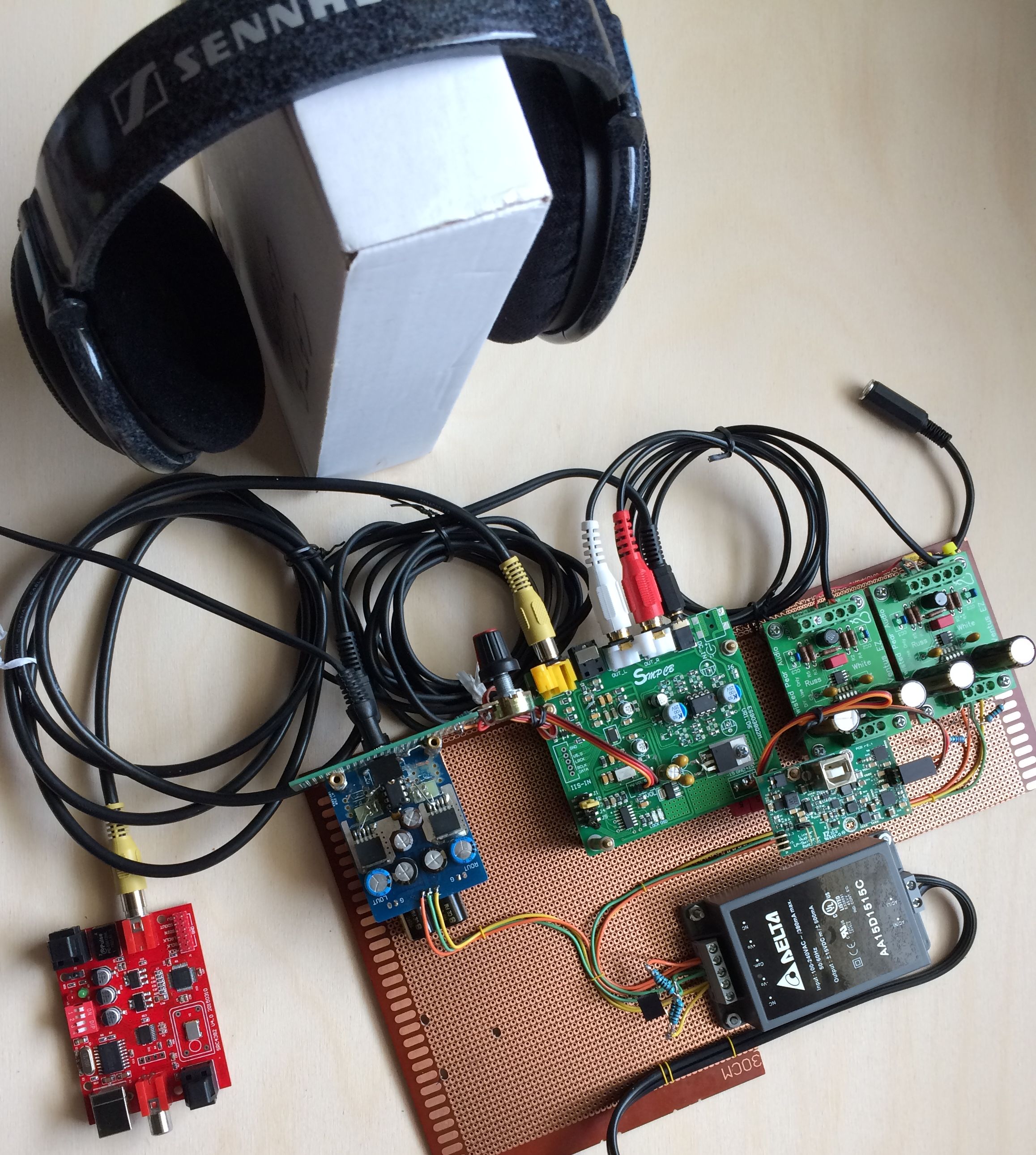

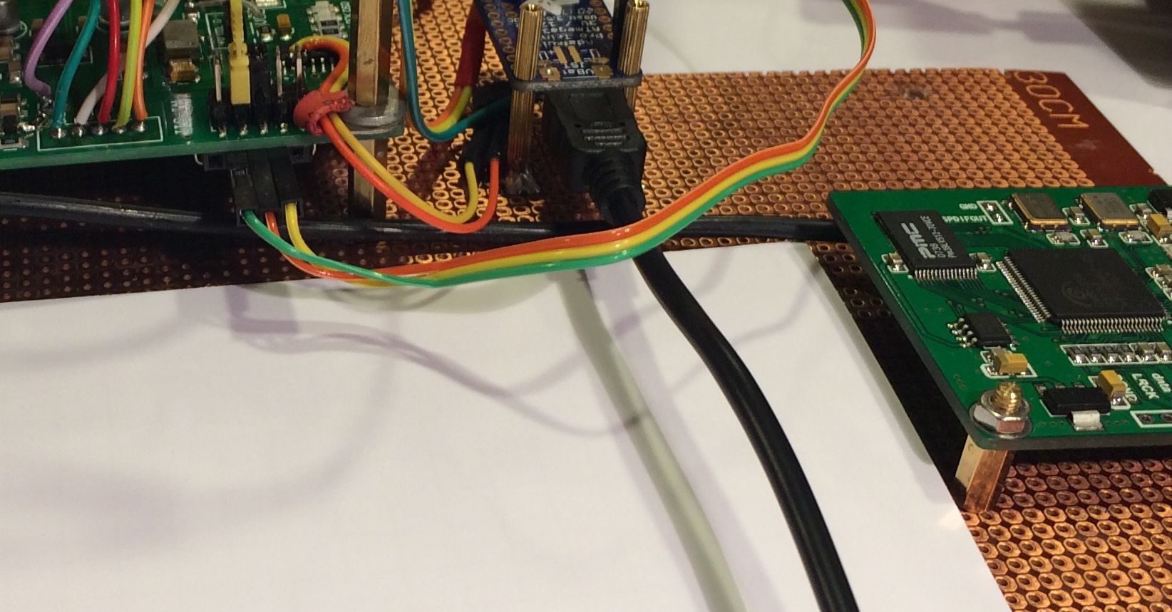

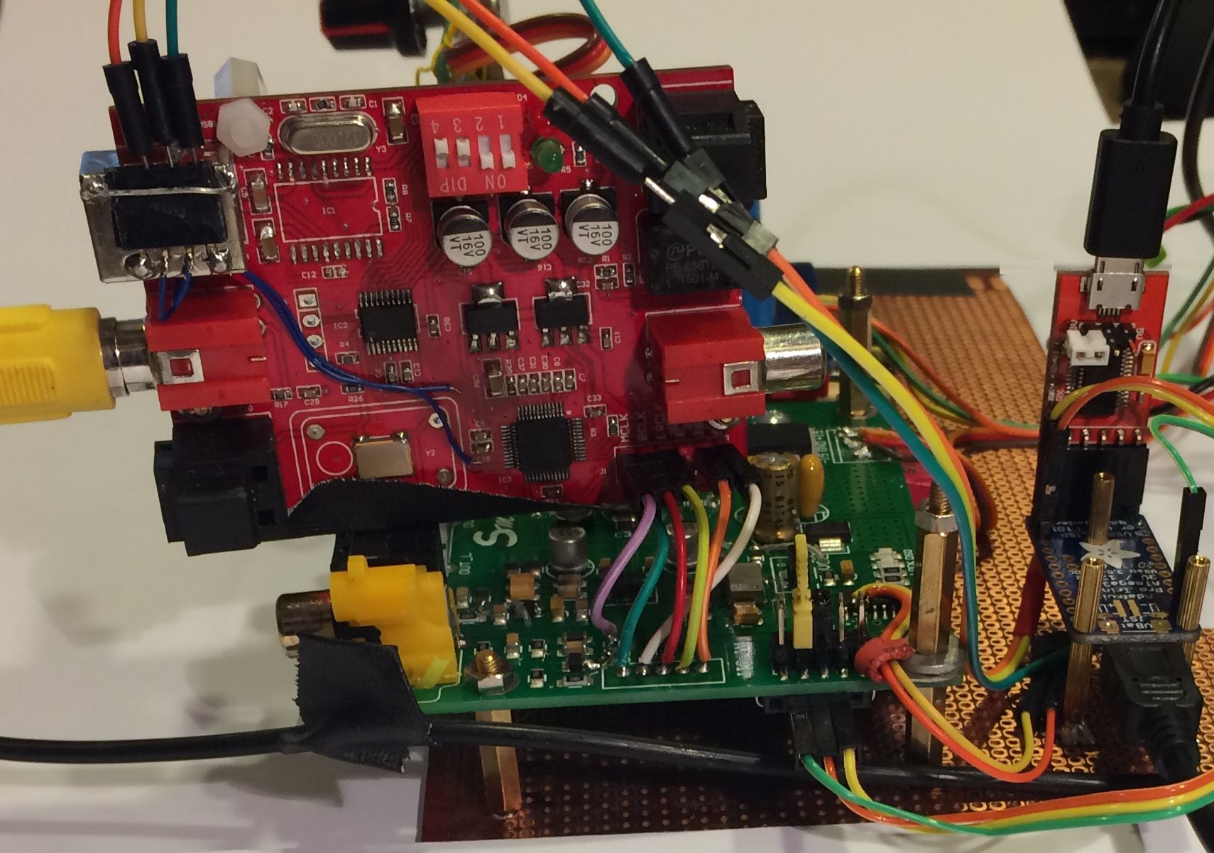

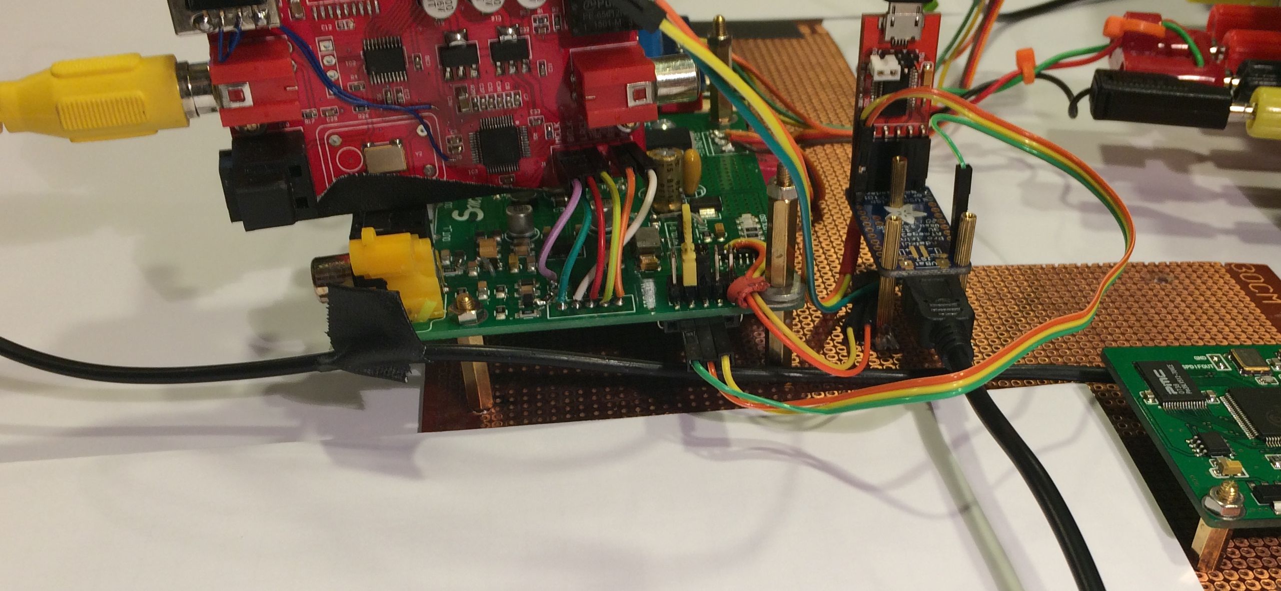

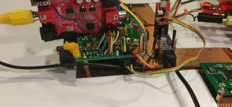

In the meantime, I seem to keep revising my approach as to how to go about setting up for work on master mode I2S. I think I will use one Arduino for both boards, SRC and DAC, since both use different I2S addresses.

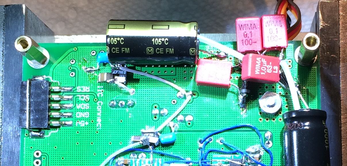

Although I said there would be no pin lifting to modify the SRC board, when it came time for me to start working on it I did lift some pins on the microcontroller. Also had to rewire and temporarily disable SPDIF on the DAC board. I needed to get to another signal down in there somewhere.
Right now things are pretty much wired up for test, and register programming for the SRC has completed a first pass. Register programming for the DAC is next. A few pictures of the wiring are posted below. It can be seen where 30 AWG wire wrap wire has been attached to the I2S lines for the SRC chip. They go up to a connector where the I2S bus from the Arduino can be plugged in.
The board on the far right is an Arduino Pro Trinket 3.3v with a FTDI card attached to it vertically. The FTDI board allows real time terminal access to the running Arduino program.

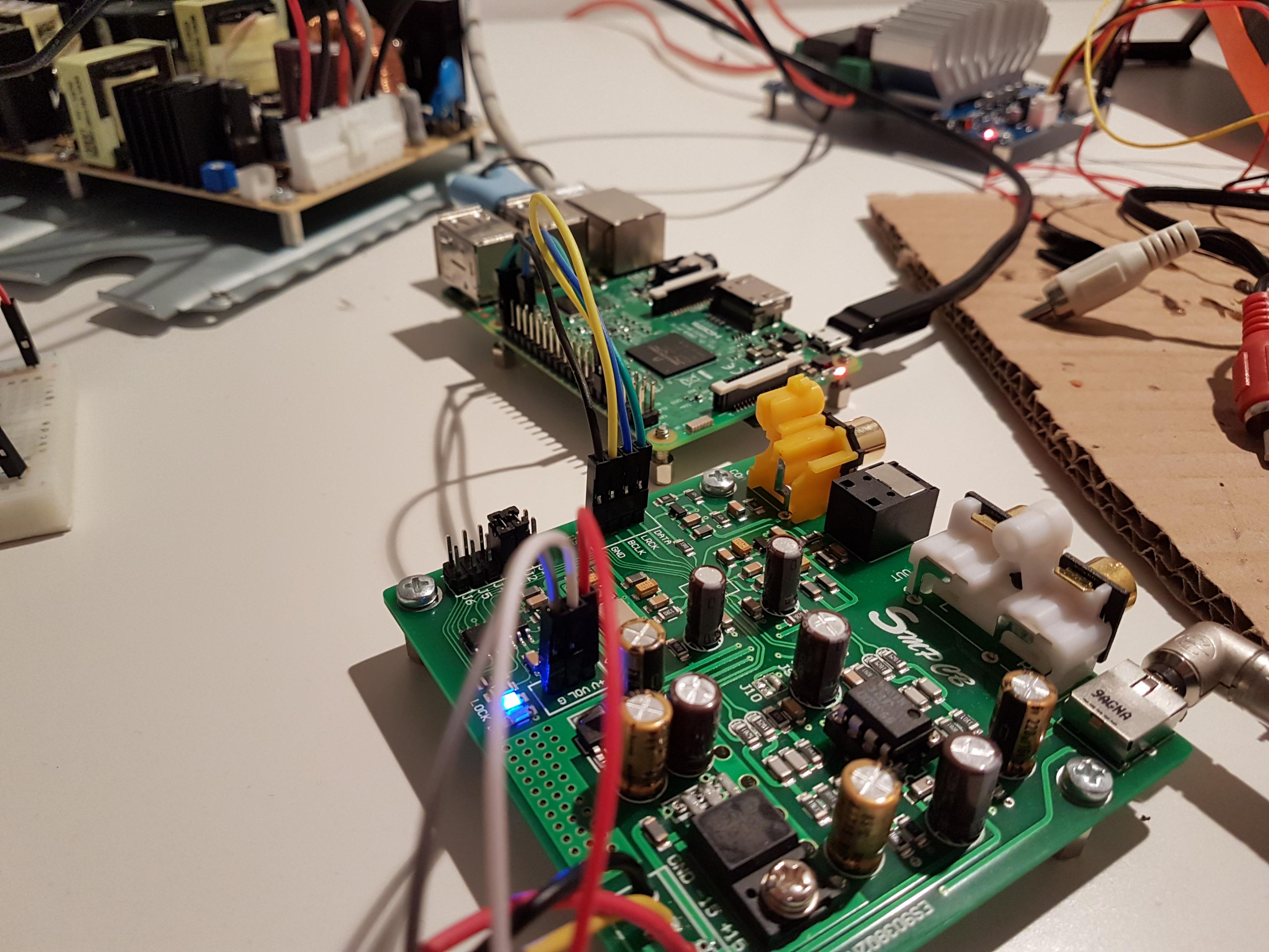

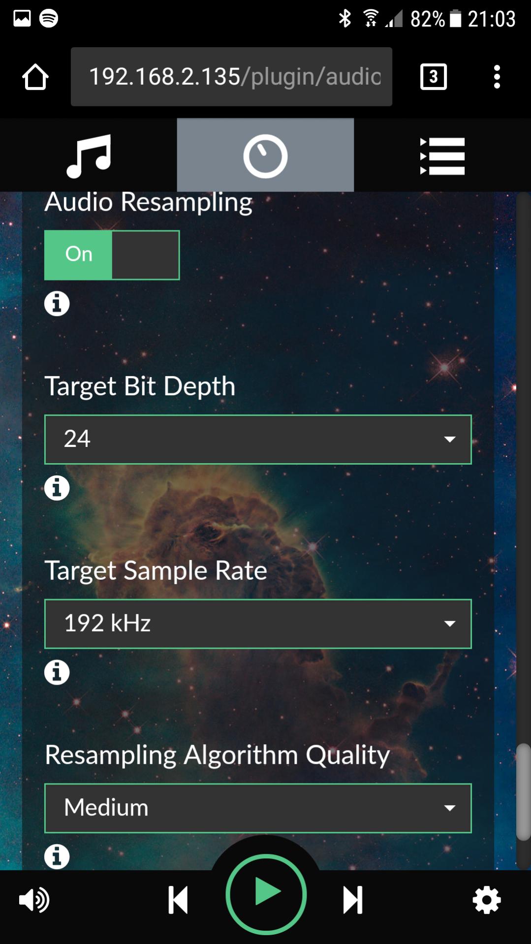

Regarding 16-bit operation, no problem here with Windows. How is the DAC board connected to the Rasberry Pi3? Using SPDIF, I2S, TOSLINK?
Most likely there is some problem with the interface formatting. Left or right justified, frame size, etc.

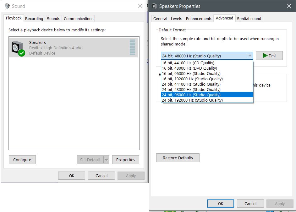

Regarding Spotify in particular, the DAC only supports PCM or DSD. There is no MP3 decoder, the computer OS has to do that. Spotify mp3 bitrates are very low, 128kbps, IIRC. The PCM sample rate might only be 22kHz, 11kHz or something like that, which maybe is lower than the DAC supports.
Windows and most OS'es will resample the default sound device audio stream to some common sample rate that can be user configured. They do that so that multiple audio streams can play at once, such as system sounds like mouse clicks, alarms, notifications, etc., playing at the same time while music is playing. Therefore they may send the DAC a standard format it knows how to play.
Rasberry Pi3 OS may not do that, probably not since it takes some computing power to do the SRC in real time even if not all that high quality.
Markw4, thanks for reply. I connected Raspberry pi 3 via I2S directly. I try to find, why is 16 bit unsupported. Unfortunately I have no equipmet for scan I2S. Maybe I try use arduino like signal generator for I2S. Markw4, How is your DAC board connected to the PC? Are you tried play music with setting like 16bit/44100Hz or 16bit/192000Hz? Works it? Maybe is bug only in I2S and spdif is ok?
My opinion is, Volumio have decoders for diffrent audio formats (mp3, flac, spotify, ...). But decoded output is send directly to DAC. There is no default resampling like on Windows. If user want, he or she must explitic enable it. Mp3 decoder decode to 24bit? Flac is decoded as is. Spotify is a plugin and volumio don't apply resampling on it. It make me sense from my tests. Resampling off - mp3 OK, 16bit flac FAIL, spotify FAIL. Resampling on - mp3 OK, 16bit flac OK, spotify FAIL.

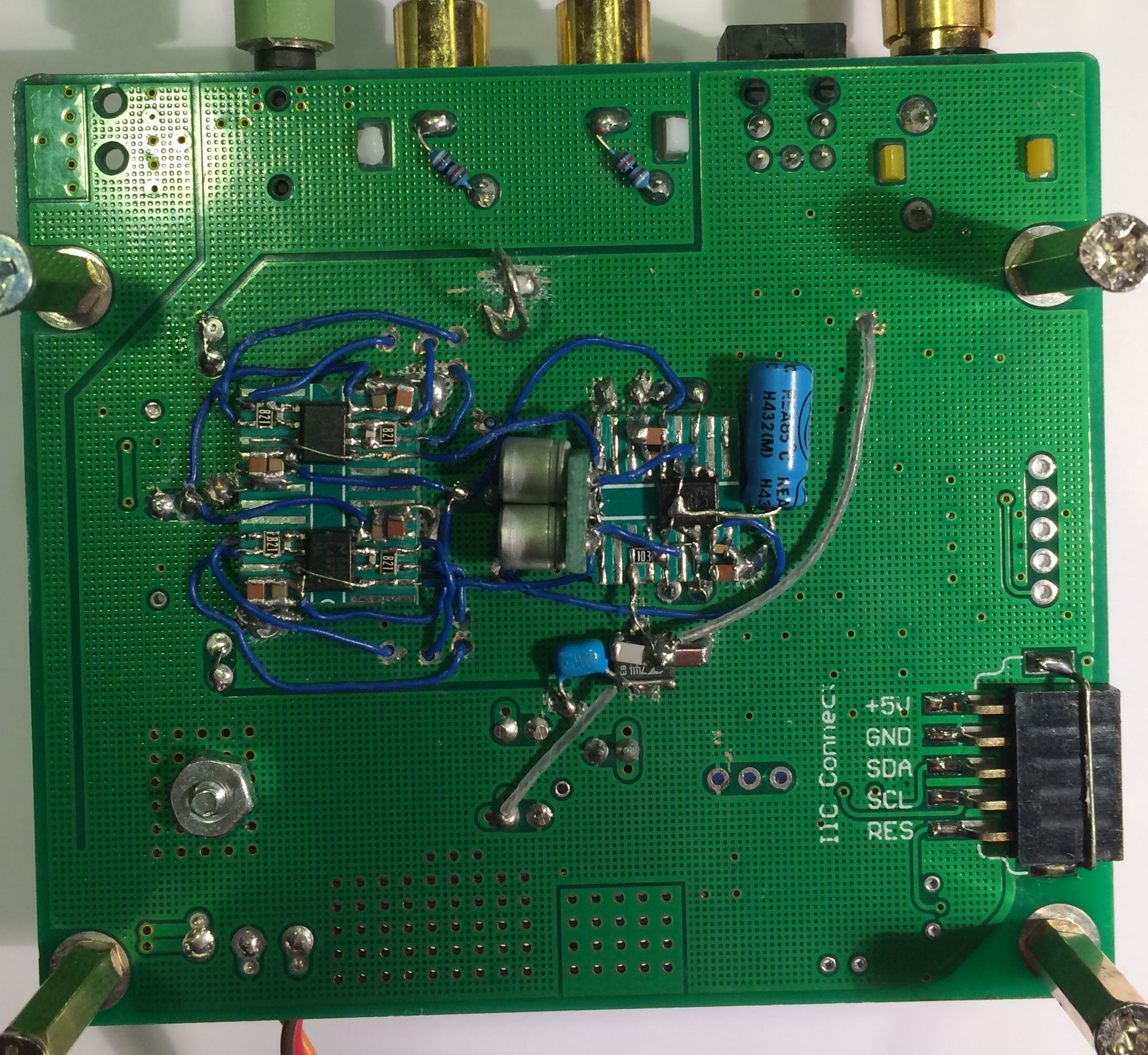

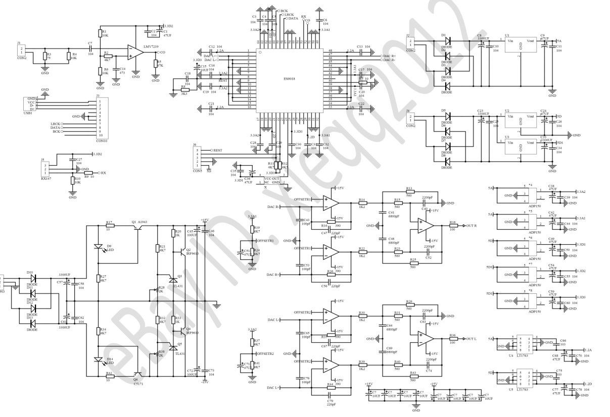

For ESS recommended circuits please see the "Maximizing ...performance... " document in the link that follows. Please read carefully and completely. ESS Technology :: Downloads
One thing that is not shown in that document is how to derive the Reference voltage from AVCC. That part is shown in the Evaluation Board Schematic available at the same link.
ESS recommends using AD797 opamp in the output stage. The AD797 is similar to the NE5534 with high open loop gain for low noise application. It seems to me that I should leave the NE5532 alone on the Chinese DAC board.
I was thinking about using the BB OPA627, but not sure anymore from the ESS app note. Any comment?
The Benchmark DAC-3 uses LME49860 opamps. That is a higher voltage version of an LME49720. They run at +-18 volts. Right now I am running my board at about +-17 volts which is within the specs of everything.
The 5534 in there is mostly a problem because it is part a voltage mode output stage with -75dB distortion. If one decides to fix the distortion it requires going to IV output of some kind. If going to that much trouble, may as well use an opamp known to work well based on ESS recommendations, and I would say, Benchmark could be a pretty good recommendation too.
Playing around with swapping opamps in the voltage mode circuit is a gimmick the Chinese DAC makers use to help sell more DACs. It gives various flavors of high distortion with user choice of a little coloration to taste. It's basically junk, but it is cheap to make and it sells. Can't blame them if they understand the market they are catering to. As one can probably tell, I am a strong proponent of going to a good IV output stage. It does sound better, potentially hugely better if other mods are done too.
The problem is the NE5532 is configured as a differential to single ended buffer. The 9038q2m wants an I/V.
You could make a superb NE5532 I/V if you want and get infinitely better performance than the stock board. It's less about the opamp than the configuration.

My suggestion, if specific problems with 16-bit I2S, would be to pad out the data with zeros to 24 bits, justified left or right whichever works, or go to SPDIF. Not practical to re-code their firmware.
Edit, seems like Mark beat me to the punch. :)
As far as recommended I/V's, look up my username on this thread and you'll see a link to Victor's I/V, or JenH has his schematic, or the ESS provided one. They're generally variations off one another (although Victor's is a clever way to get SE out of one stereo opamp)

I/V does not mean inverted, although that is a byproduct. ESS says the DAC outputs can be run into a high-ish impedance load, they call that voltage mode. Or the outputs can be run into a virtual short to ground (AC-wise), which they call current mode. I/V stands for 'current to voltage' conversion.
In reality with I/V the outputs aren't held at virtual ground by the I/V opamps, rather they are held at an offset from ground called the 'reference' voltage. The reference voltage is exactly 1/2 of AVCC, the DAC chip analog output power supply voltage.
In can help greatly if you ask questions about anything that is not clear in some of these technical discussions. People are willing and happy to help.
Anyway, ESS says distortion is greater when the DAC outputs are operated in voltage mode and best when operated in current mode. They aren't kidding. The circuit that comes with the DAC uses what amounts to voltage mode. That's bad.
If using current mode there are two DAC outputs for each channel, one inverted and one non-inverted. Both are converted from currents by going into two separate I/V opamp stages (one for each output), then used that way as differential outputs, or they may be combined into one single-ended output per channel using another opamp as a differential summing circuit.
As DPH said, victor figured out a clever way to do the whole operation using only one dual-opamp per channel.

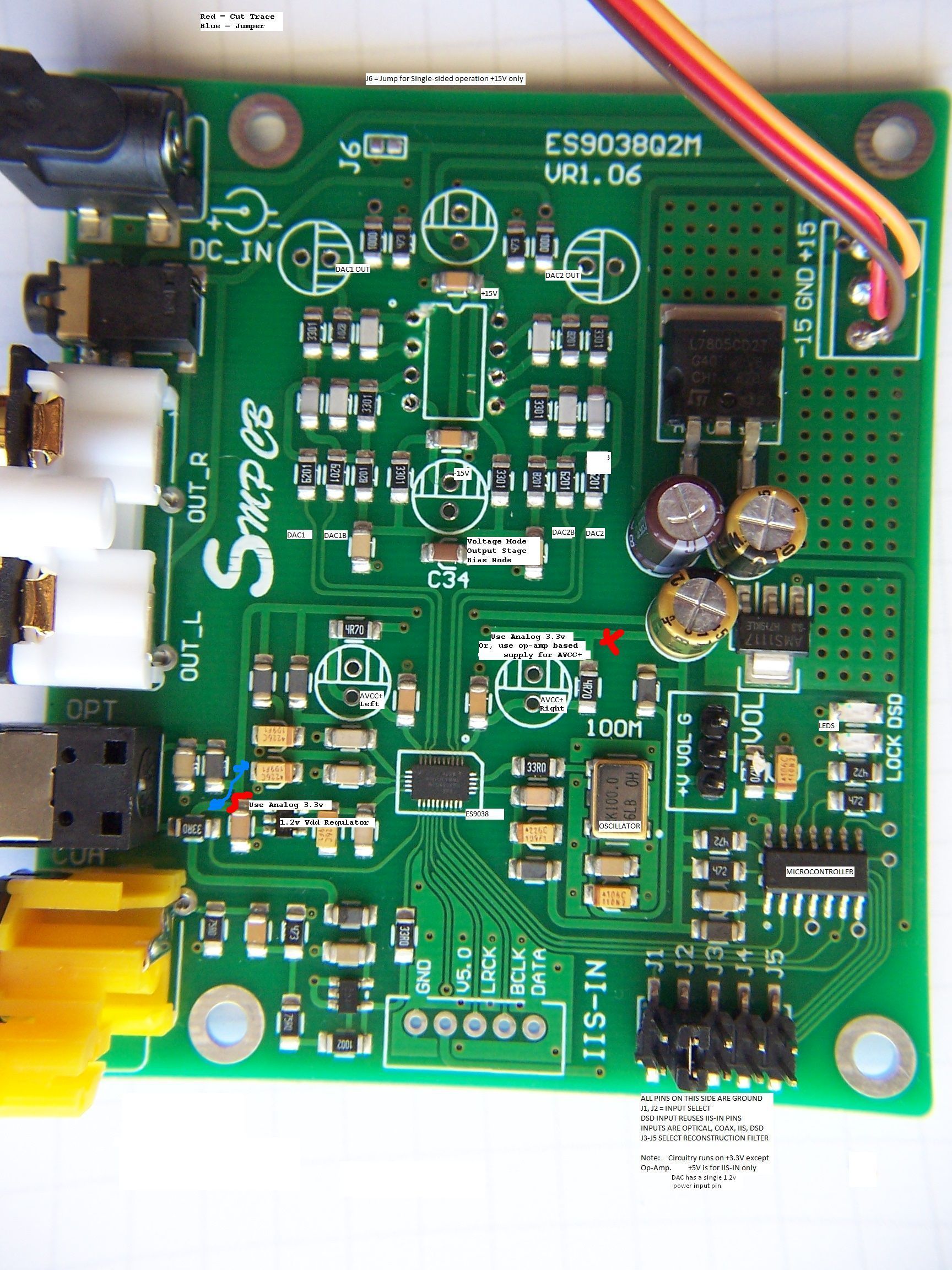

I/V output stages are not the only issue. Not by a long shot. According to ESS, AVCC should have a super-regulated power supply. It has zero PSRR and is critical to sound quality. So, that needs fixing. From that, reference voltages need be derived.
Power supply regulation on the board is poor, with digital and analog circuitry on the same power rails. Bad.
The clock is not a low-jitter type. Bad.
The reconstruction filters built into the DAC chip have audible artifacts in the audio band. Not great.
For perhaps more than one reason, some of which may not be fully understood, these DACs seem to sound better with upsampled inputs. For example, Benchmark and the latest 5th-generation Crane Song DACs use upsampling. Crane Song has an extremely low-jitter clock and say it is is a big deal. I know a guy who sells gear to recording and mastering facilities. He is well-known in the industry but keeps a low profile for reasons I will set aside for the moment. He sells a lot of Benchmark and some mastering facilities are buying some Crane Song units unlistened-to based on previous experience with earlier products that have become mainstays. Both Benchmark and Crane Song are using upsampling and custom reconstruction filters to address the audibility issues. Don't know about other high-end manufacturers at this point, but no doubt they are watching. What I can say is this DAC sounds better with upsampling and use of a slow transition minimum phase reconstruction filter. There is a lot to do to bring these DACs up to a level of quality that makes full use of what the Q2M chip is capable of. It can cost $200 or more by the time one is done to make this DAC into a serious very detailed accurate and great sounding DAC. That is cheap for what you get, but it is plenty complicated without trying to get rid of the opamps. If used wisely they are fine. That's not the problem, not even something to think about until you have done all the other stuff that matters more.
In addition to all the foregoing I am working on testing one remaining mod that is reputed to be a big deal. Probably in a few days I will have more to say on that.

I also added a picture showing how to set the output sample rate for Windows from the sound settings in the control panel. Unfortunately, unless you have ASIO drivers for a sound card that is not the default sound device card, Windows will resample your audio to whatever that setting is and do a poor job of it. If you want to hear it unaltered you will need to reset it to match the sample rate of whatever file you are trying to play. When testing DAC operation, setting it correctly is mandatory or the exercise is probably a waste of time and even worse misleading. Macs do this type of thing too, maybe Linux.
