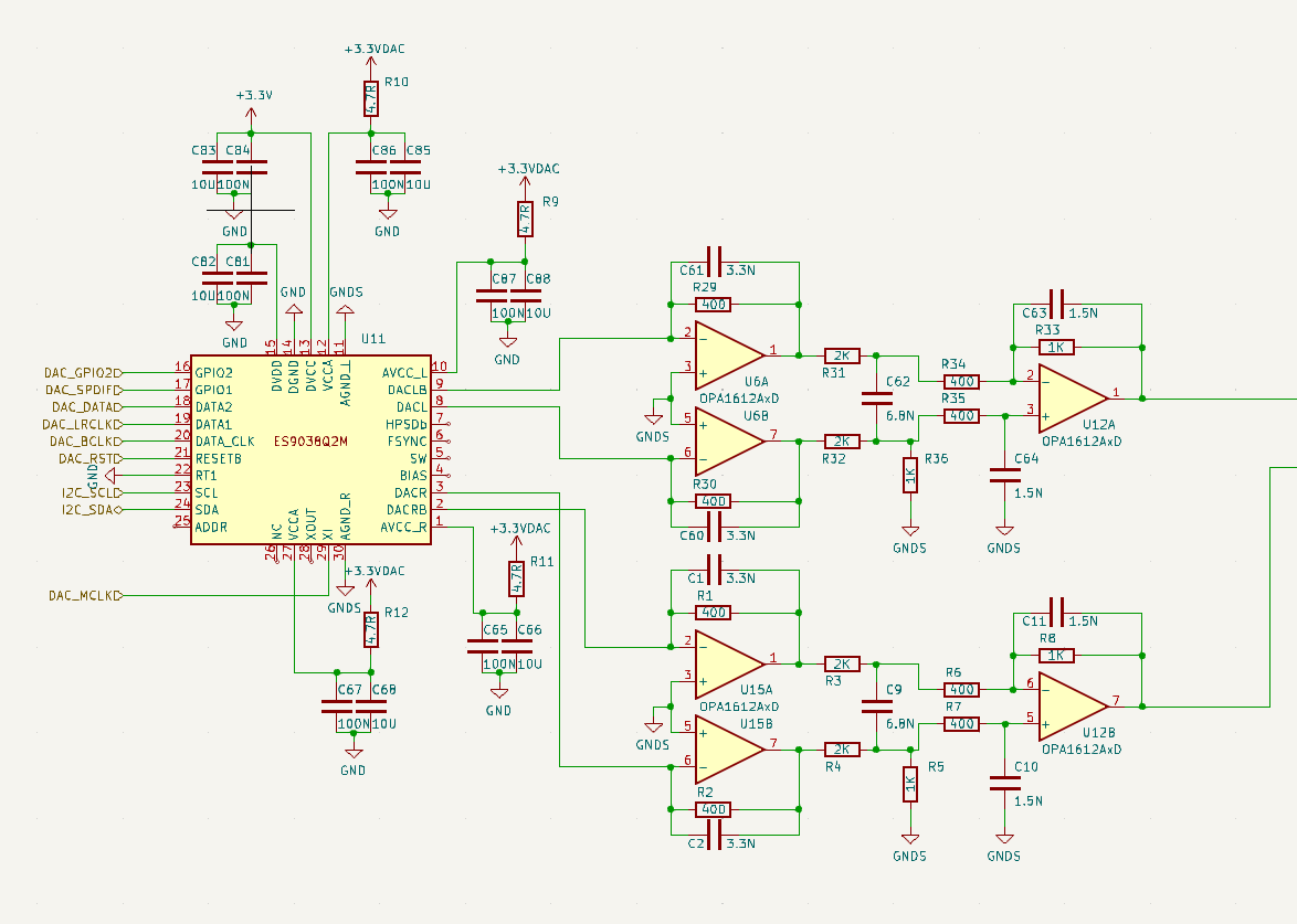

Hello,
I'm designing a audio digital board for a power amp.
Purpose of these board is to have 3 digital input: 1 USB UAC, 1 SPDIF, 1 Bluetooth and one analog input.
My design is based upon a stm32f446 (open uac2 project ), a Microchip BM83 module for BT and a ES9038q2m for the dac.
ES9038 looks good choice for me as he directly have a spdif input (fews days ago I think about a SRC4392 and a AK4490 combo, ES9038 look cheaper and simpler).
Then STM32 feed dac with one I2s, there is another I2S from BM83 module and a simple mux will do the job of routing I2S signal to the dac.
For clocking section I think using directly the stm32 MCO output (openUAC2 project give a MCO clock output wich is 22.5792 or 24.576 depends of 41/48k fs family) to give ES9038q2m a clock.
My plan here is to have a 'perfect' Fs when USB is selected (STM32 give 22.5792 or 24.576) and when other input selected (BM83 ou SPDIF) stm32 is set to 24.576: so when bm83/spdif is 48k family I have a perfect Fs, when 44.1k family the dpll inside ES9038q2m give me a not too bad 44100.002288 Fs.

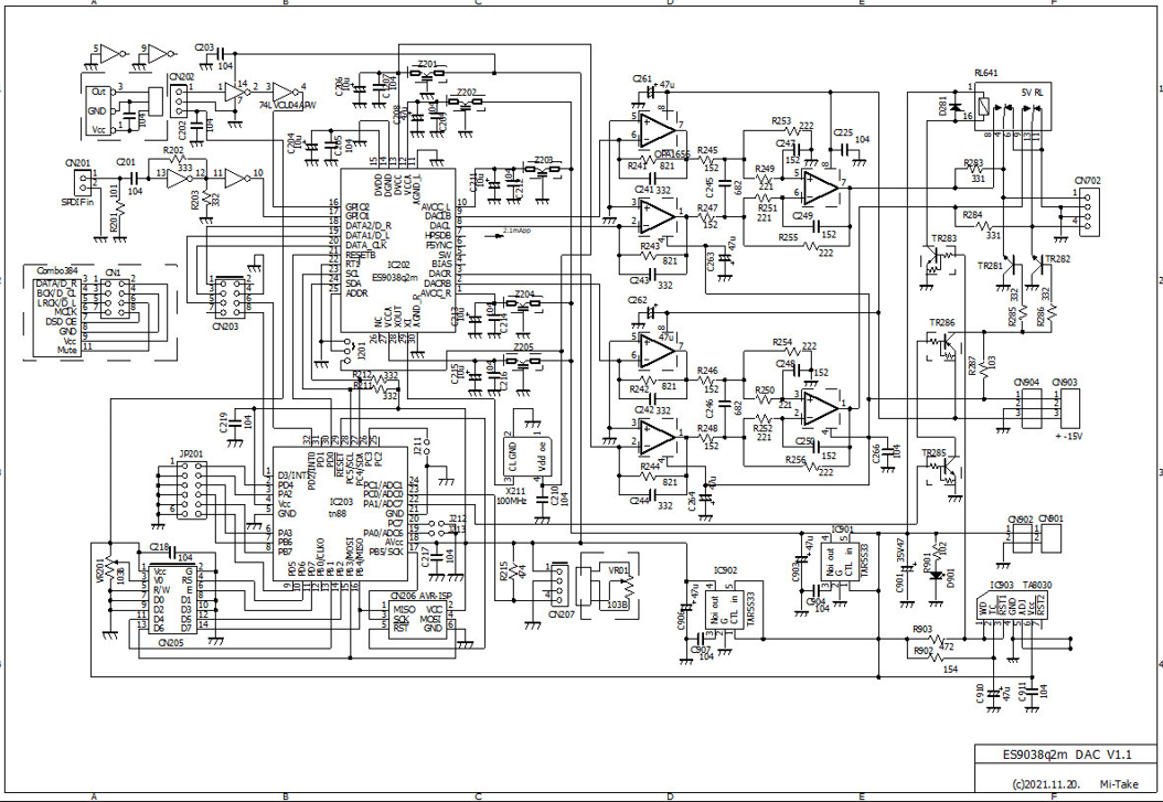

For I/V conversion I think about a classic 2 order LPF using OPA1612:
Are there any big mistake I did on these implementation ?
If you have feedback I will be interested :)
have a good day!

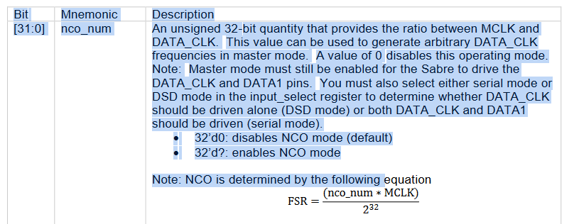

Because my design hown a good local clock which can generate audio frequency 22.5792 or 24.576M, thanks to the open UAC project, I imagine using this clock to feed the dac when playing from USB UAC I2S to get exact Fs instead of 100Mhz reference. I don't know if using ASRC in this case is a good thing ?

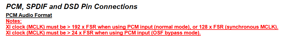

But an old version of ESS datasheet made me afraid about using 22.5/24M clock on Xi pin:
With 22.5/24M the max Fs will be limited to 96k in PCM input and 48k in SPDIF mode. I want achieve at least 192ks Fs.
So I have to double and feed dac with 45.1584Mhz/49,152Mhz at least if I want go to 192ks. I don't know if the master clock output of my stm32 can achieve such 'high' frequency (for 24M frequency I know this is ok).
ES9038Q2M datasheet states that in PCM mode minimum MCK is 128FS (sync) or 192FS (async). So with 22M/24M clocks you can have 192k FS in sync mode. Async mode requires separate clock so in that mode your stm32 board clocks are not used.
The I/V converters are not quite classic. Normally the + inputs of the op-amps would be connected to a reference voltage, typically at half the AVCC_L and AVCC_R. Does it work with the + inputs grounded? It will force the outputs of the ES9038Q2M to GND level.
The resistors R36 and R5 should be connected in parallel with C64 and C10 respectively. Otherwise the common mode rejection of the differential amplifier/filter will be very poor.

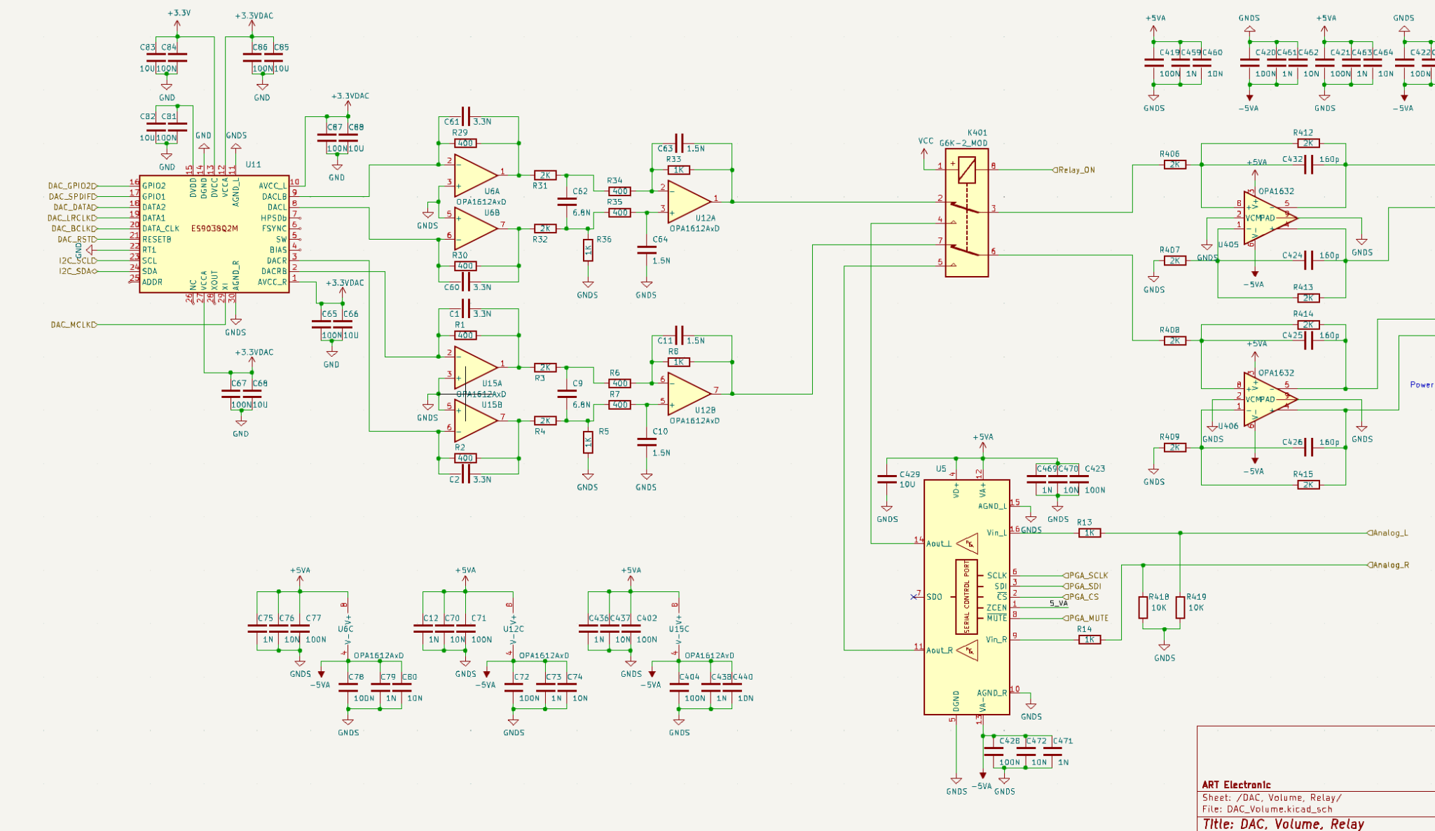

Hi, many thanks for all yr feedback! This help me understand how to manage a dac.
Attached schematics of my design, this way is more easy to explain what I want to do.
The USB audio is on the same board, managed with STM32 wich acts as a general purpose controler and a USB UAC2 streamer. So I use audio clock generated by STM32, register configurable for 44.1k/48k family and normally can goes up to 98.304M/90.3168Mhz, will try when PCB where ready. The clock is buffered by a MUX (I have to find if TMUX1574 act as a buffer or not, if not going on SN74 circuitry).
With this scheme when USB input DAC will run without ASRC with proper audio clock automatically managed by STM32, if SPDIF or BT input the clock is set to 48k family and ASRC is ON.
@Markw4 thanks for give me AN from ES, indeed will use a 4l pcb, also today my schematic show different gnd domain, I think will keep just one with proper current path as you say this is the way to go my last work design use only one plane and achieve very good SNR. I will take a look on Victor's solution, hard to find on the 398 thread sheets :). Also will take a look on NDK SDA serie, but seems not easy availlability (mouser, digikey...). For now I will stay on a IC design for DAC, but design with discrete r2r looks beuatifull indeed!
@altor : BM83 looks easy to use with sample config code on github, as my favorite programing langage is definitly iron solder nor embeded C, I choose BM83 for this reason and also mouser availlability. If you know other module I'm interested in.
@bohrok2610 Yes when SPDIF/BT is selected as input I will clock the DAC with a fixed frequency derived from 48k family.
@JensH: You focus on very interesting thing, today I simply reuse schematic I found on this forum:
And also find a ltspice of AFE of ES9038 on internet:
For me there is only R7 and R8 (ltspice shematic below) who differs from what you says about common mode rejection, R7 and R8 only change the behaviour of the last diff to se amplifier, adding a pole to make the frequency answer more flat. But will be interested in to understand your feedback about common mode rejection. For the other thing, the gnd connected to n inverting input indeed you totally right, this will push DAC out near GND, will made a HW conf here with mounted/not mounted resistor, thanks to you!

TLV755 has far too much noise for AVCC supply. Use it only for VCCA & DVCC and a lower noise regulator for AVCC.
Using MCK generated by STM32F4 will likely have quite a lot of jitter no matter what oscillator you use. It is much better to have separate low jitter clocks for audio MCK and use those clocks for I2S generation via PC9. But that would need changes to the FW you are planning to use. Easier and lower jitter solution for you would be to use ASRC also for USB.

@__BriKs__
The schematic for the differential amplifier/filter you show in post #7,958 is not the same as the one you have in post #7,948!
In the schematic in post #7,948 you need to move R8 and R33. And yes, this is better than moving R36 and R5. The cut-off will be sharper when moving R8 and R33, although with a bit of peaking.
