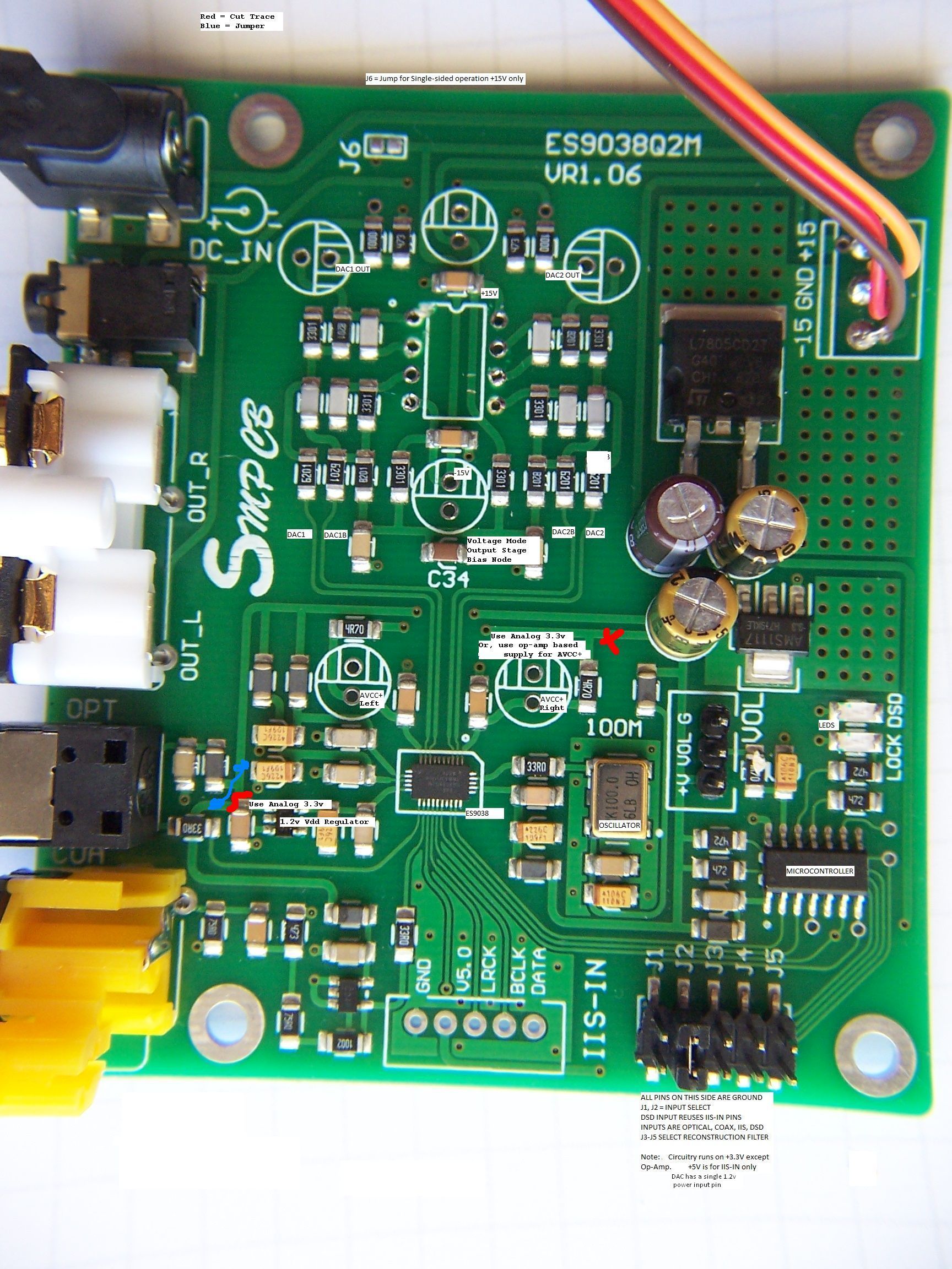

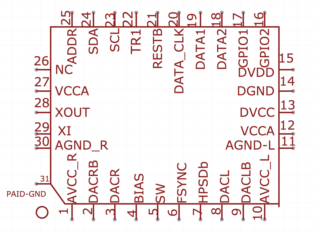

The ES9038Q2M needs 1.2v for Vdd on pin-15. If no regulator how does is get that voltage?

I would say that with that board if you wanted to get it the sound quality up the where my modified Chinese DAC is, it would need:
Low-jitter clock upgrade.
AVCC power supply upgrade.
Linear power supply low-noise mods (diodes, regulators, etc.).
SRC4392 board.
Output stage passive component upgrades (we haven't talked about this and no one has asked, but we probably should talk about it).
Low distortion LME49600 headphone amp for test listening.
USB to SPDIF board (if desired).
Things we might get to here you might not be able to do without you
going through the non-disclosure process I am trying to get through:
Try master mode I2S with jitter correction off.
Intersample over fix for 9028 implemented via SRC4392.
EDIT: Something I am not sure about with the board you are considering would be ground planes and trace routing. The pictures I posted of the mod layout I used shows use of a ground plane and reasonably rational layout and wire routing. With a finished board, it can be really helpful if the designer did a good job, and a lot of rework if it was done unwisely. (If anyone else considering doing mods and would like to talk about layout considerations we could probably discuss that here.)
EDIT 2: Regarding the use of a 9038PRO with tied-together channels, the schematic they posted doesn't show that. It shows extra channels not connected to anything. Not sure they have enough IV stages on the board for all the potential 9038 output current either if outputs tied-together.

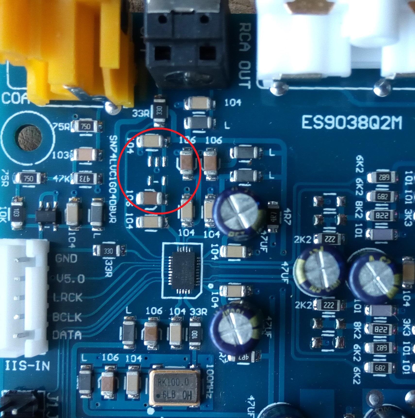

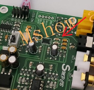

Hi Markw4,
I own a blue pcb version that works, sound flat (as user sbf2 said on post 162), and come without 1.2v regulator from factory, same with a different blue version of a friend, looking to the chinese seller pictures seems that v1.07 is build in the same way, that is why I´ve asked, looks odd...
