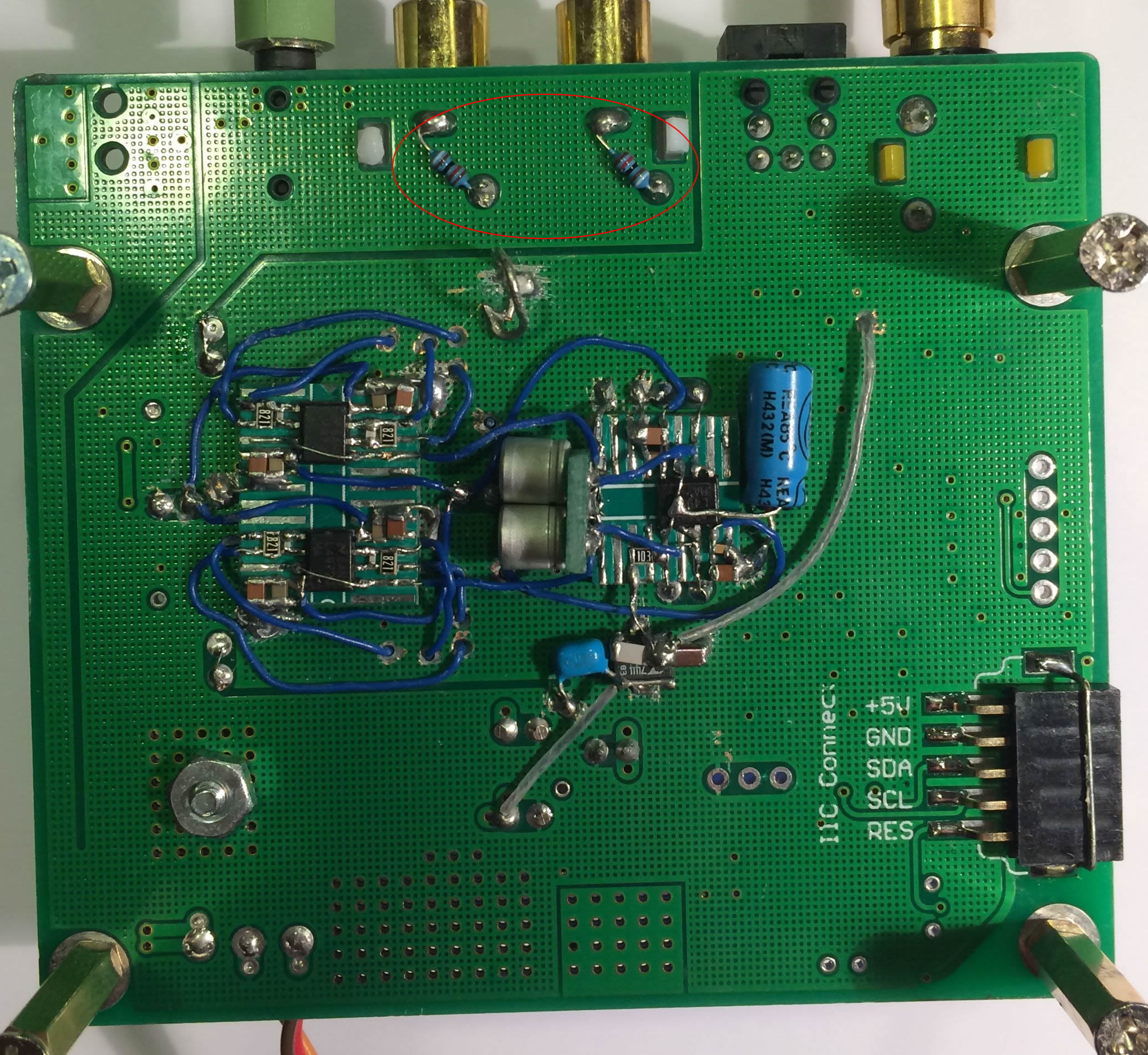

Thank you for all your posts and offers here. I already did some changes on my V 1.04 es9038q2m board:
- add 2 polymer elco caps 2x 390uf to AVCC instead of orig. 100uF cap which gave a big improvement in bass performance
- feed seperate power to AVCC for both channels. one of it also supplies the 1,2V reg for DAC analog. This mod. improved harshness a little and made the sound less exciting in a positive way.
- removed DC caps (DAC still in voltage mode) and replaced opamp with descrete opamp with DC offset adjustment - no big improvement in SQ
- added polymer cap to tantalium cap for clock PSU (not sure about this effect as it was combined with AVCC mods)
- feed clean Sigma 11 power to 3,3V reg, eliminating 8V reg on board
next step would be a new clock (golden TCXO from ebay 100mHz, 0.1ppm - any experience about it?) with seperate reg. and a current Output stage.

Thought maybe a good idea to post pictures of my particular Chinese DAC in one consolidated place. They mostly show circuits pretty close to what ESS recommends.
Hi Mark,
I have another few newbie questions: What are the use of the resistors you soldered on the rca output?

The resistors were put there before I decided to remove the output coupling capacitors. They were to make sure the caps could discharge if whatever the DAC board was connected to had coupling caps too, and no path to ground.

@freezebox, Regarding proposed schematic, why not connect non-inverting inputs of first two IV opamps to 1/2 AVCC? Also, if I read that correctly 10 ohms seems like a rather small output decoupling/current-limit resistor for the differential output stage. What load impedance do you anticipate it needing to drive?
Also, you might consider using those little Vishay SMT resistors rather than axial metal film. The resistors are more linear and some people think they sound better. If going for the best sound quality it's probably not unreasonable to try and see what you think or how your measurements look. The resistors are available in very tight tolerances for close gain matching of circuitry, and the 1/8 watt versions aren't too small to handle easily and can be soldered onto perf-board or whatever you want to use for prototyping.

I agree that the non-inverting op-amp inputs should be connected to 1/2 AVCC. So add another 4k7 resistor to AVCC.
I would scale the components in the output stage, e.g. making the resistors 1/10'th the values and the capacitors 10x the values. This will reduce the noise considerably.
The 330 ohm resistors in the I/V stage could be changed to a higher value.
For the output resistor I would use 47 ohm.
For ceramic decoupling capacitors I would use X7R. The ones in the audio path should be NP0. Or film if you prefer that.
And yes, the polarity seems to be wrong.

MarkW4 and JensH,
Thanks a lot for your comments! This shown layout in post #594 I read out from my already existing es9028q2m board I linked to my post. I am planning to just use the i/v stage of this board and connect it to my es9038q2m DAC IC outputs. So I don´t want to build a complete new board or replace all components.
I will check again if I missed a connection of AVCC via 4K7 to the i/v Inputs when writing out the schematics. I think this is an important advise when connecting it to my other board - thanks! So should I remove the cap in parallel to the existing 4K7 resistor?
Regarding polarity change this is probably an error of the es9028 board design, so in this case the absolut polarity would be changed when using this i/v output, correct?
The output resistor on the board is only 10 Ohm, - I am not sure what is the Input impedance of my active crossover I connect the outputs to... but it worked fine with the es9028 DAC board only..
