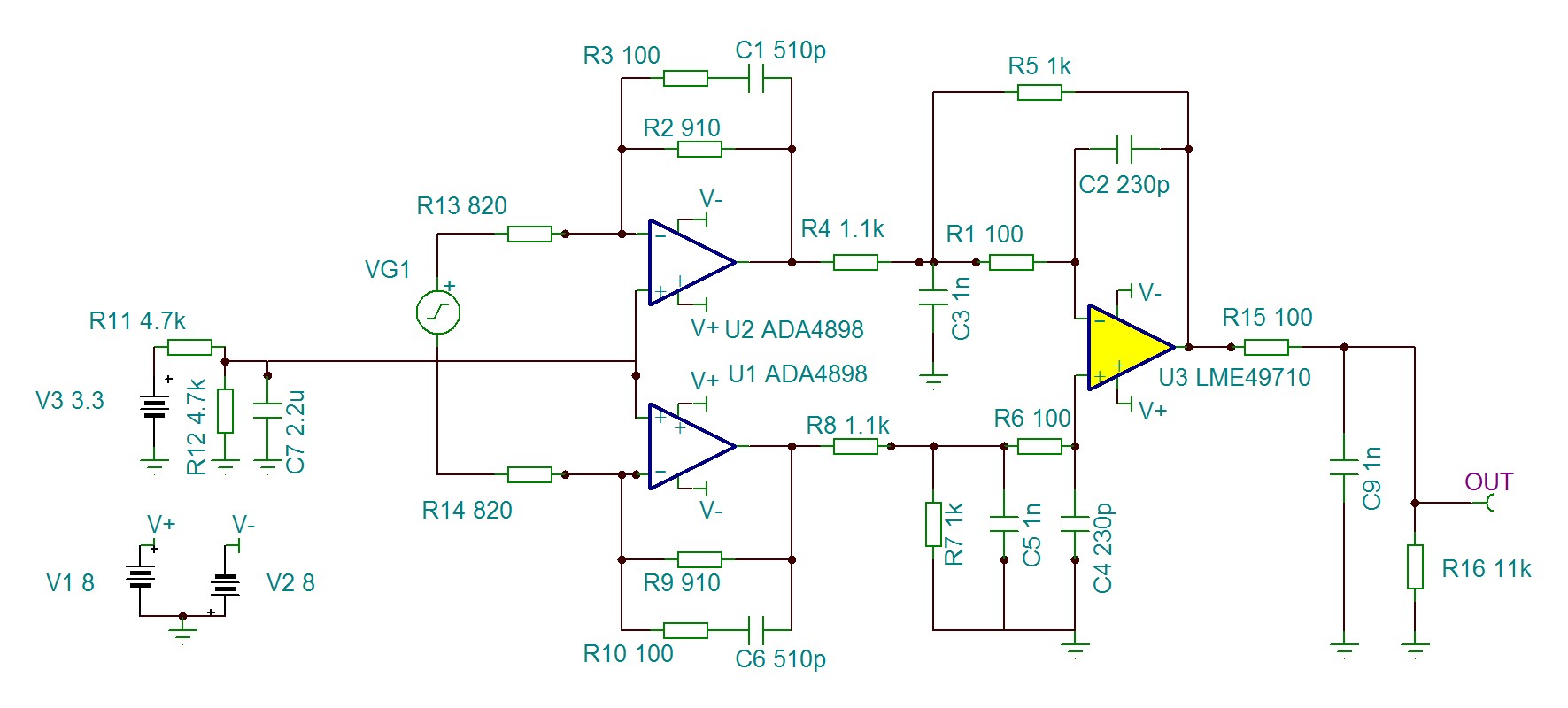

Should have mentioned in the last post that some schematics are available in post #3003: https://www.diyaudio.com/forums/digital-line-level/314935-es9038q2m-board-301.html#post5577605 ...also please see the posts after that discussing differential outputs.
In addition, an output stage board mod has been described:Dropbox - Output Stage Instructions.zip
Regarding the output stage schematic we used, it sounds good but a commercial output stage was posted in this thread that is rather similar, mainly the impedances around the differential summing stage are lower. The lower impedances are likely a little better when using OPA1612 opamps, but I haven't listened for differences myself. Please see attachment below. One might use the basic design of our output stage project but change some parts values to match the schematic below to try it. If doing that, please be sure to use equally good quality components for the resistors and caps.
There is one more thing to mention here: the voltage level for Vref, which is produced on our AVCC mod board, might need to be changed to reduce distortion in the output stage (ESS 'hump' removal). If you are thinking about doing the mods, there were some posts on that subject I can help look up for you.

4. Roll with opa1612
The existing single opamp output stage is called a 'voltage mode' output. THD is down around -70dB that way which is pretty bad. With a proper 'current mode' output stage it is possible to get down closer to -120dB distortion which is very good.

Biggest improvement probably with three opamp output stage running on +-15v, and opamp AVCC supply. If can't do the latter, then large electrolytics (3x 1800uf per AVCC pin) can help until you can.
