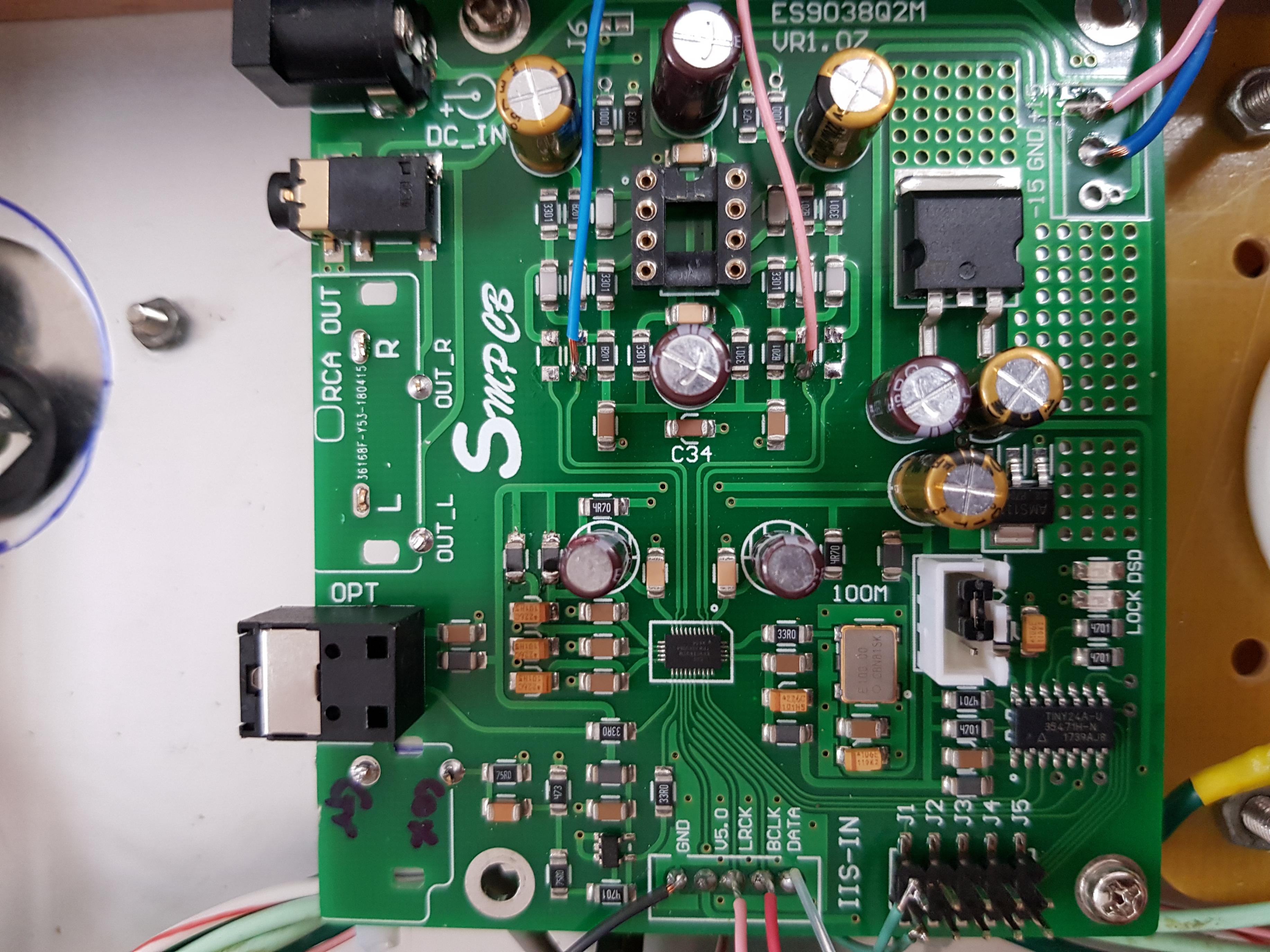

Thanks Mark,
Here are my boards.
Mark,
Do you think these board can play DSD?
Yes, they can play DoP and native DSD.

Please tell me what I can do so that my DAC run native DSD.

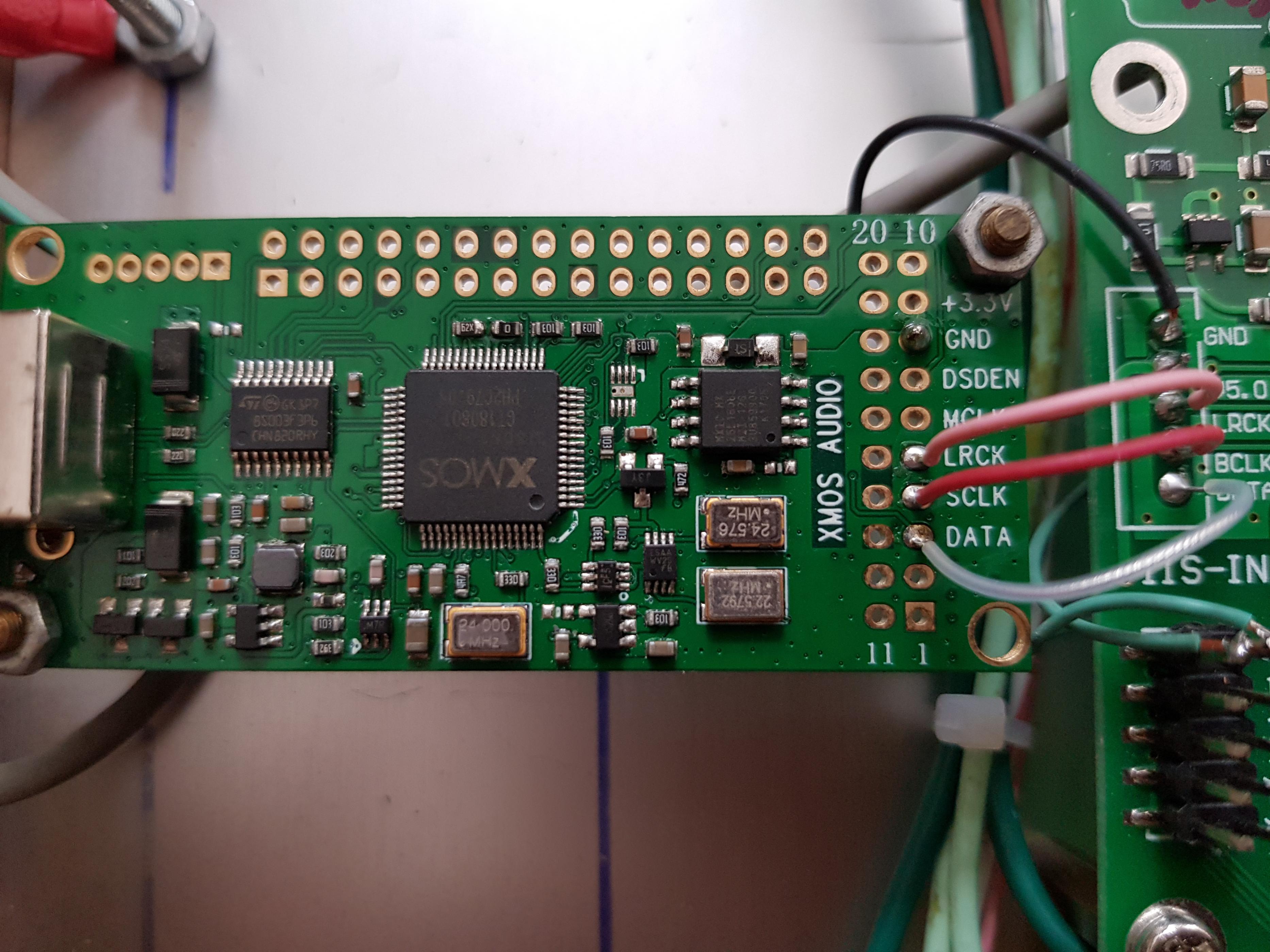

You need a USB board that comes with working ASIO drivers. As mentioned previously, JLSounds makes one that is probably lowest cost solution. It uses good low jitter clocks and provides galvanic isolation. There is also what is sometimes referred to as Genuine Italian Amanero USB boards. Chinese USB boards don't work for native DSD.
To get the best native DSD sound quality, among other things the dac registers would need to be reprogrammed, but no point bother with that if using single ended voltage mode output. The distortion is already very high that way, 50dB or more worse than it should be, so hard to hear much improvement.
Anyway, once there is a USB board and the ASIO drivers are installed, then just make sure that Windows does not show any default device checks marks in Control Panel > Sound settings for that audio device. If the USB board is not the Windows default device for anything, the ASIO can then work properly. Then you need a program that can play native DSD. HQplayer offers the highest quality conversion to DSD512, but it takes a powerful i7 computer to be able to run the best sounding DSP algorithms.

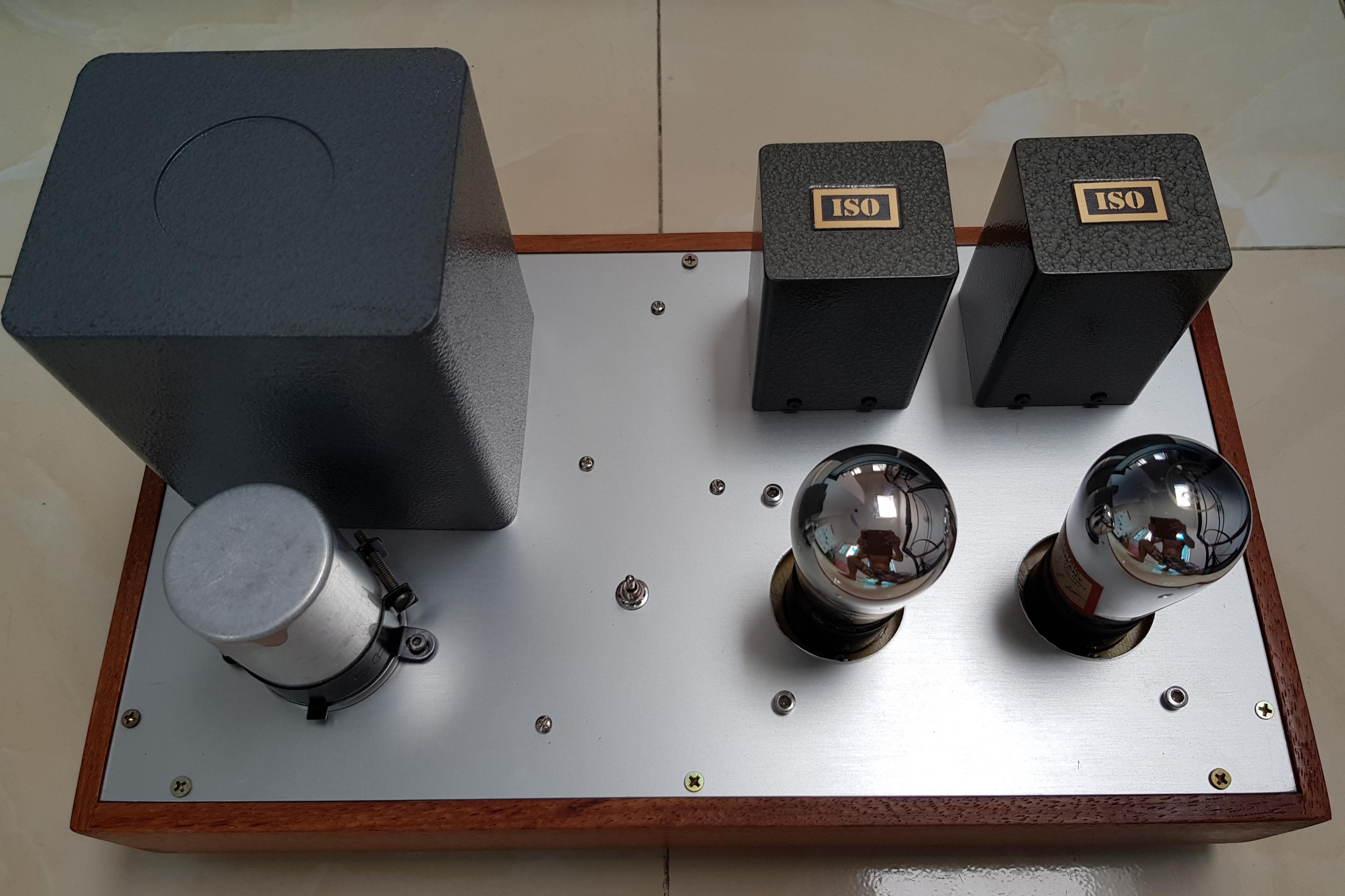

Hi Terry,
01A, 26 and 45 are the best sounding triode tubes that USA have manufactured. And my system uses all 3 of them :)
That photo you see is buffer tube after DAC chip. They include 01A/26 tube (switchable) along with Tango ISO NP-126 OPT. DAC board get inside it.
Tube 45 SET amp is unbeatable if we have enough high sensitive speaker.

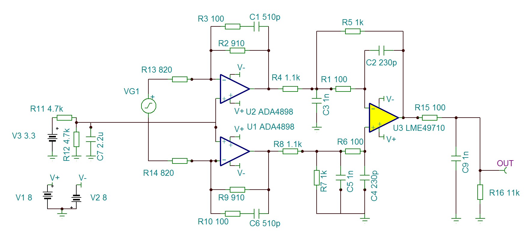

I’m new to this party so was wondering if anyone could post a picture of this output stage to help me with layout please. Also I’m assuming I can use opa1602 or 1612 instead of the lme49720
Tim
Tim
Output I/V stage (from Topping D10 - ES9018K2M), one channel.
