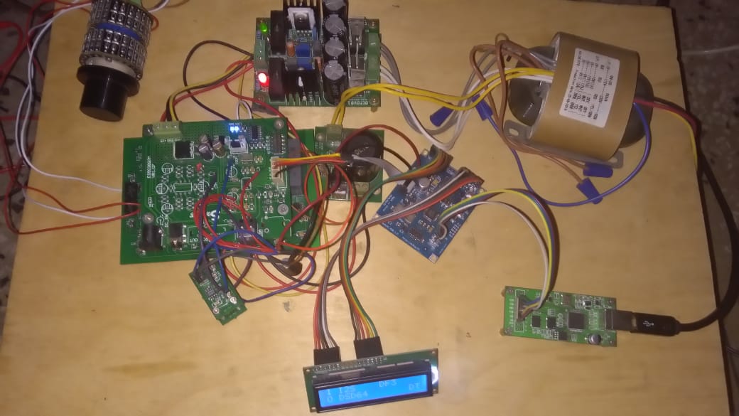

Finally working!
Hi Mark,
If you remember, I had no sound on the left channel after modding output stage. It turns out the mistake was I inverted the signal input +ve/-ve on the 3rd op amp. It is now working well. Sounds Great. Thanks for your help.
The mods are pretty much your mod. I'll give some details may be useful for other members just starting out. AVCC and Output stage on another pcb using OPA1612s. DVDD cap change, Clock changed to crystek 100mhz. Add two lt1763 regulators, one powering the clock only, the other powering all else except mcu which is powered by the original board. +/-15v from lm317/337 board. For the filtering, I plan to use film caps from old crossovers, 10uf Dayton audios, 6.2uf jantzens and a collection of smaller values, totalling around 98uf(49uf per channel), hoping it will make a difference.
Kay
Hi Mark,
Kay

Hi Kay,
Congratulations!
That was quite a lot to get through.
-Mark
