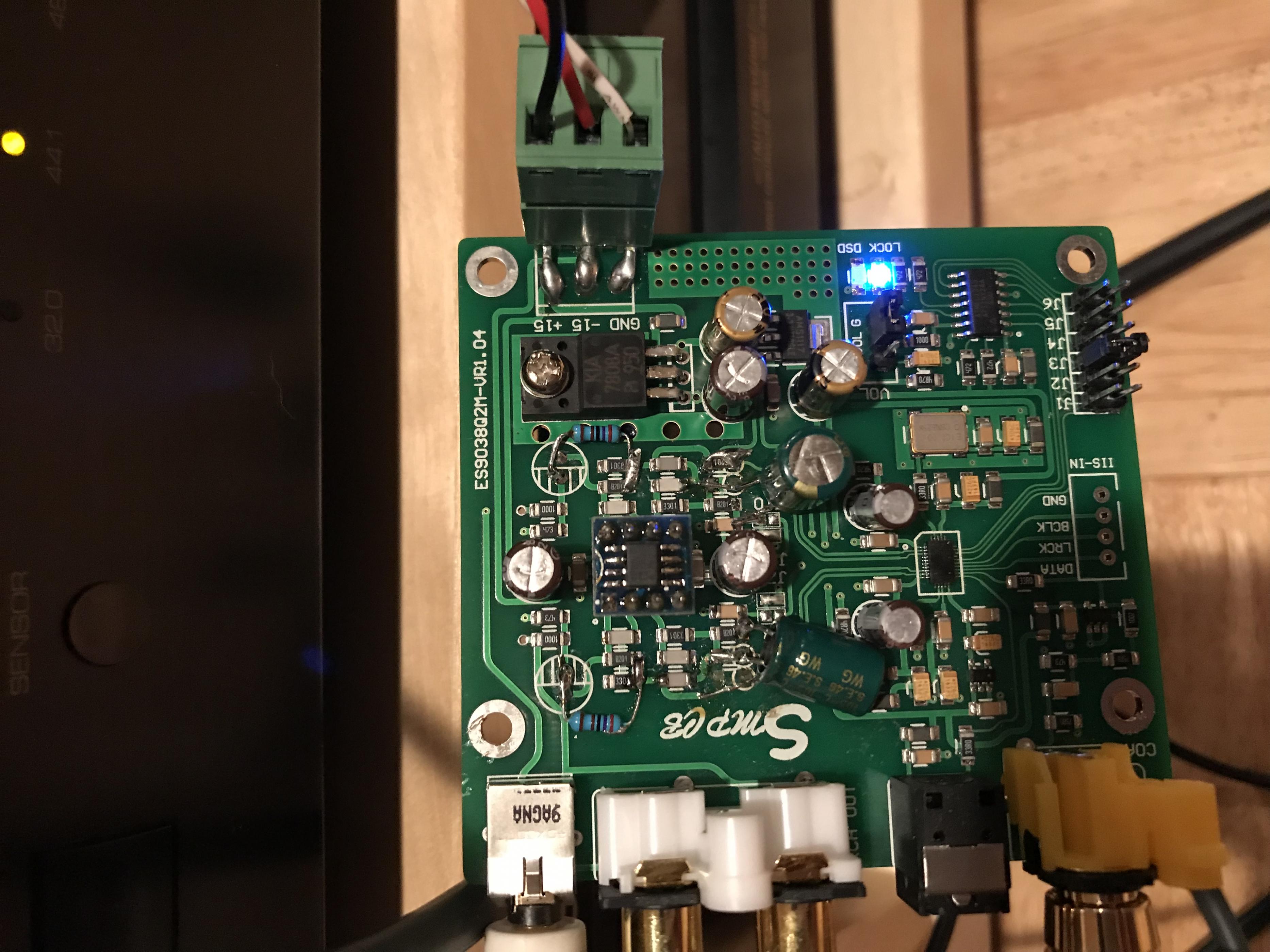

I'm thinking of buying this ES9038Q2M Board (v1.06) and connect it directly to my Pi3 via I2S ( not via USB Amanero). I just wonder if this connection (directly from Pi3 to ES9038Q2M) can play DSD native or Dop ? Has anyone try before and give me some review?
Thank you so much !
Hi.
You cand play DOP but not native dsd as far as I know.
My 1.04 board is connected to rpi3+kali using 2is.
I do not see why it should not work. If you have a heap of LT3045s at hand, set one as pre-regulator for 5V and second as post-regulator for 3.3V. It's a bit overkill and I am not sure if the SQ will be better as if you leave the 7805 in place, but it should work. Keep in mind the board has other flaws that will limit achievable SQ, though...

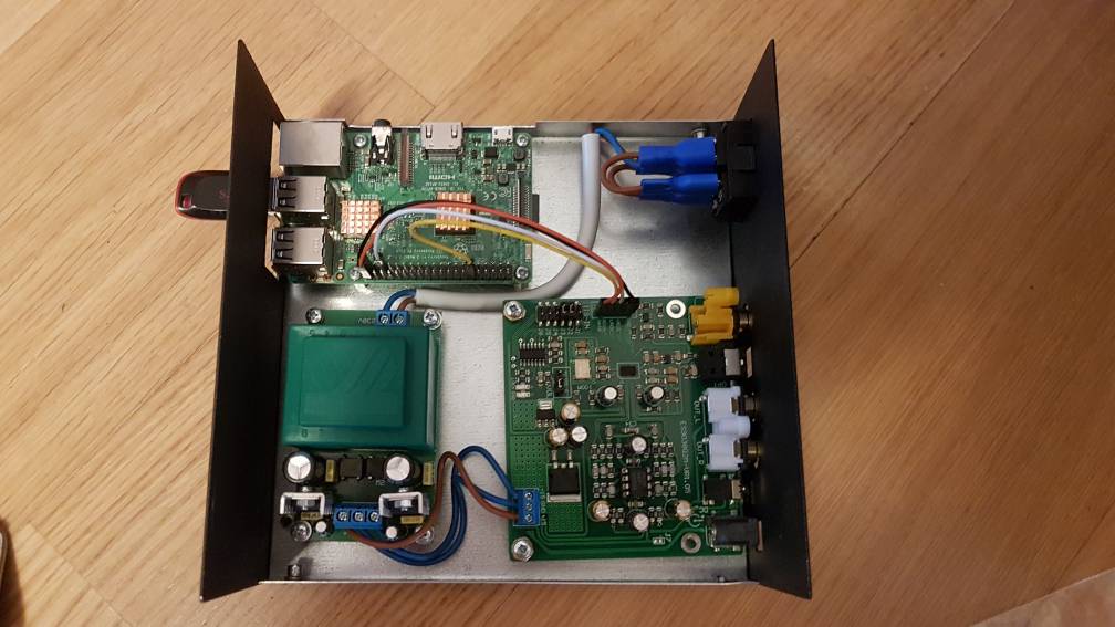

I did kind of the same rpi3 + 1.05
What im worried is if power supply isnt too close to i2s cables?

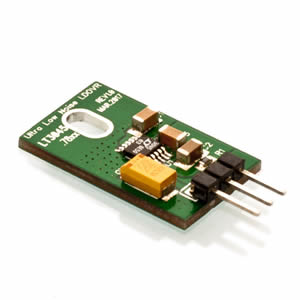

I will try to replace AMS1117 with LT3045-78xx Ultralow-noise (0.8µVrms) 3.3v.
But I'm very new to all these mods and I don't know how to solder the 3 pins of the LT3045 and the ams1117 seems to have 4 legs.
May some of you help me if he knows how to do it?

Despite of the fact that to do some mods you sould have some knowledge, I will try to help.
Indeed, AMS1117 have 3 pins - see datasheet. Namely, tab is the same connection as pin 2 (VOut). And at our board VOut trace is connected to tab (not to pin 2). Pinout of AMS1117 is:
1. Ground
2 and Tab - VOut
3. VIn
As I remember, in your small PCB with LT3045 pinout is the same as L7805 (for example, see datasheet too), i.e.
1. VIn
2. Ground
3. VOut
So, you need:
- desolder AMS1117
- place your PCB with LT3045 on original board somewhere near the L7805 (or 7808, it depends on version of original DAC)
- solder pin 1 of that PCB to pin 3 of L7805 in case of ver 1.06 (or L7808 in ver. 1.04)
- solder pin 2 of that PCB somewhere to ground (I think the simplest way is to do it via the existing hole to bottom layer)
- solder pin 3 of that PCB to the trace where tab of AMS1117 has been soldered
That's all. See also my picture in the post #336 for your reference (in that case pin 1 of my patch PCB is VOut, pin 8 is VIn, pins 3,6,7 is ground).

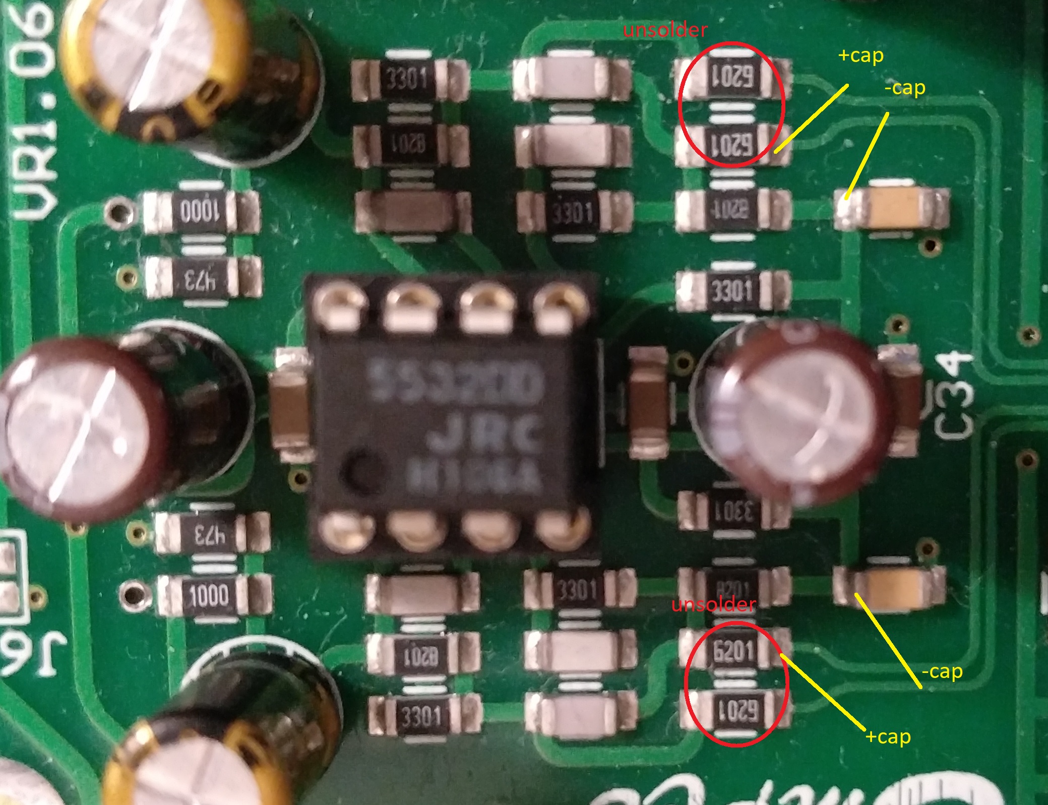

Easy current mode
I wanted to see if I could put this board in current mode with little changes. Managed to do so.
Steps
1. Shorted all the 6.3k resistances (made it 0 ohm). This offers a virtual ground to the negative pin
2. Added a 2.4K in parallel to the 8.3K feedback resistor. This corrects the dc offset on output and gives a 2V RMS output
3. Added a 100uf cap from the + leg of the balanced output to ground. This provides a virtual ground to the positive pin of the DAC. It also provides reference voltage to the opamp +ve input
So effectively a unbalanced current mode.

this is my first post.
I have the board version 1.06, can i do the same mod??
Is the position of the capacitors right?
Please, see the immage.
Can I use the same resistance value (2.4K) to stabilize the RMS?
Thank you
Yes. You can.
You will need to desolder the output caps and short them if you want to avoid them. One leg of the resistor can be soldered there. I used 2.7K actually and have some DC offset. I think 2.4K should work to null it. I initially soldered a 780 ohm resistor thinking the output impedance of the DAC was 780 ohm per leg but then it had 1.5V DC offset at the output and the output was also nowhere near 2V RMS (much lower instead). If I have time tonight - I ll tell you the exact value to have a OV out. I just didn't bother because all that the offset did was make my pot scratchy in my preamp. I didn't care much for current mode although it was better in some ways (lower THD) that the original circuit.
Yes.. your pic looks right. Make sure you short the SMD points after you desolder the resistances
