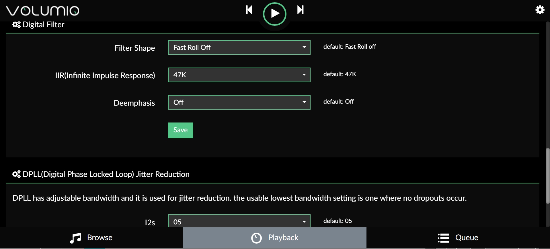

Okay, some new stuff to report with DPLL bandwidth. By very carefully positioning some ferrites in the area sort of between the dac chip and the I2S connector, I can get DPLL bandwidth stable down to 3 out of 10. If with the ferrites in the same state, I change DPLL bandwidth back to 5 out of 10, the brightness and distortion is mostly gone. In fact, I can hear reverb tails on vocals and instruments easier than I can with DAC-3. In some ways it still isn't quite as refined as DAC-3, but maybe in that very particular way it is even better. I would guess it is just the effect of extremely low jitter.
Where I found an previously unknown problem is that we have a new desktop PC in the listening area that replaced the old desktop in the same location (the DAW) and it is the one that usually drives DAC-3. The modded dac is driven from a laptop. Turns out that new desktop PC is very near the open top of the steel case where the modded dac is sitting. The new desktop also has a big clear window in the side to one can see inside, but it also apparently radiates out more noise. Therefore last night when I turned it on to compare the modded dac with DAC-3 I was disappointed that I wasn't closer, and that the modded dac was still too distorted. HaHa, it was the noise it was picking up from the desktop. I will leave that desktop computer off for now and consider the modded dac shielding problem as something to leave for down the road. Right now I need to better understand, if nothing else, what kind of ferrite material is best and how to find position it, and keep its function stable. If I can do that I might almost have a world class dac at some level. Maybe not Stereophile A+, but maybe Stereophile something. Wow!
I haven't even looked at harmonic distortion compensation yet either. Just have to figure out more about how the ferrites for final jitter control works and how to stabilize it long term and I will be happy.

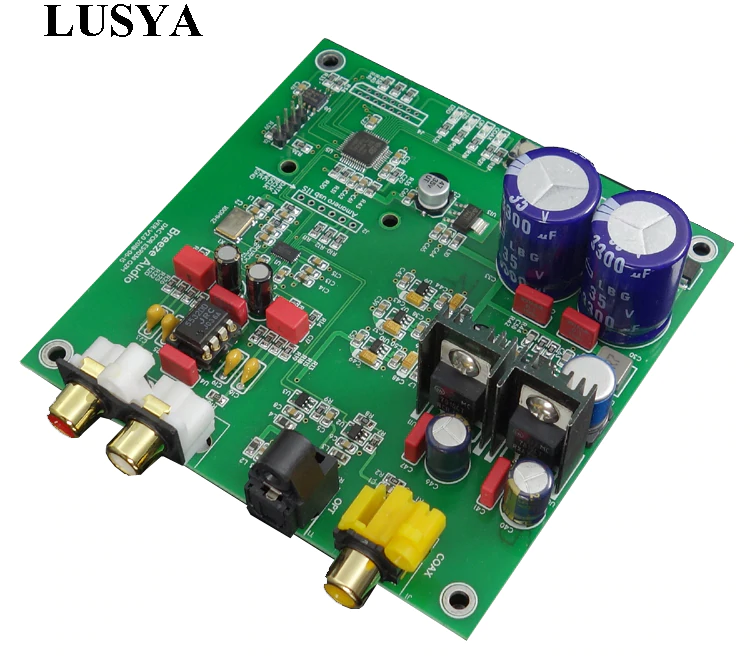

New chinese ES9038Q2M board
Hi, have any of you looked at this new design chinese ES9038Q2M board?
I could not find it anywhere in this long thread.
Lusya ES9038 Q2M I2S DSD Decoder Coaxial Fiber input DAC decoding board For hifi amplifier audio A1 011-in Digital-to-Analog Converter from Consumer Electronics on Aliexpress.com | Alibaba Group
ES9038Q2M ES9038 Q2M I2S DSD Optical Coaxial Input Decoder DAC Headphone Output HiFi Audio Amplifier Board With OLED Display-in Digital-to-Analog Converter from Consumer Electronics on Aliexpress.com | Alibaba Group
Yes. I ordered one to try it. The report was brief. It was junk for a number of reasons. It has a SMPS on it to make 5v, and it sounded awful. But that isn't the only problem. There is no volume control, and no way to select filters. No SPDIF or TOSLINK inputs. AVCC power is dirtier than for most other boards. Very poor layout of output stage with no ground plane under it, and ground for output stage only returns to dac chip through SMPS area of board, making for a very long and noisy loop, etc. Bottom line is: not recommended.
Thanks for asking though. We try to keep up with new boards in case a good one happens to come along.

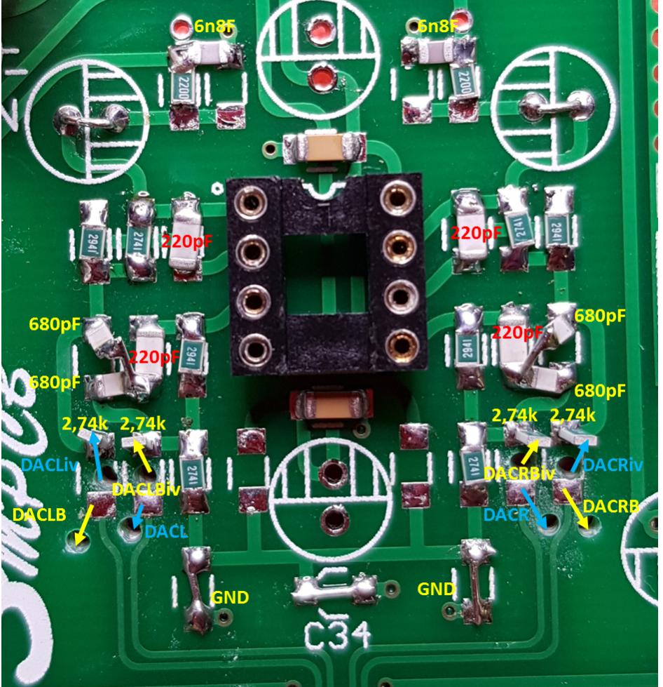

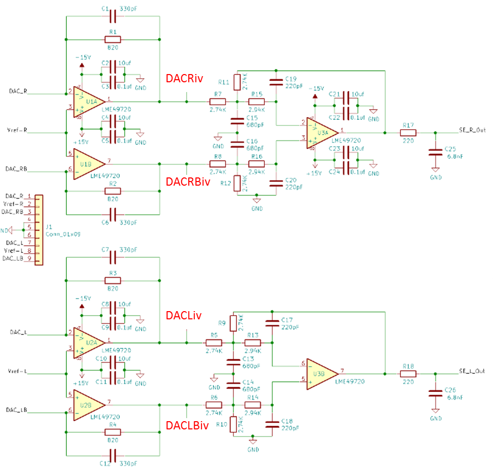

Hello,
I am now working on the SMD mod. for my 2nd DAC board (V1.07). I de-soldered the onboard opamp components of voltage mode to modify it to the new differential outputstage for current mode. I promised to post a picture of it, so here it is. I have added the connection points in the schematics where I split up the onboard differential stage to the below-board iv-stage (same as in my post #1289).
Clock is also changed already to Crystek and LT6655 Vref is placed on a small breakoutboard which gave me some headage to connect the 8 pin chip to a 10 bin breakoutboard without pin interconnections... happy to not have frieded my LT6655 after all this heat-cycles...poor small bug.. ;-)
Next will be I/V stage and 3,3V regs for clock and VCCA.
By the way, should I better take a seperate 3,3V reg for SPDIF amp-stage? - it is currently running with the 3,3V AMS1117 reg. rail for MCU and DVDD.
Happy modding!

Hi freezebox,
Thank you for the picture with nice labeling!
Regarding the question of how to best power the SPDIF and TOSLINK receiver electronics on the dac board, my guess would be that the stock AMS1117 power is okay. The way that Sabre dacs decode SPDIF is designed to be independent of jitter. That being the case, I don't think those inputs need special power regulation.
Also, I haven't used those inputs much since getting the AK4137 boards. The more expensive version has its own SPDIF and TOSLINK inputs that it can upsample to 11.2MHz DSD, so not much need to use those inputs on the dac board.

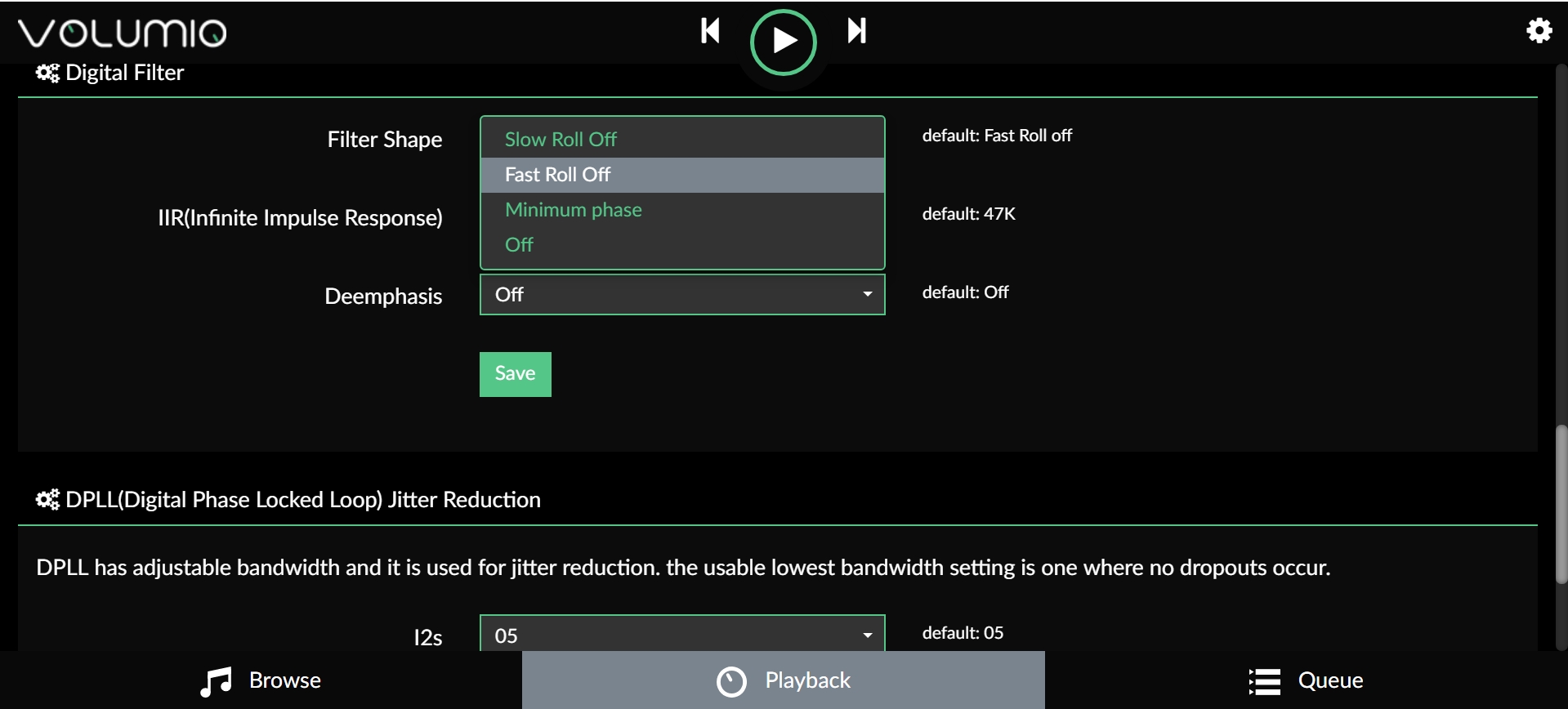

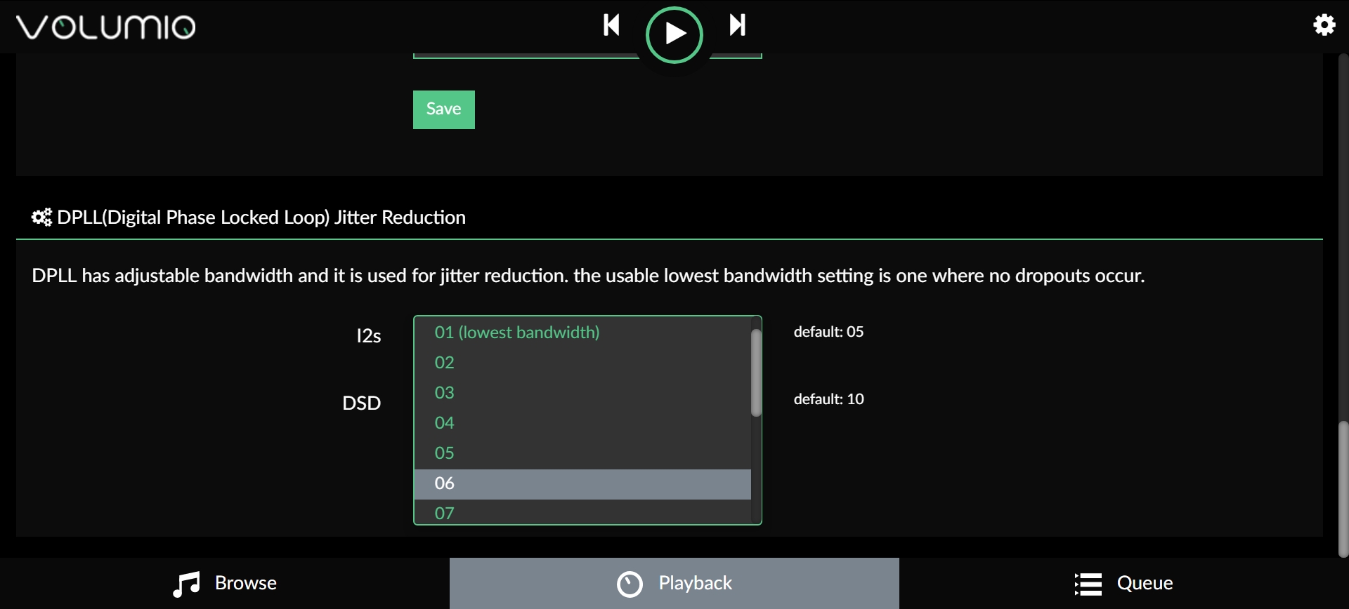

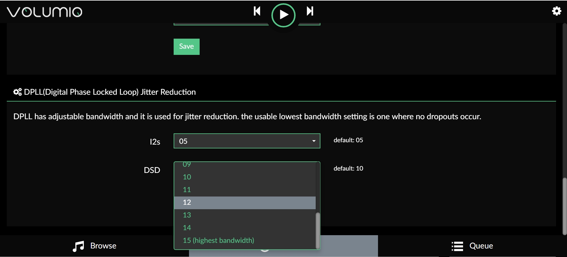

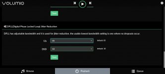

I now have adjusted ferrites for the third time to achieve DPLL stability at a setting of 2 out of 10, after having fully removed and replaced them each time. Therefore, the effects are repeatable. But, adjusting the ferrite positioning to effect stability at 2 out of 10 is very critical, maybe sometimes as little as .001" which I am adjusting using an adjustable dial indicator holder to position a plastic stick touching against a sensitive spot on the bag of ferrites. Unfortunately, I can't tell exactly what is being affected.
I did notice that pressing against the 22uf tantalum filter caps at DVCC and VCCA pins on the side of the dac by the SPDIF and TOSLINK inputs has a noticeable effect on DPLL stability. I can sweep through it to some extent by pressing on the caps with my fingernail or a long pointy plastic stick. I am thinking that maybe going to more mechanically stable caps could help remove another confounder.
In one sense the extreme sensitivity in affecting DPLL stability is almost silly at this point. However the sonic advantages of what appears to be extreme jitter reduction are worth trying to understand. I am getting rid of remaining brightness in the output sound and hearing details in cymbals from a CD recording very similar to DAC-3. In other words, it appears I am getting jitter down around where it must be in DAC-3, but doing it by another means that works with 100MHz clock on the dac chip. Very interesting, is all I can say. The question is can I figure out how to get practical control of it and keep it stable enough over time?
From doing experiments here, it is clear that careful control of RF fields in the vicinity of the dac chip is critical to optimal sound quality. Trying to do that with a 2-layer PCB may end up being impractical for everyday use. A 6-layer board would probably start to make a lot more sense from the perspective of seriously trying to make a great dac. But, I am willing to continue to try to see if I can come up with something that diyer's can use with dac the board we are working on. Don't know how it will turn out exactly, but I will try to keep you all posted on developments.
