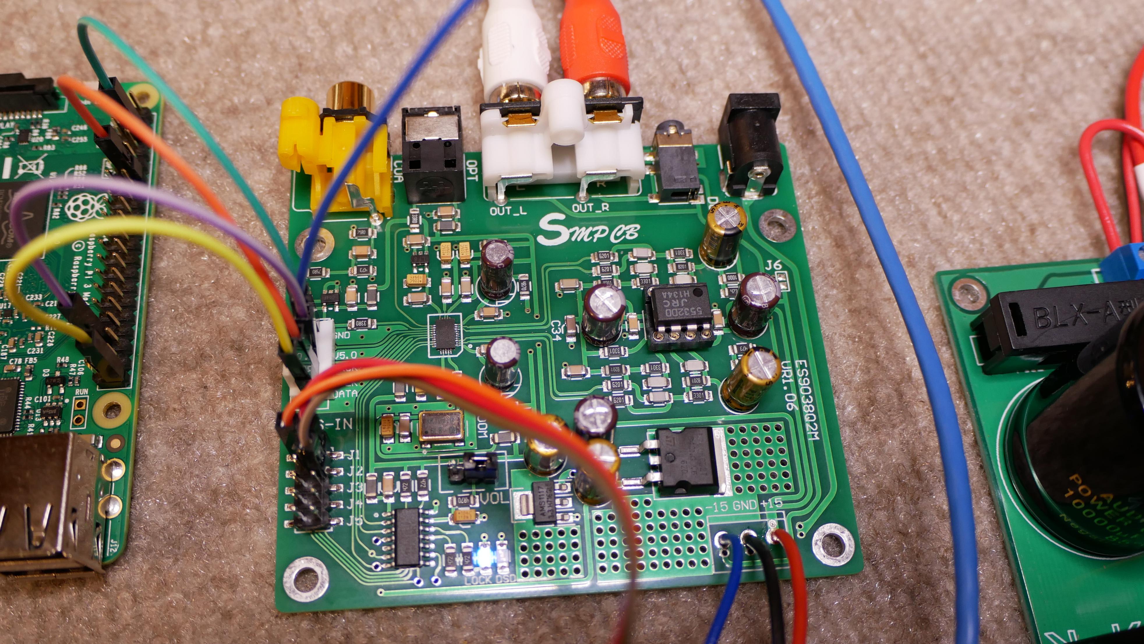

Electrically, I had everything connected properly.(It's playing now!). I'm a new user of Roon and was unaware that RoPieee has a configuration setting for selecting a Pi using I2S. Once I selected that option rebooted RoPieee she started singing like a bird. I'm glad I finally got around to playing with I2S output on the Pi. Before it's all been DAC hats - many of which are Plug-n-Play. This opens up a whole new realm of using DACs and the Pi. Great knowledge for my projects ahead.

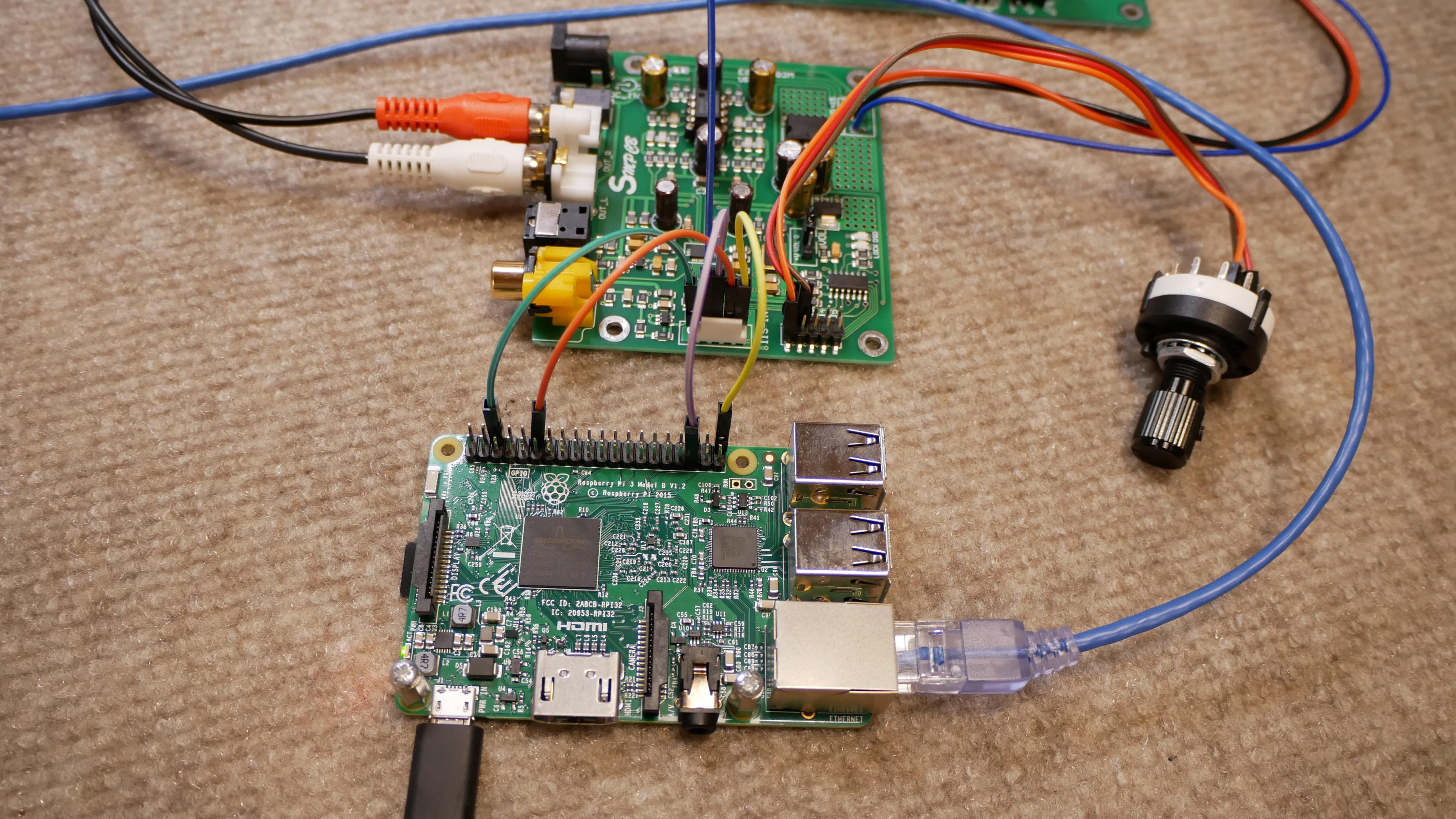

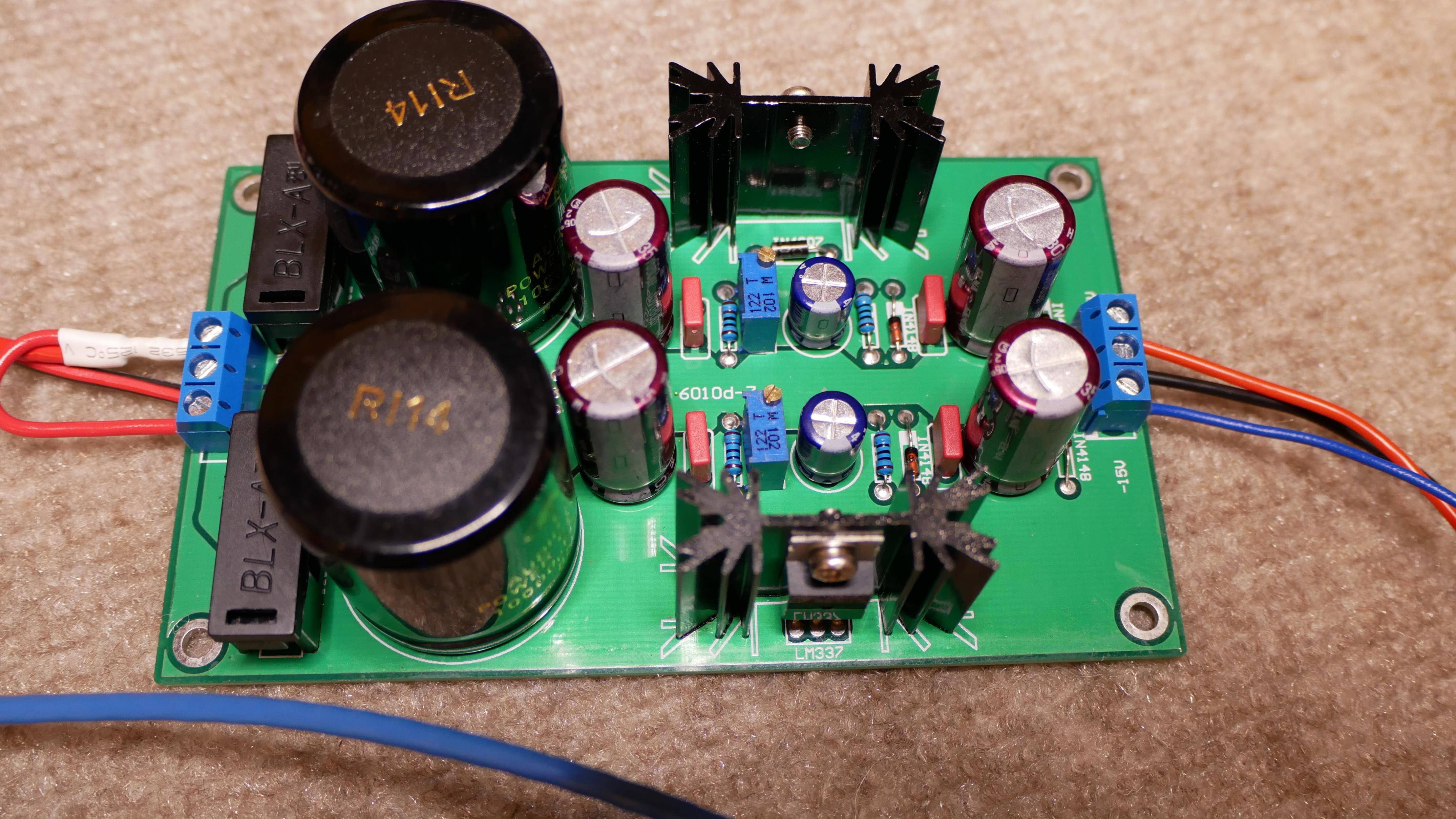

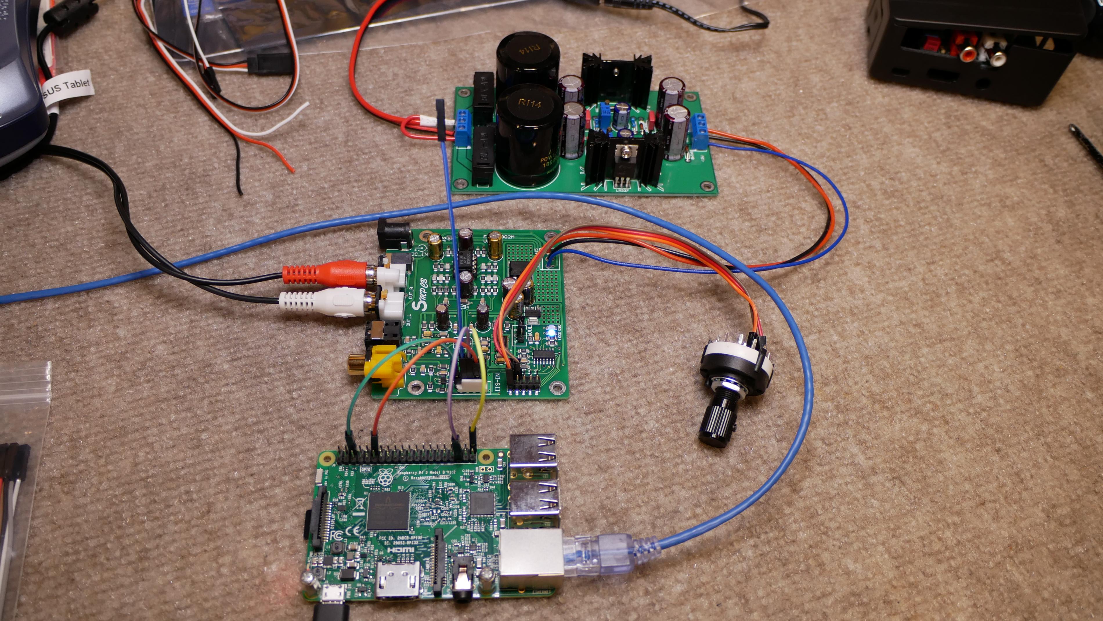

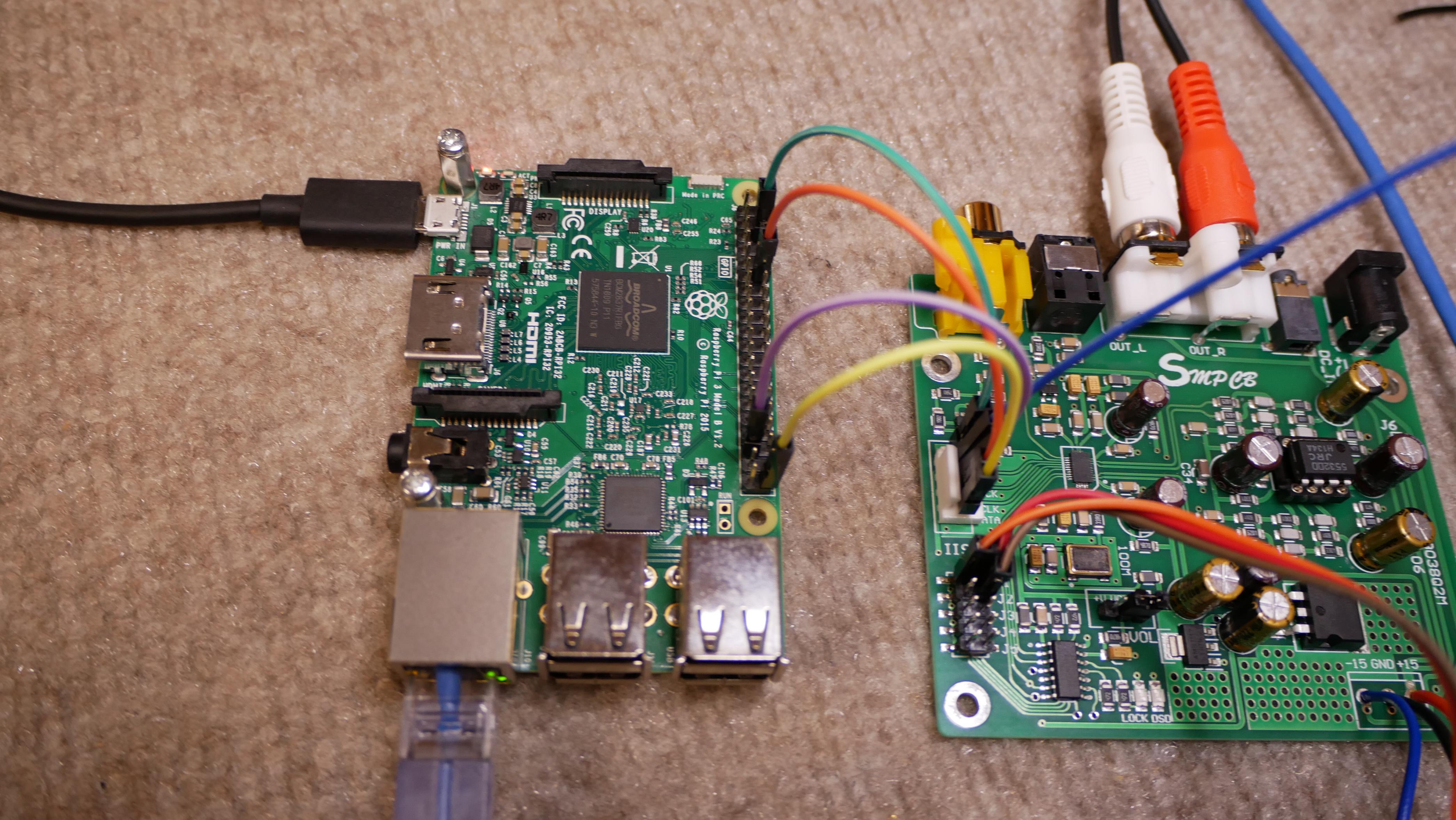

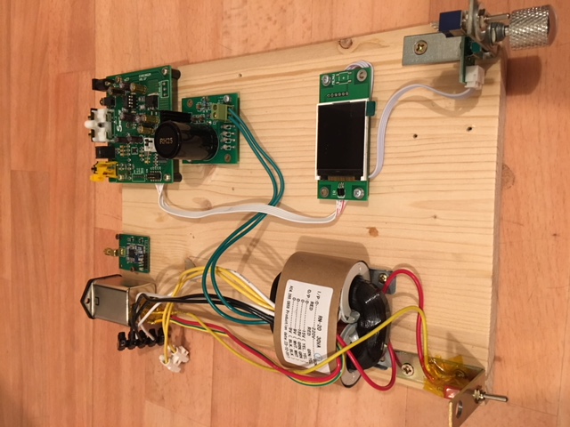

Here are a few pics of my setup on the bench.
Very nice, and thank you for sharing. We like to see what setups look like.
However, if it is okay to say so, I see many opportunities to improve sound quality, if that might be something of interest. Some very noticeable improvement might just come from adding another $32 or so board to the setup. Namely, one of these: AK4137 I2S/DSD Sample Rate Conversion Board Support DOP input digital lcd | eBay

Thanks for those great suggestions. At the moment, what you see is just my prototype. Once I decide on how I'm going to implement this project, proper enclosure, layout, display options and proper cabling decisions will be made. This setup was simply to prove to myself I could get it all to work! I have been looking at this display here as a possibility. Your links look interesting as well, so I'll keep those in mind.Very nice, and thank you for sharing. We like to see what setups look like.
Ummm, Gee, I don't know. Are you one of those people that puts looks above sound quality? If so, you are not alone.
If great sound quality, and I do mean great, not merely good, great is an option for not too much money starting with the board you have now. But, if you decide on a case and so forth before deciding on sound quality, you almost certainly will end up painting yourself into a corner, so to speak.
Some of what you might want to do could take up more space than you might allow for now. Not necessarily a whole lot more, but not hard for it to be enough not to fit in a cute little case.
I haven't decided on a final case for my dac like that yet, but I do have a test setup which takes up more space than what you have. I have a bigger and better quality +-15v power supply and also a very clean and stable +5v supply. Then I have the dac board, the sample rate converter, a small headphone amp board (which is strongly recommended), and an Arduino (instead of an RPi).
