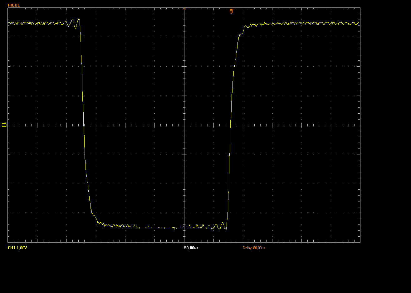

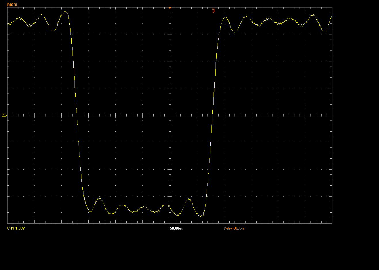

That second image is of a linear phase filter, the pre-ringing can be easily seen just before the square wave edge transitions.

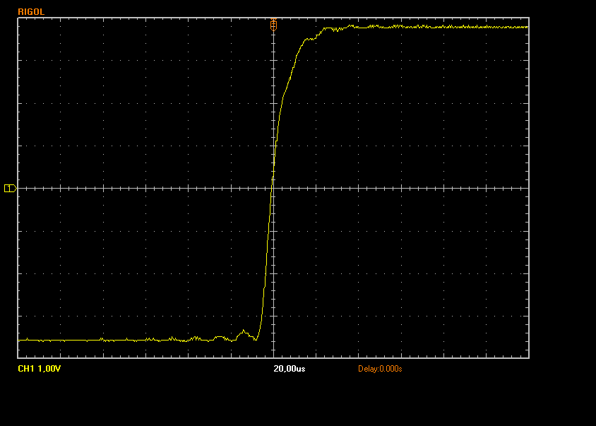

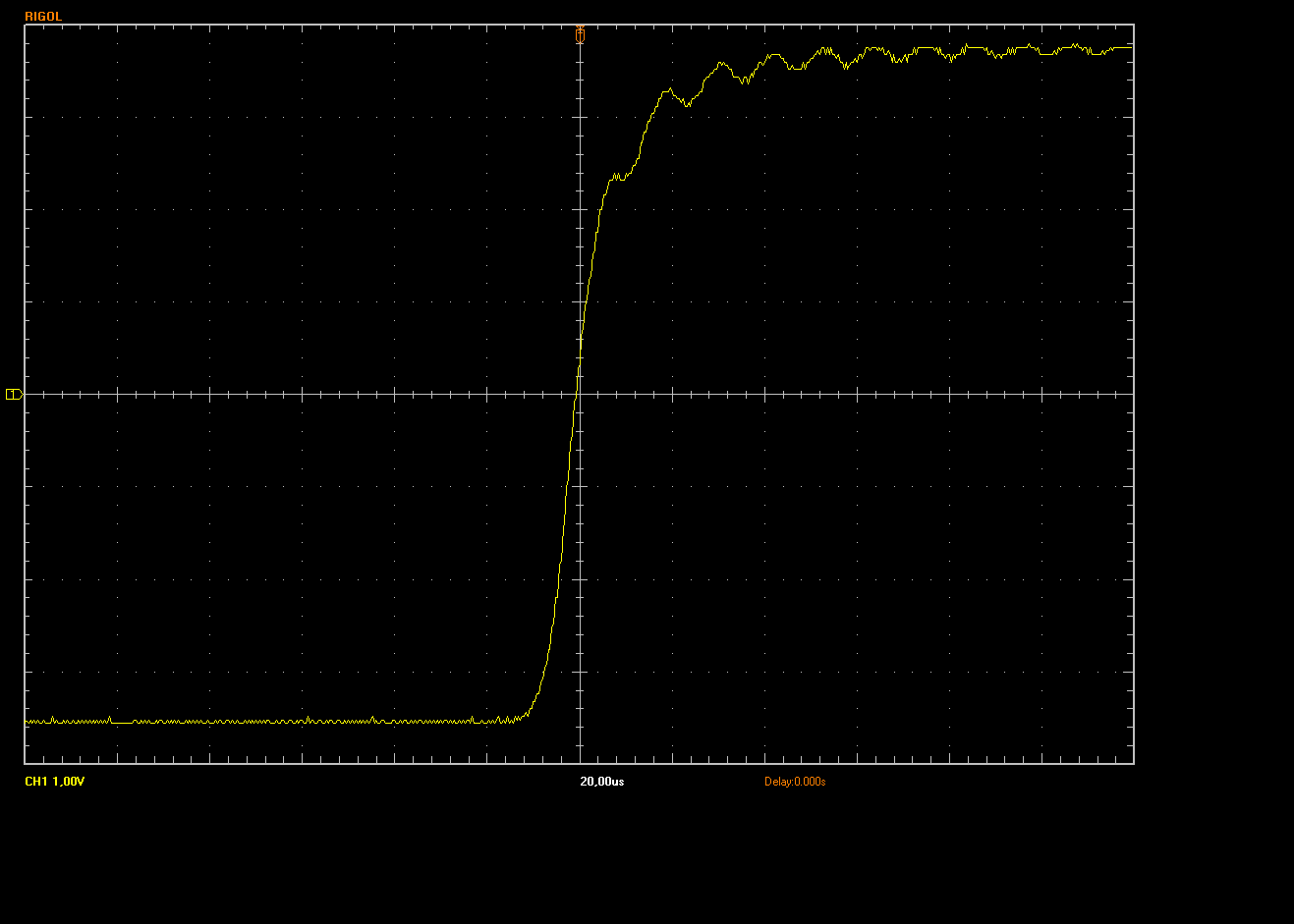

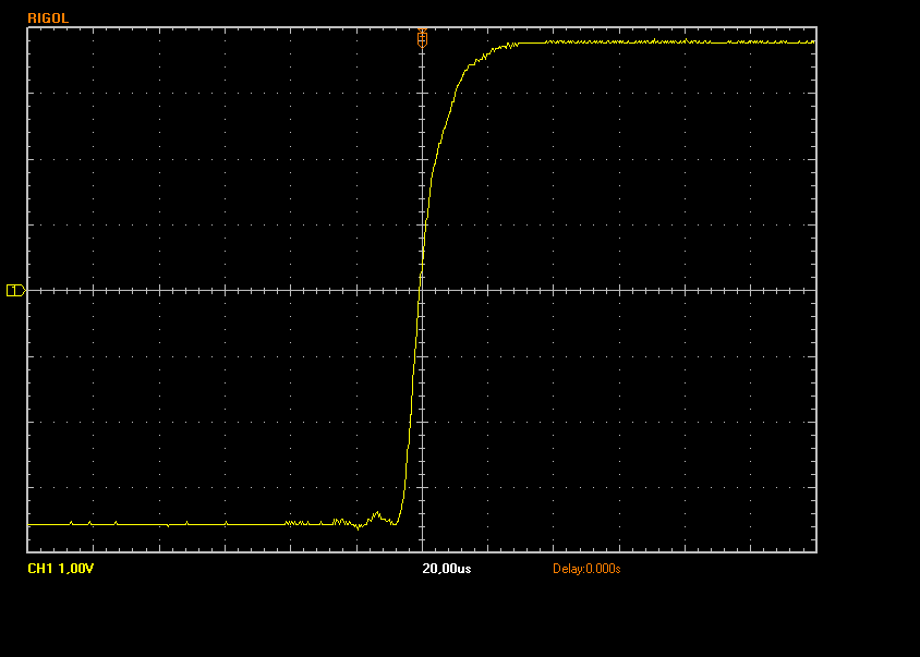

The linear filters look to me like there is pre-ringing. Not for the Apodizing filter though.
What should happen normally is since time flows from left to right in the scope images, any ringing should decay with an exponential envelope as time passes. It would be more obvious with a lower frequency square wave, but the linear phase filters look more flat and symmetrical across the tops, as compared to the other filters which seem to be settling or decaying a little bit as time passes. So, my interpretation of the images is that there is pre-ringing, but I would like the square wave at a little bit lower frequency to see a little better.

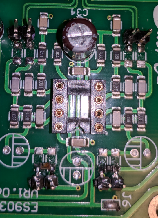

I got my 9038q2m board few days ago (VR1.06). <snip>

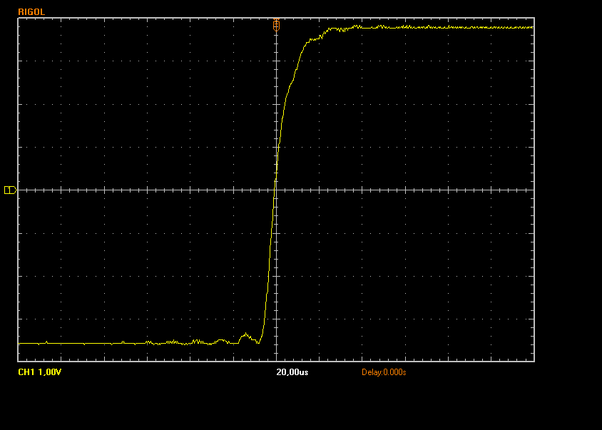

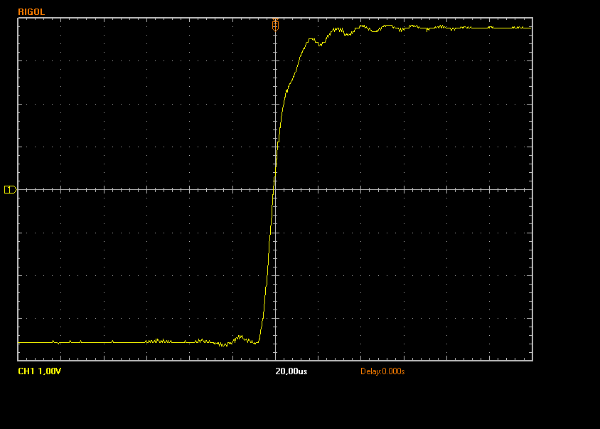

It depends on the sample rate of the source PCM. I have changed LPF to "slow roll-off minimum" = J4 and J5 shorted to GND

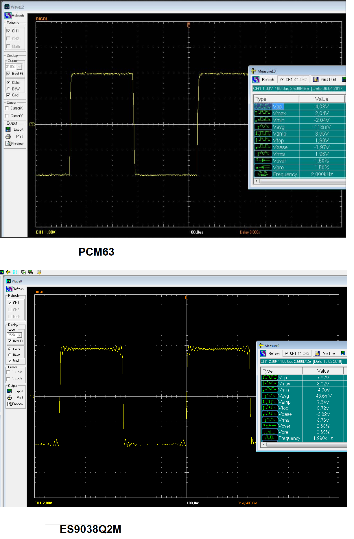

Here is comparison: 48k vs 192k (2kHz square)
48k
192k
And here is near-edge zone of 20Hz square (SR=192k)
Thanks for doing that. It sure looks like linear phase pre-ringing to me.
Say, I wonder if the seller was trying to say the jumper settings are inverted only for the filters?
In that case might we be looking at a linear filter? Just wondering. It would probably be helpful to many people wanting to use these boards if we could verify the filter jumper settings are correct or inverted.
If you don't mind, would you please post some pictures on how to install your transformers onto the board (what components to remove and where to connect). Thank you for your help in advance.
It is very simple procedure.
All you need is just to remove 4x6.2kOhms (labeled as 6201) resistors which are between 9038's diff outputs and OPs. Primary coil of the transformer should be connected to +and- of the channel. OPamp is better to remove from the board to save power. And if you want to use RCAs of the board, it is needed to remove 2x(100and47k) Oms resistors to connect secondaries between signal and GND (of the RCAs in fact). Between the PLS pins of secondary coils I have soldered 10k (value of that loaded resistors depends on transformer specs).
Thanks! I guess I'll have a better idea when I get the board. If the tracks on the board are easy to trace, the connections should be obvious.

But I captured all the variations of LPFs. I will post them by order of the graph mentioned. To get know who is who, just read the name of files...
