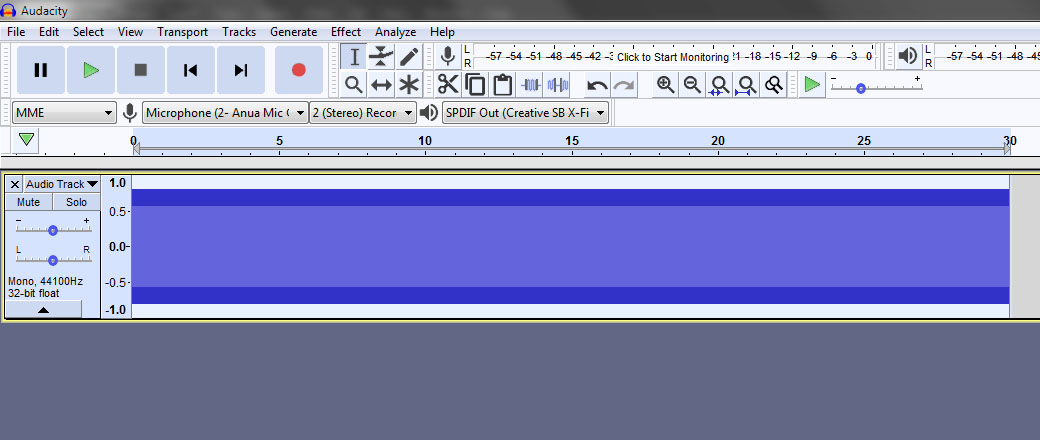

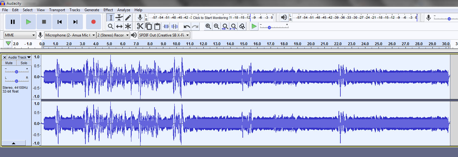

In an effort to try to get a clearer impression of the sound my board is producing, I generated a continuous sine wave tone in Audacity:
attachment.php
I then played this tone and recorded what it sounded like through my existing hifi setup using the DAC in my Yamaha DSP-E800 using my Auna CM-600 condenser microphone:
attachment.php
You can hear the sound recording here:
01.wav - Google Drive

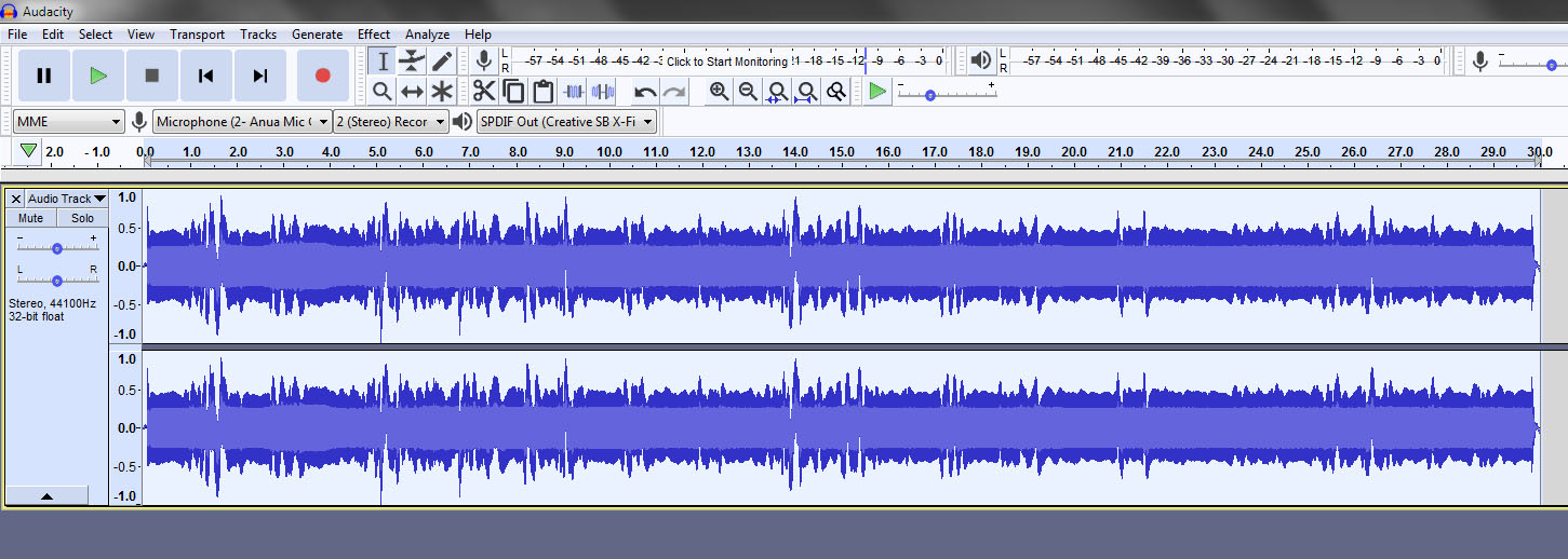

I then hooked up my ESS board instead of the Yamaha's DAC and repeated the process and got this:
attachment.php
02.wav - Google Drive
The first thing that is immediately obvious is the large change in pitch, the ESS is much higher pitched, indicating there are no low frequencies. You can hear the distortion too, the tone sounds modulated.

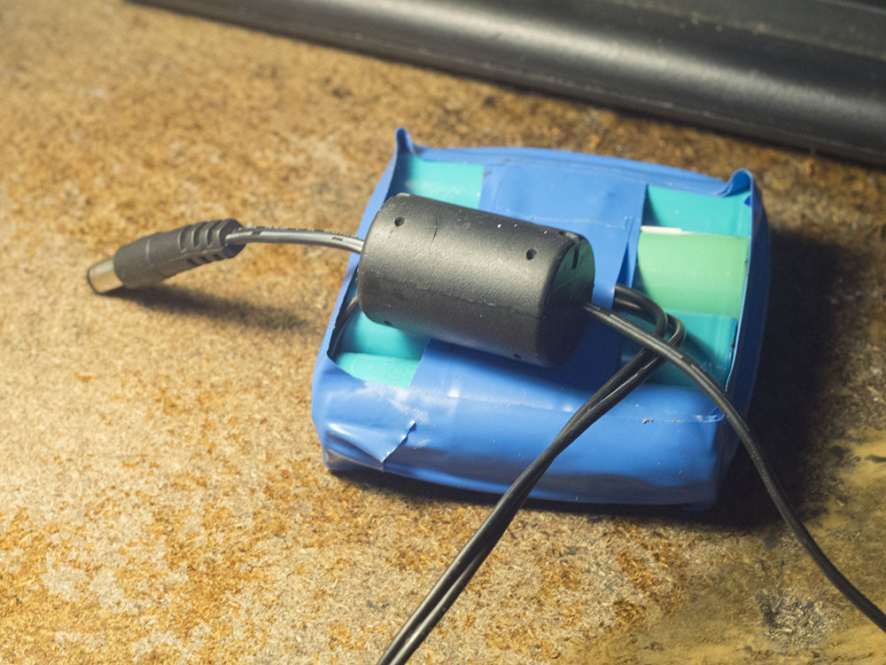

I performed this test using a battery to power the ESS board, to give it a nice, clean DC source and eliminate the PSU as the source of issues.

Ian, The DAC recording is louder than the first recording. The second one might be clipping somewhere. It sounds distorted, which mean more high frequencies are created by the distortion process. Relatively speaking, that makes it sound like there is less bass. Don't confuse more highs for less lows. Make sure levels are the same and not clipped. Best to turn down the digital signal going into the DAC by 3.5dB then add a volume pot to the DAC and adjust it up and down to make sure it sounds the same at all volumes and not worse at higher volumes which might mean clipping somewhere.
Also, expand out the time axis in Audacity until you can see the waveform for one cycle of the audio tone. It should look like a sine wave like you would see on an oscilloscope. If you have the time axis too compressed you can get aliasing in the visual depiction of the waveform.
I equalised the volume of the recordings in Audacity because the ESS one was a lot quieter. I'm pretty sure there is no clipping.
I'm also pretty sure there is no bass because when I listen to music through the ESS board, there is no bass at all, just a lot of treble and some midrange.
I can do another test and modify how I do it if you think this one is flawed, I'm not at all experienced at audio testing so I'm more than happy to be guided.

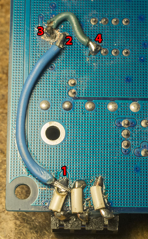

Here's the current state of my board:
attachment.php
I had to scrape away the ground plane around 3 (the cap's negative pin) because it was shorting to ground. I then directly connected this pin to 4, which is pin 8 of the op amp. As far as I can tell, the only SMD parts I have bypassed by doing this is a single tantalum capacitor.
Here's the simple battery pack I quickly threw together from four Samsung 18650 cells:

Ian... I can say only what a xxxx are you doing.
You are like a butcher not someone with electronic skills. Sorry for hard word. But your posts are cuting down nice fluently progress of this thread. It is normal that noone want to help you.
First unplug power supply.. Pull out opamp. Connect 12v to dac and lets go to work. Put gnd probe on gnd pin and measure all 8 pins on opamp socket....WITHOUT OPAMP!!! Turn the multimeter to 20v Dc position.
First connect green wire to blue one. Now you can have pin 8(4) connected from cap to pin on top route and under with green to cap what is gnd and you have short circuit. Or at least cut or unsolder green wire away. It is uuugly soldered to opamp pin... Thinny part is maybe touching next pin.
