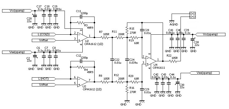

What can be done with that impulse signal from the op amp perspective ? It looks to has aprox. 10khz-20khz frequency for fundamental signal with a lot of harmonics. Any decent op amp can reproduce that but the problem is not at op amp. Most likely that parasitic signal need to be filtered. Can you share us entire paper ?

For DAC with the voltage output (AK440x, for example) is possible to put passive Low Pass filter (RC) before OP, bit for the DACs with the current output it is more complicated.

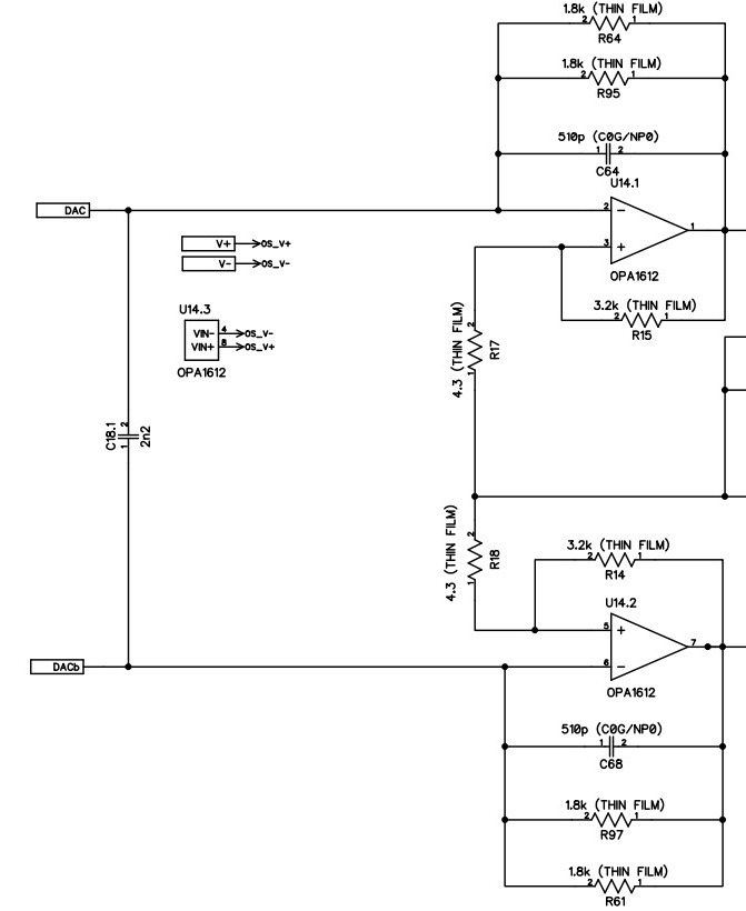

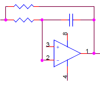

1st it's not about current, it is about voltage. At the output of the I/V converter is voltage and the opamp must achieve a virtual ground (very low impedance) at its minus input. The op amp itself has nothing to do with the current coming from the dac, it works only with the voltages both at the input and at the output. The resistor Rf should work with that current, not the op-amp. The op amp just keeps the voltages where they should be. A capacitor, Cf, is placed over the resistance Rf, which has the role of having a very small capacitive reactance at the frequency where there is noise comming from the DAC. So, in that situation, the voltage of the noise at the output of the op amp will be low enough so that the reaction speed of the decent op amp will not be exceeded. The noise with Mhz range it should be removed with the next stage, LPF. In my opinion, the op amp is not the only important thing, but rather we need to see the wiring and the parts. That is, the parasitic elements involved there become extremely important. These parasitic elements must be minimized so that the filter scheme works correctly. The grounding route is essential as well as the energy supply.1st of all - it is not a voltage, it is current (we are talking about I/V?).

What you said is a basic model of a dac and an opamp and how they interact together. It turns out the reality is more complicated, especially in terms of what kind of noise and transients are present on the analog outputs of a modern dac chip such as ES9038PRO.1st it's not about current, it is about voltage. At the output of the I/V converter is voltage and the opamp must achieve a virtual ground (very low impedance) at its minus input. The op amp itself has nothing to do with the current coming from the dac, it works only with the voltages both at the input and at the output. The resistor Rf should work with that current, not the op-amp. The op amp just keeps the voltages where they should be. A capacitor, Cf, is placed over the resistance Rf, which has the role of having a very small capacitive reactance at the frequency where there is noise comming from the DAC. So, in that situation, the voltage of the noise at the output of the op amp will be low enough so that the reaction speed of the decent op amp will not be exceeded. The noise with Mhz range it should be removed with the next stage, LPF. In my opinion, the op amp is not the only important thing, but rather we need to see the wiring and the parts. That is, the parasitic elements involved there become extremely important. These parasitic elements must be minimized so that the filter scheme works correctly. The grounding route is essential as well as the energy supply.

Combine this with glitch-killer capacitor you get a nice 2nd-order lowpass with ESS' "current" output which appears to be switched currents cells to GND pulled-up with an on-chip silicon resistor, so actually medium impedance. The series resistor appears as series input impedance at audio frequencies and can be counteracted with a little bit of positive feedback from the output (ESS seems to do this feedback for the ES9039pro to even compensate bonding/metalization resistances so that the silicon resistor effectly see zero voltage modulation, for lowest distortion).Better to use Rauch MFB in I/V
Yes, because ESS9038Pro output is not real "current output" but voltage output with 200 Ohm series resistor.Combine this with glitch-killer capacitor you get a nice 2nd-order lowpass with ESS' "current" output
