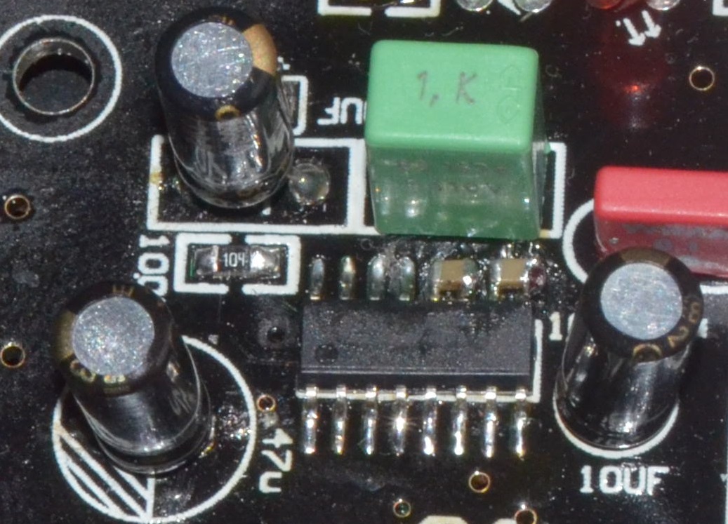

I see the amp is missing an output filter (10R + 0.7uH) in the datasheet. Also the supply routing have one shared ground return. Decoupling is poor also. Datasheet says this can cause distortion so I try to fix this as the next job.
"to improve system performance as well as eliminate possible oscillations, the LM4766 should have its supply leads bypassed with low-inductance capacitors having short leads that are located close to the package terminals. Inadequate power supply bypassing will manifest itself by a low frequency oscillation known as “motorboating” or by high frequency instabilities. These instabilities can be eliminated through multiple bypassing utilizing a large tantalum or electrolytic capacitor (10μF or larger) which is used to absorb low frequency variations and a small ceramic capacitor (0.1μF) to prevent any high frequency feedback through the power supply lines."
I add 10uF SilmicII 35V and 100nF X7R 50V in pair across 3 supply lines on chip pins. 2 (VCC) to 5 (gnd), 4 (VEE) to 5(gnd) and 15 (VCC) to gnd. I use wire through a via on pin 5 (ground) to bottom side of the pcb. I cut trace between pin 5 and 10, and add wire from pin 5 to star ground for separating the ground return.
Sound is better, but still the quiet piano is not nice. :dunno: For example, Adele, Someone Like You. Vocals, bass, etc all very good. high quiet piano is little bit distorted.
I think it must be the DAC or digital circuit. So I try you idea Mr Hobbit - lower digital volume. This solves the problem. THANK YOU ! So I must try other R8 ? Or check digital circuit ? -4dB is enough.

I fix the distortion. There is too much gain. The Rf/Ri is 23K/630 in the kit so Av = 37 . Now it is 23K/1.2K so Av = 20. Input is 2K/23K from 2V rms, so input is 1.9V max. Output Max is 20 x 1.9V = 38V rms. It is already higher than the power supply.
Now at the last I can say I am satisfied with the sound quality.
Resistor change is easy. No extra parts. And then sound is correct. :D

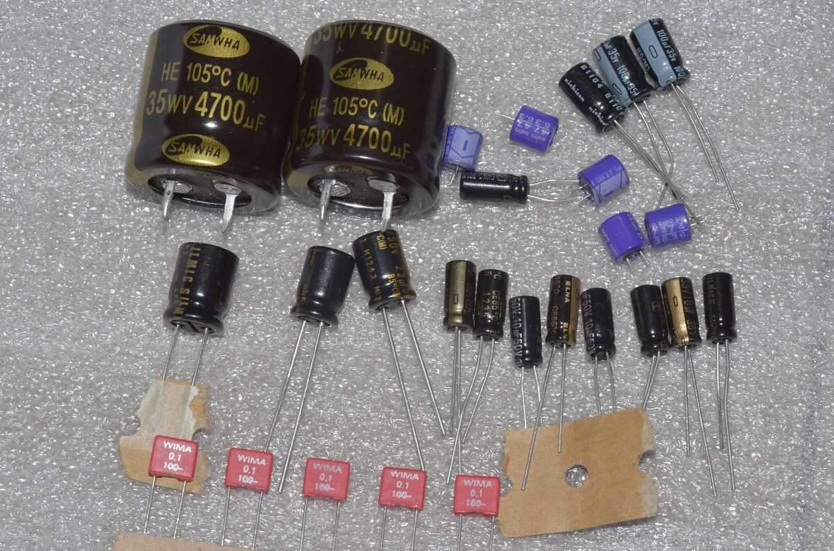

I also change main cap to 10,000uF Nichicon and digital power cap to 1,800uF Elna.
Burning in.... but wow... super bass from my little bookshelf speaker :eek:
