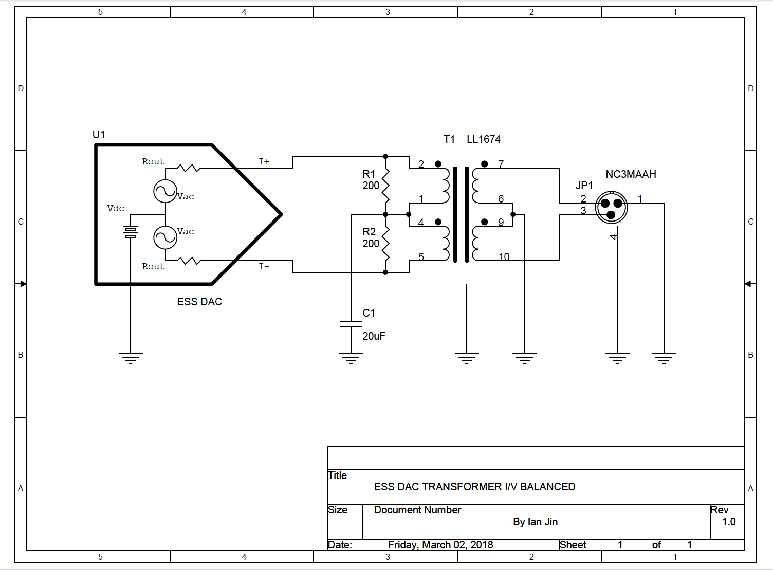

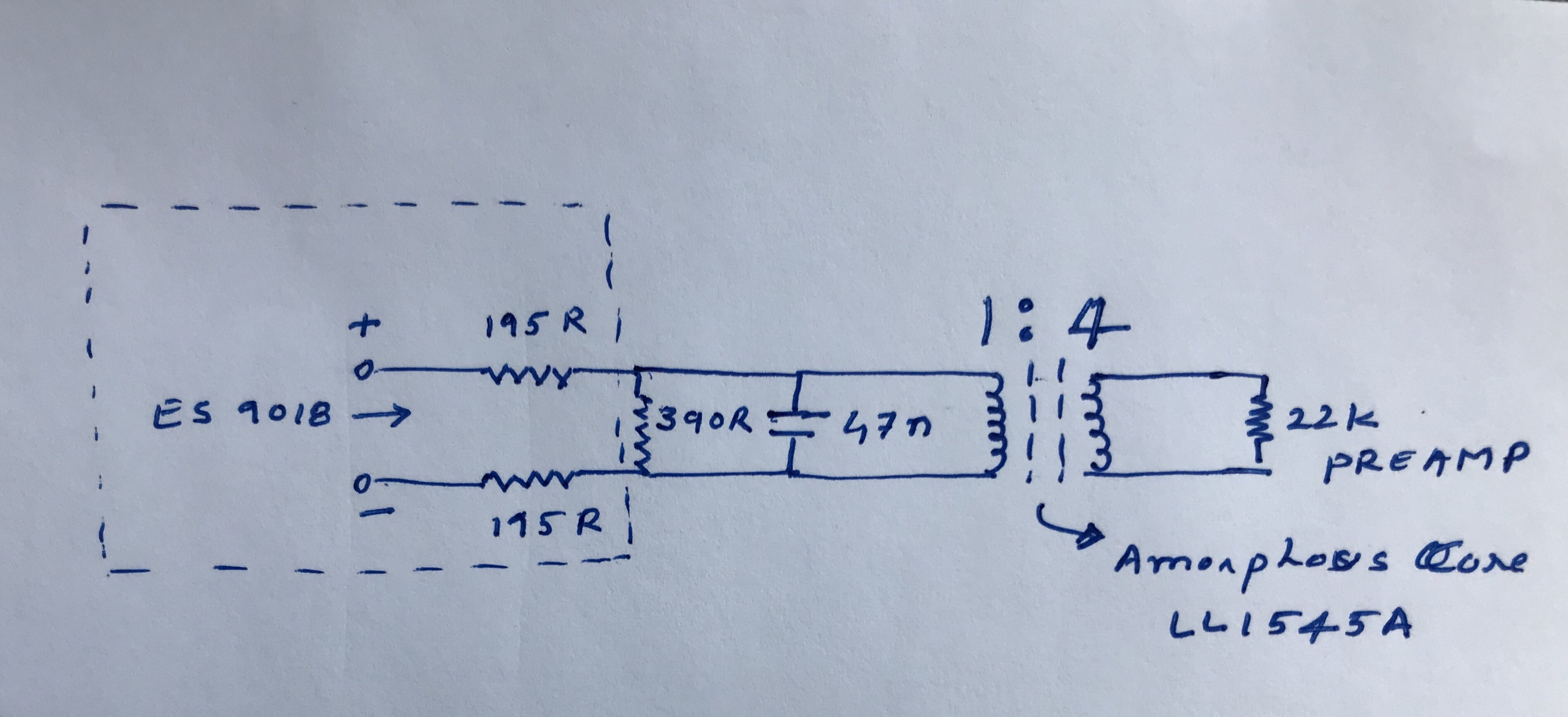

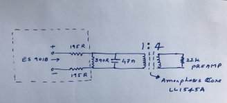

Hi Greg,
That's great approach, I'll do similar listening test. I'll focus on difference between ES9028Q2M and ES9038Q2M, as well as LL1544A and LL1674. I'll post some details then.
I'm figuring out the schematics of LL1544A at 1:4 configuration. I may need your advise before I start the test.
