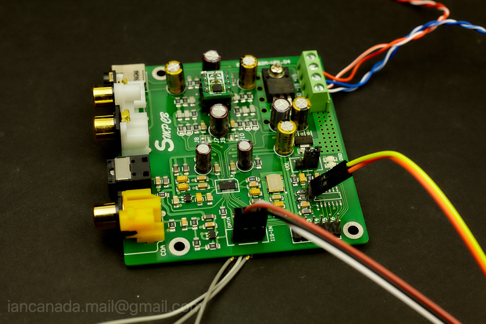

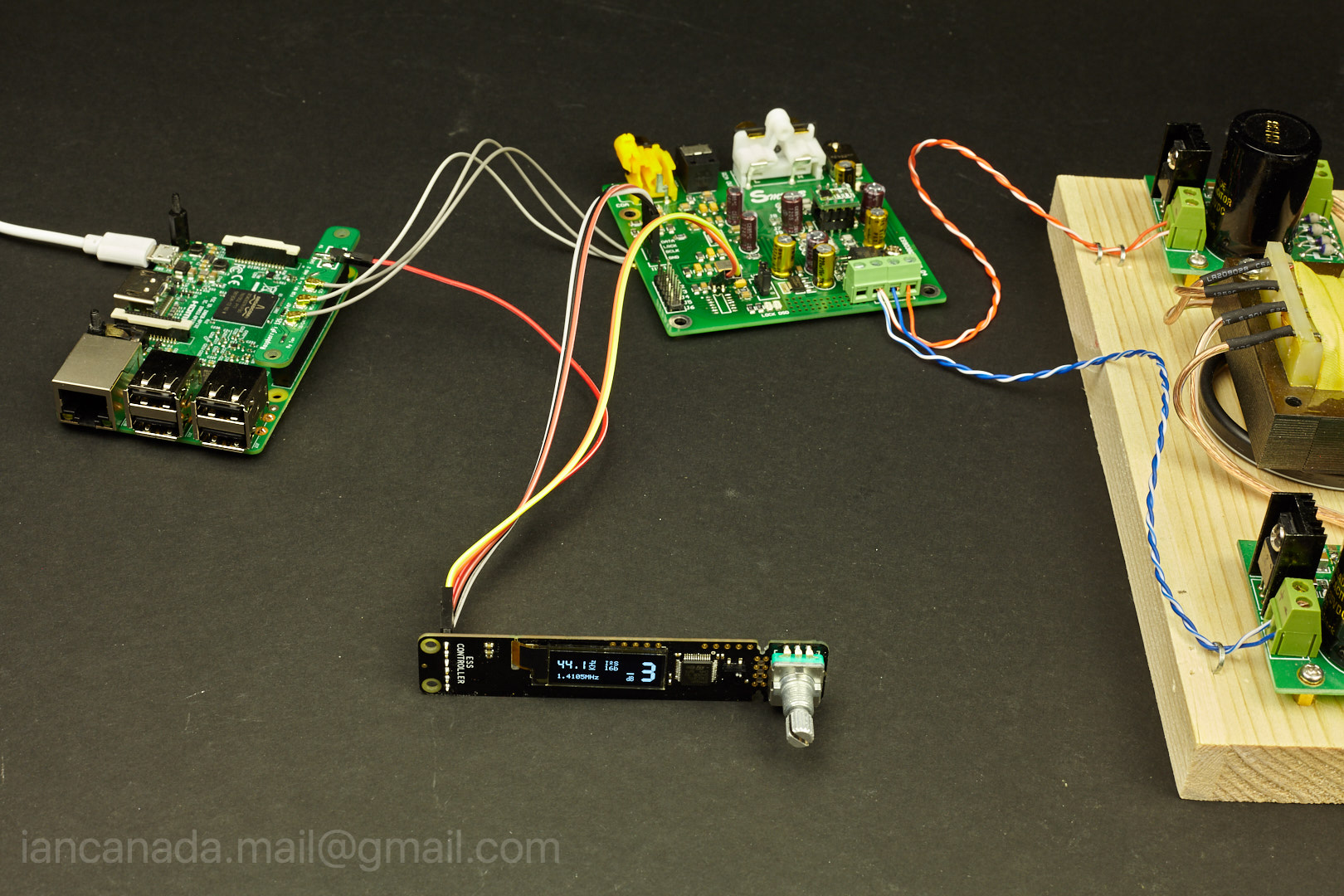

I bought this ES9038Q2M DAC last year, just want to confirm my ESS controller works for third party ESS DACs.
Yes, it works.
This DAC was fine. The only two issues I had with my RaspberryPi 3 are:
1. It doesn't support 44.1KHz 16bit format, got big noise for this format.
2. It doesn't play DoP music correctly, the sound was just like kind of water flow( maybe the version is too old).
With my ESS controller, all above issues are fixed. DAC chip-id was recognized as ES9038Q2M. It plays 44.1KHz 16bit music nicely, as well as all other formats. The DoP was also been enables and plays without any problem.
Please see pictures for configuration details.
Some experience to share:

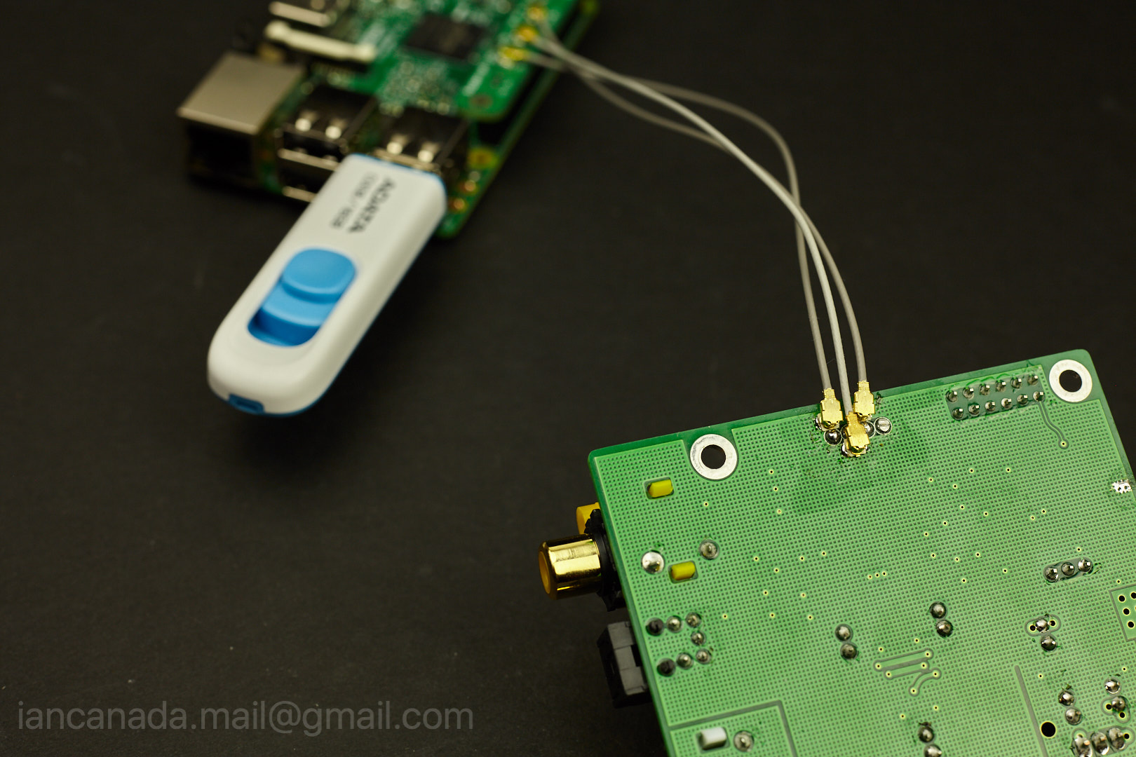

1. u.fl coaxial cables are tested much better than regular jumper wires for input signals. One of the pictures shows how to mount u.fl socket at bottom side of the DAC PCB.
2. The on-board MCU has to be removed in order to use external ESS controller. Two I2C pins can be soldered right on top of the pull-up resistors.
3. When I replace the original OP with OPA1622, I got some improvement on sound quality. It can also drive my Sennheiser 300ohm headphone.
Ian

Very nice little controller! :)
I see that you have also routed the I2S signals from the dac board to the controller board. Why is that? Is your controller monitoring these lines to determine bit depth / sampling rate?
Thanks Dimdim,
Yes, I designed a built-in music format analyzer in the ARM processor.
To me, this is not just something nice to have. I really need it to run ESS DACs at higher performance.
1. With this true signal format analyzer, precision control can be performed.
Sample rate, clock frequencies, X*Fs, date length, PCM/DSD/DoP format....All those information can be taken into consideration at same time and at real time to decide the most optimized DAC settings.
2. Make it possible to run ESS DACs at synchronized mode
Sound quality will get big improved if ESS DAC is running at sync mode. However, under sync mode, internal DPLL will be in "free wheel" state. And the MCLK is also not fixed at given frequency. No any useful information can be provided from internal registers. So in this case, have to do real signal monitoring to get music information,
3.Make it possible to silence the I2C communication between ESS DAC and controller while music is playing.
Otherwise it has to access ESS internal registers over and over to get some music information(still can not cover sync mode).
Ian

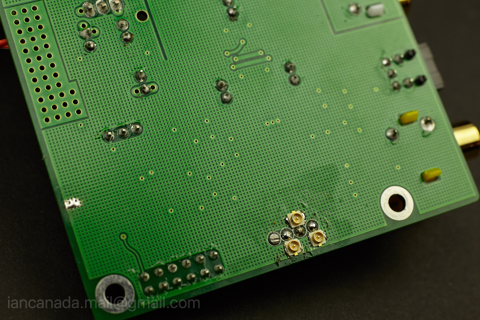

Ian, awesome job with the u.fl sockets! Could you please share some information about how you managed to solder them to the board, as there are no pads.
Also, how did you connect the ground to sockets?
@nielsek
Scratch the solder mask (green paint) under the GND pads of the u.fl socket. Solder GND pads of the u.fl socket to the ground plate of PCB with signal pad facing to the signal pin. Solder the signal pad of u.fl socket to the signal pin.
Do the same to all three u.fl sockets.
Ian

@nielsek
Ian
@nielsek
Hope this picture can show you how to solder u.fl sockets to this ES9038Q2M PCB.
Ian
