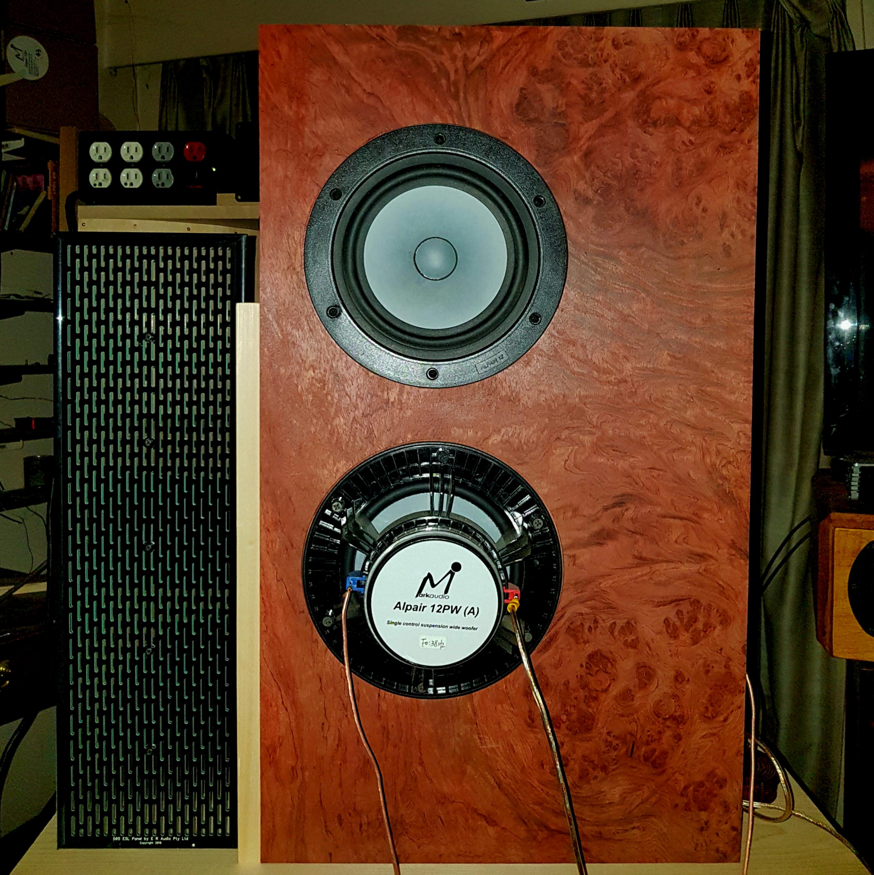

Not sure if anyone is still following this thread, but I'm still settling on driver matching , and configuration.
I've mostly settled on Alpair 12PWs for midbass duty, (but may change this to a cardioid RSS265HF-4 for midbass, mounted above another in a sealed cabinet) bypassed the high pass capacitor,and am using an active 2 way analogue crossover, 4th order, preceded by a digital preamp crossover to a sub.
Crossover points are 2nd order at 90 hertz, and 300 hertz, 4th order.
200 hertz sounded a little thread bare for these panels.
I prefer these to the horns, planars, full range, and conventional driver projects I've done in the past.
Can't seem to make the treble "crisp" or "etched" on any music so far; I find that a good thing.

Here's a picture of recycling in progress.
I think that's an inherent quality of ESL's. I've never heard one that sounded harsh or distorted except for a Quad that was clipping at high volume.
They have three vertical sections, here's what Rob from ER Audio wrote:
The HF section is 30mm wide, there is a non conductive boundary approx 3.5mm between the centre and side sections. The conductive width of the side sections is 43mm.
The active width (between the inner edge of the spacers) is 132mm, the active length is 487mm the actual conductive surface is 480mm long.
The air gap is 1mm
