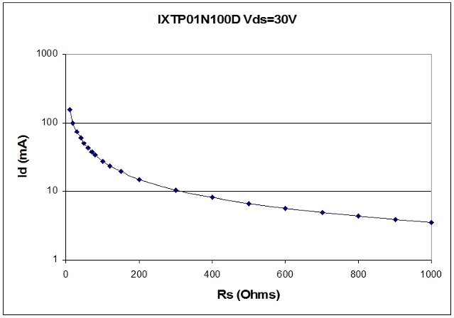

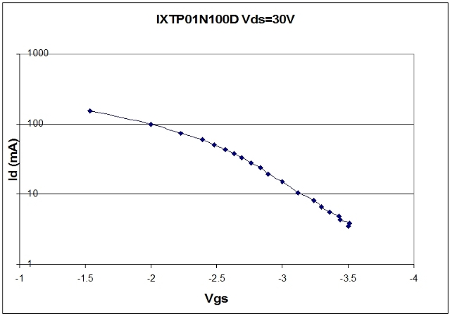

01N100D - info not on the datasheet
These are promising parts with nice low capacitance, great working voltage, etc. and also have the benefit of relatively large Vgs at tube amp currents - this makes it nice for the top device in a cascode because it gives the bottom device some Vds to work with.
I purchased a tube of them to try out. Here are some curves I traced out, which are not published on the datasheet.
