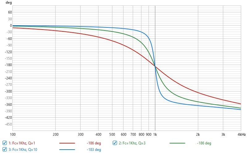

If you install REW you can measure the processing done for each channel using a cable loopback at the soundcard, It's a good idea to check the jack line
level outputs this way before connecting the amp and speakers.
This is the response plot of the EqApo Allpass measured by REW using a loopback. It looks like a 2nd order. Where Fc=1Khz and Q=[1,3,10] for comparison. You can also use polynomial function to create a different AP form if you want.
