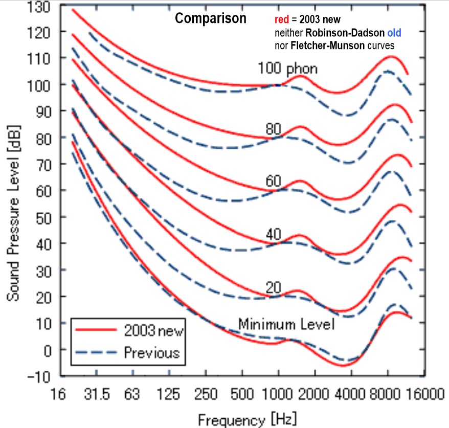

If you want a spanner in the works I can throw you several :
a) The FM curves are equal loudness related to fixed levels
at 1KHz. Whilst it is clear in those curves response to levels
varies at different frequencies, by necessity they include the
ludicrous assumption @ 1KHz ear response to relative levels
is perfectly linearly logarithmic.
b) So FM curves don't tell you how loud it actually is, and
annoyingly I've never seen an attempt to quantify the
perception of different levels @ 1KHz.
c) If your confused say move the the reference point to
3KHz and assumed that is perfectly linearly logarithmic.
The curves will change but won't tell you any more *.
d) IMO you cannot assume any frequency is in any
way is perfectly linearly logarithmic, much to my
frustration in the way F&M information is presented.
e) So if you have twigged F&M curves show equal
loudness curves relative to completely arbitrary
levels at 1KHz, they don't tell you how loud it is.
rgds, sreten.

80 year update!
ISO 226:2003 (/2008)
Acoustics -- Normal equal-loudness-level contours
Abstract
This International Standard specifies combinations of sound pressure levels and frequencies of pure continuous tones which are perceived as equally loud by human listeners. The specifications are based on the following conditions: the sound field in the absence of the listener consists of a free progressive plane wave; the source of sound is directly in front of the listener; the sound signals are pure tones; the sound pressure level is measured at the position where the centre of the listener's head would be, but in the absence of the listener; listening is binaural; the listeners are otologically normal persons in the age range from 18 years to 25 years inclusive.
See this great thread at ... the grumpy place:
http://www.diyhifi.org/forums/viewtopic.php?f=11&t=2289&p=47818&hilit=fletcher+munson+curves#p47818
