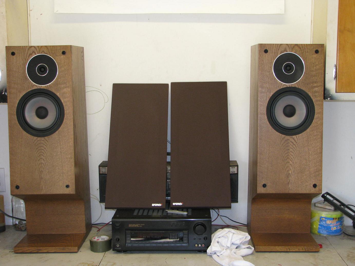

FNG here, I just stumbled on to a set of Energy 22 RC's at a local garage sale.
bought them just to sit out in the garage while I am tinkering. That was until I researched what they really are. needless so say they won't be hanging out in the garage to long.
Both tweeters are done, but I am really considering sending them to ABI.
The pair are in otherwise great shape.
they are the natural oak finish.

Not only was it a garage sale but I was not even really garage sale shopping.
I was dropping my daughter off at her friends and they were having the sale by chance that day. I saw them and the cabinets looked good to me.
I am not rubbing it in, I am really amazed that I was this lucky. I am usually on the short end of the ugly stick

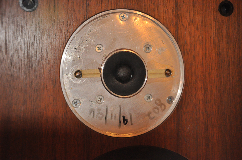

Hi All - I'm a complete and total n00b, but am the proud new owner of a set of Energy Ref Connossier 22's that I was handed down by my father who recently upgraded his home stereo system. Growing up, I had always loved how they sounded and was thrilled when he offerred them to me.
Unfortunately, upon bringing them home, it appears I have a dead tweeter in one of the cab's. (I'm a guitar player and the way I'd describe it, the tone is turned all the way to 0 with just a ton of muffled bass and a little bit of mid.) That's likely a dead tweeter, right?
Whily I'm marginally handy, I wouldn't trust myself to do anything major to these speakers and while I initially I'd just replace them with any old tweeter, I stumbled on this forum and this thread in particular and realize that it might be sacrelige to suggest such a thing! ;)
So with that, I have seen lots of references to a shop in Canada (I'm north of Philadelphia in Pennsylvania) that can rebuild tweeters, so my questions are:
1. Who is it? Would anybody be able to kindly provide a link?
2. What is the process for removing the tweeter? I can solder and I'm pretty handy, but for the life of me, these things seem entirely sealed - I took the base plate off using an allen key, but it seems like the whole cab is glued together? Can the tweeters be removed from the front without damaging them further?
3. Would it be advisable to send both tweeters in for service even though the one "sounds" fine at the moment?
4. Any tips on restoring the veneer? If I had to guess (and by looking at other pics on the web) they are cherry veneer (seems more red than the oak pics I've seen.) The tops have a little bit of sun and water damage (I believe a plant sat on top of one for a while!) I'm thinking a very light and gentle sanding might do the trick, though it might be just as well to leave as is.
I'm not an audiophile so sadly a lot of the terms and technical lingo you all use is way beyond me and likely beyond my hearing capability anyway, but the wealth and breadth of knowledge on this site seems limitless.
Many thanks in advance for any tips/tricks/advice on what to do with these Energy's.
hopefully someone with 22's can chime in but i'm guessing the woofer (like most energy's) has a foam ring lightly glued over the screws. a bit of gentle persuasion will lift the foam ring off (at least on the ones i've had). i think the 22's have a foam or felt ring on the tweeter so that may also be covering the tweeter screws. if and when you do get the tweeter out, check to see if there is a bad connection before sending the tweeter out.
and yes, if you are repairing one twenty yr old tweeter it would be best if you did both as the ferrofluid inside dries up or evaporates. that said you know your financial situation best and that can dictate whether you fix both at once or not.

David - Thanks so much for your response/help. Sure enough, slowly pulled back the black foam stuff and it revealed 3 screws to remove the tweeter. Both connectors looked OK to me, no obvious wear/tear on the front, I'm guessing they're just tired out. (Looks like 11/19/1986 to me?)
Is this the gentleman that everybody raves about for tweeter rebuilds?
ABI Tech
Looks to be the best game in town, might as well send them both up while I have them apart I'm going to try and do a light refinish on them since they lived their last 15+ years in what is basically a solarium.
Many thanks!
(Pic of what my tweeter looked like with foam removed.)
Cirrus, now that i've looked at that tweeter and wood finish i've changed my mind on your restoration. those are sooo rough and worn out you'd be better off stripping them down for parts. tell you what, i'll take them off your hands and even pay the frieght just because i'm that kind of guy:)
