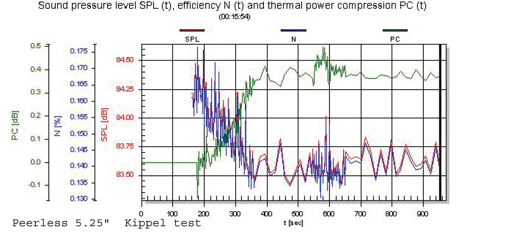

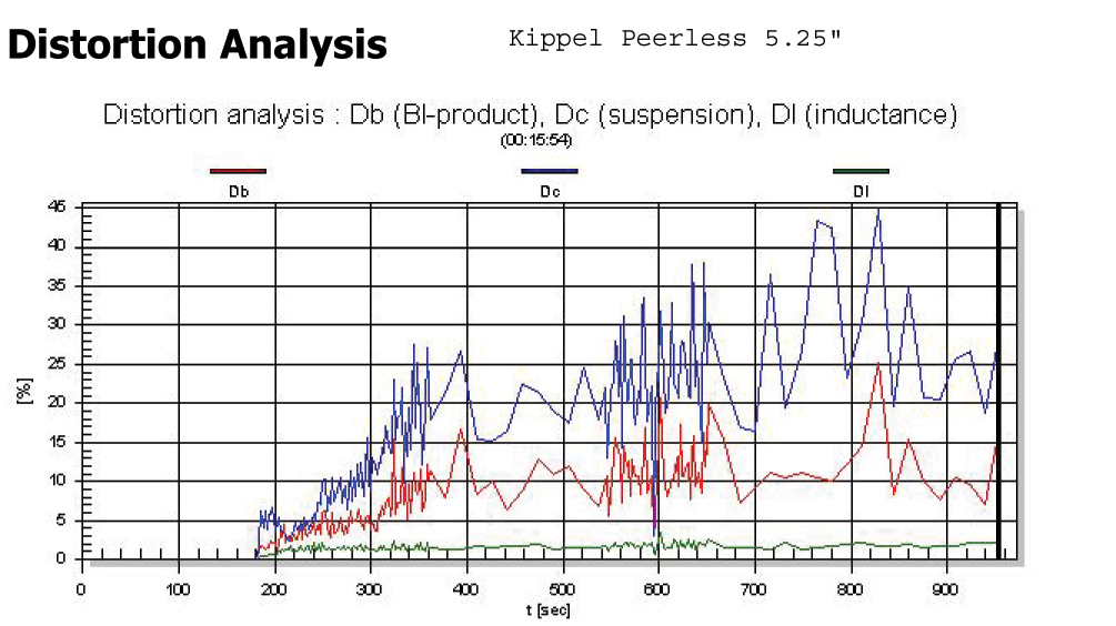

PROPOSAL FOR A TEST!
Ok.
I just got a reasonably large number of 5.25" Peerless wide range drivers...
The good part is that we have already a Kippel analysis of this driver, including harmonic distortion and freq response.
The more better-er part of it is that the Kippel analysis shows that the driver has a ragged frequency response in the (iirc) middle of its range, with corresponding ragged harmonic distortion too!
So, in short a nice driver with a documented and known flaw.
Sounds like a PERFECT candidate for EnABL to show what it can do?
I however do not own a Kippel analysis system. Anyone reading this HAVE ONE??
Although we could settle on another system and then do a before and after test(s).
I will DONATE some drivers to appropriate parties who A) have EnABL ability & B) either have analysis equipment or we arrange with a third party to do the tests.
Tests will have to be posted regardless of result, good or bad. - Probably to a separate thread.
Who wants to participate? Let's discuss...

I think the Klippel scanner might be more revealing. The LSI system is for large signal analysis.
I generally would use SoundEasy to generate CSD for this kind of test as a low cost alternative. Other systems I've tried just don't deliver the resolution of CSD necessary.

Nobody used CSD with high enough resolution is my point. I have access to Klippel equipment, and I know what it can do. Additionally, if you really want to do Klippel measurements, just EnABL them and send them to Klippel for the service.We've been thru the CSD Blink tests ad-nauseum here... I think they show nothing of value and certainly don't predict improved perceived sound quality due to enabl-ing.
John K. pretty much debunked the abuse of their usage supporting enabl to those willing to accept it
I think Randy's generous offer is a great start, if a Klippel enabled source for analysis can be located. At worst, it would show whether enabl has any technically determinable effect on BL or suspension induced anomalous behavior...
Let me put it this way. Any measurement helps you fine the problems and provides data that determine how to optimize a solution. But if you do not hear an improvement, if you don't believe it's a reasonable solution, then it's not even worth doing.
Also bear in mind that Klippel uses close mic in it's system. Most people do not place it such to reduce diffraction effects. I believe the measurements of the 5 inch driver SPL is a result of improper mic location. EnABLing will make it change, but will not solve it. To verify what I say, just place the mic 1/4 inch way from the dust cap center and see what results you get.
Well, these are all good things to say. But the bottom line is that we have a driver with some fairly obvious response issues in a highly audible part of the band. Regardless of the ultimate measurement technique(s) used either one will or will not see a clear difference.
How much does Kippel charge for a "test"? I suppose I should search for it online, but I am lazy...
I am willing to part with some drivers if there are suitable participants with appropriate abilities or facilities offered up.
Soongsc - are you saying the apparent breakup is due to mic placement?
