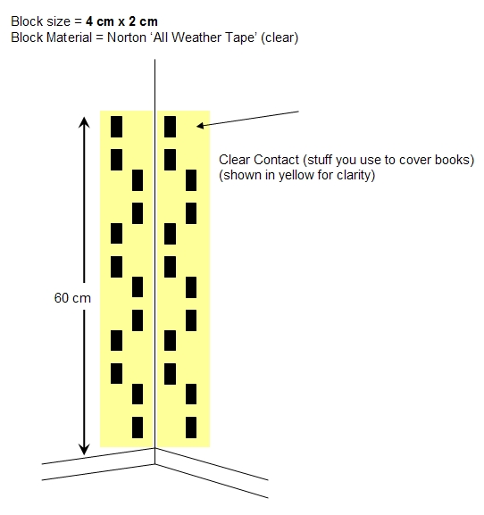

G'day,
Last night I made up some EnABL strips to treat the room corners directly behind my speakers.
Block size: 4 cm x 2 cm
Block Material: Norton 'All Weather Tape' (clear)
I stuck the blocks onto sheets of clear contact (the stuff you use to cover books).
The contact sheets have a 2 cm x 2 cm grid printed on the backing paper, so I took the lazy approach and defaulted to the 4 cm x 2 cm block size.
I only wanted to go up 60 cm because that is the height of the vintage speakers I'm currently playing with (see attached pic).
Results?
- Another level of clarity and depth in the soundstage.
- Bass is noticeably tighter and more detailed, but subjectively sounds a bit thin - however, the vintage speakers don't do really low powerful bass to begin with, so YMMV.
- diffraction off furniture that is in between the speakers has become audible.
There is a low cupboard in between the speakers that holds up the TV, amp etc. (not my choice).
I EnABLed the external edges of the cupboard using blocks made from the clear contact (2 cm x 1 cm) and stuck on individually.
This does seem to address the audible edge diffraction in the same way that it does on speaker cabinets.

Re: EnABL Room Treatments
Well it seems I'm being proved wrong about the bass with the room EnABL strips. There is much more bass than I lead you to believe.
The really odd thing with using tape for the EnABL blocks is that it seems to need a day or two to reach it's optimum performance.
I have no explanation for this, but it always plays out the same for me when I use it.

Alex from Oz said:Bass is noticeably tighter and more detailed, but subjectively sounds a bit thin - however, the vintage speakers don't do really low powerful bass to begin with...

G'day marce.
That seems a plausible explanation of why I'm hearing changes.
In my experience the noticeable change is usually in the first day or two.
G'day wlowes,
I agree with you.
The brain filters out "noise" or "information" that it cannot resolve coherently.
I suspect that the EnABL in the room corners reduces the audibility of this "noise".
EnABL on speaker cabinets seems to reduce the audibility of the cabinet somehow, yet at the same time makes the music signals much more coherent.
My suspicion is that EnABL reduces audible diffraction.
The cupboard I have between the speakers is a large solid object radiating reflected and diffracted sound.
There was no change that would alter the reflected sound from the cupboard - which leaves us with diffraction.
I suspect that the diffraction effects from the room corner masked the cupboard diffraction to some degree.
So, the effect of the cupboard wasn't as bad when only the speaker cabinets were EnABL'd.
When EnABL was applied to the room corners the diffraction from the cupboard became very obvious and annoying.
I suspect that the reason is that the EnABL pattern reduced the audibility of diffraction in the room corner and consequently made the diffraction of the cupboard clearly audible.
But then again, these "suspicions" are based on my listening impressions.
Alex
